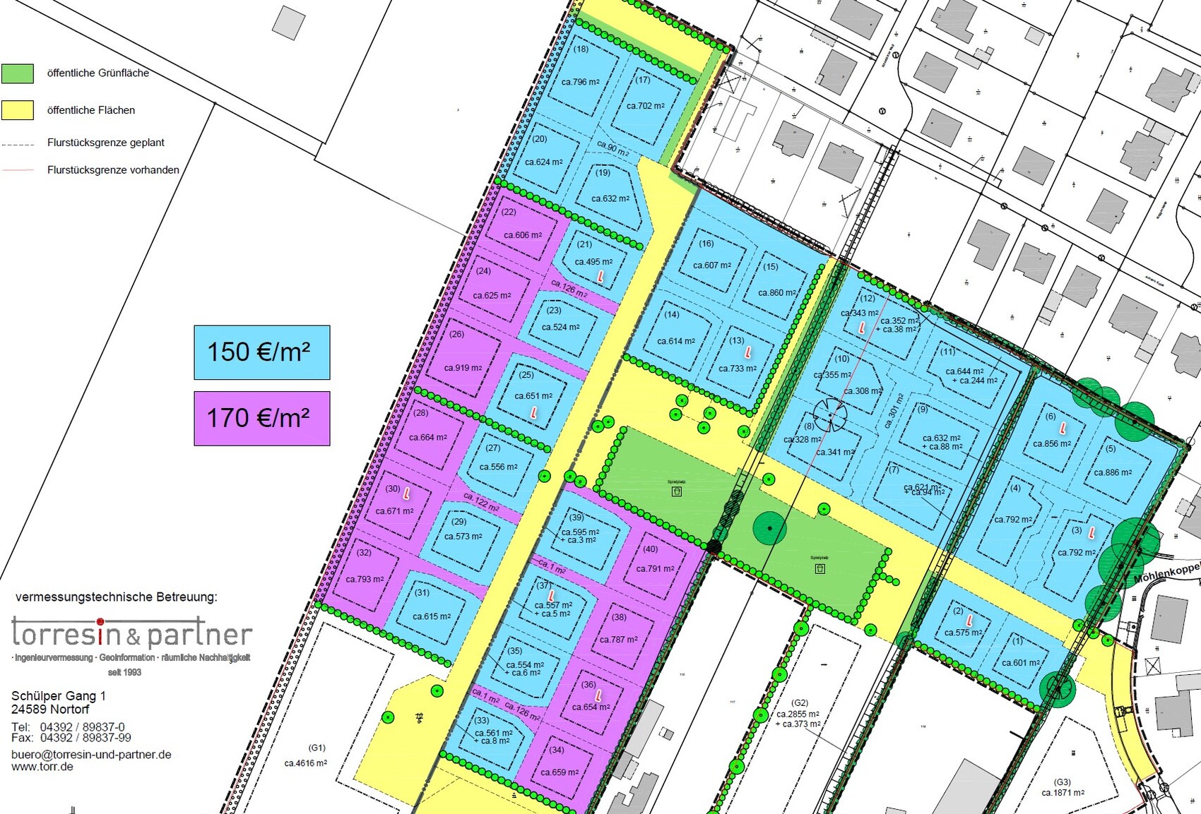

my husband and I (soon with 3 children) want to apply for a plot of land in a new residential area in the center of SH. Out of 40 plots, 30 will be allocated based on a points system, so with 3 children, we think our chances are relatively good.

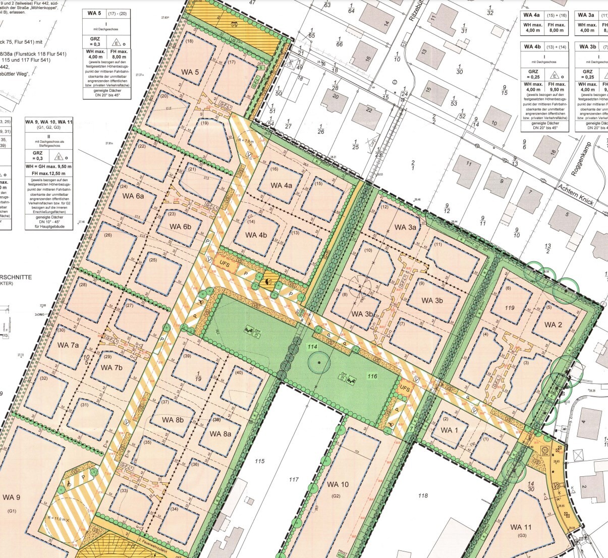

Some information about the development: The area is divided by several hedgerows, which partly belong entirely to the plots and generally may not be used, additionally with a 3m (10 feet) wide hedge protection strip. This means many plots have a significantly smaller net area than indicated. On the western edge, there is only a 3m (10 feet) wide embankment without an additional protection strip.
Furthermore, the area is divided into single-story building zones (blue) and two-story building zones (purple). These plots also differ in purchase price: 150€/m2 (150€/m2) for blue, 170€/m2 (170€/m2) for purple. There are also a few plots designed as flagpole-shaped lots. Here, the flagpole part must be purchased at the regular plot price, while other plots share a rear access driveway that is sold to neighboring residents at a very low price (25€/m2 (25€/m2), proportionally).
Our criteria for a plot are as follows:
- Preferably large, ideally over 700m2 (7500 square feet) net area, but there are only a few plots with that net size
- Not directly bordering the street (though it is a low-traffic residential street, we would prefer it quieter, especially as we have a dog and our current garden faces the street, which we want to avoid with the new house)
Additional info on the plots: Single-story homes generally allow a wall height of 4m (13 feet) and a ridge height of 8m (26 feet). So only relatively normal single-family houses with a small knee wall can be built here.
The 10 plots marked with an L will be allocated by lottery.
We are allowed to apply for 3 plots through the points-based system and for 3 plots through the lottery.
Currently, our favorites are:
- 18 (clear first choice, comparatively large, existing hedge without protection strip, meadow behind that likely won’t be built on for the next few years. Open and quiet)
- 17, 9 (unfortunately out, as acquaintances we met on site are also applying for these and have higher points)
- 26 (very large, but from the 919m2 (9900 sq ft) only about 730m2 (7850 sq ft) net remain; downside: flagpole, resulting in significantly higher costs for the plot)
- 19 (one of the larger ones, somewhat unusual shape, the house can be oriented parallel to the street with a private, secluded garden behind)
For the lottery, we chose plots 12, 13, and 25 (but we don’t expect much chance there).
Right now, we find it difficult to decide between 19 and 26. The difference in total costs including property transfer tax, development fees, etc., is around €70,000 (about $75,000). Is plot 26 worth the extra cost? It has about 100m2 (1075 sq ft) more net area and allows freer building because 2 full stories are permitted.
Which ones would be your favorites? Are we overlooking anything? Could one choice improve our chances?
Oh, and for orientation: to the south, there is a somewhat busier main road; to the north and east, quiet residential areas; to the west, meadowland.

I wouldn’t choose a plot with only single-story construction allowed if you have three children. You would need a large footprint to get properly usable rooms in the attic with a 100cm (39 inch) knee wall.
Plot 19 is very irregularly shaped, which causes additional issues. For example, I don’t see any adequate and sheltered garden space there. I can’t understand at all why you would favor this one with such a prominent front position?!
Try sketching your idea yourself,…
24, 28, 34… I hope I remembered the numbers correctly… (the legend is missing for WA 8)
EinHausfür5 schrieb:
19 (one of the larger, somewhat unusual shapes, the house can be oriented parallel to the street and then has a private garden area behind it)

EinHausfür54 Nov 2021 13:45Thank you for your feedback. Yes, you're right, the knee wall isn’t very high. We definitely want to build with a basement and are planning to include at least one dormer on the upper floor.

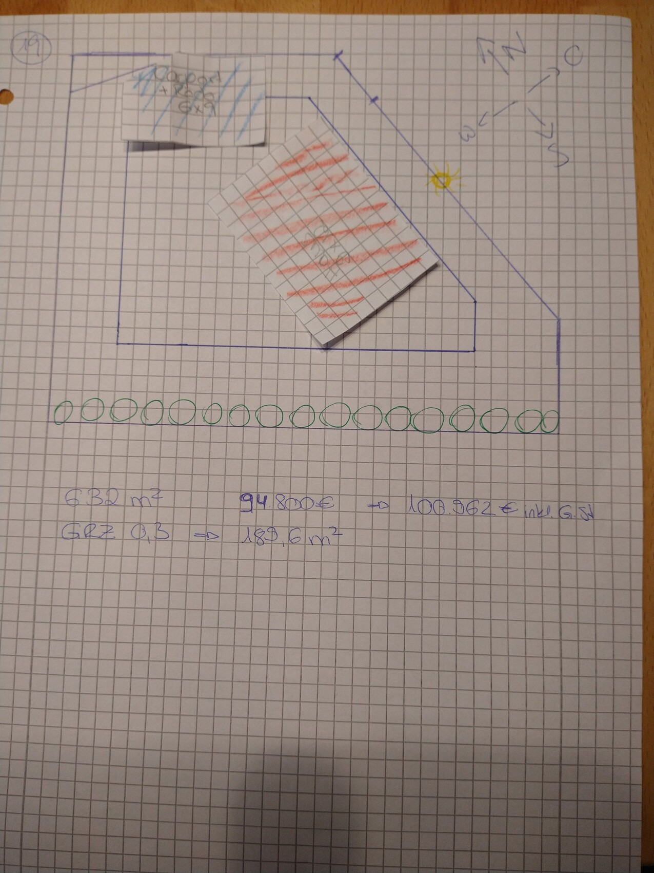

I have already marked the most interesting plots to get a rough idea of how to position the house. We initially estimated the house to be about 9x12 meters (30x40 feet), which should allow for reasonably sized children’s rooms. We currently live in a semi-detached house, and the children’s rooms here are about 10m² (108ft²). If we end up with around 14m² (150ft²), that would be more than enough for us.
Plot 19 is oddly shaped, yes, but I am hopeful that means we will have fewer competitors. I’ve attached the sketch for plot 19 – wouldn’t it roughly work like this? I actually quite like the idea: driveway in the northeast, space for a garden in the west.
For plot 24, for example, you have to subtract the strip on the west side, leaving only about 550m² (5920ft²). That’s almost too small for me...
We also considered plot 10.
We had also thought about plot 28, but plot 34 is out of the question since there’s a stormwater retention basin underneath it and then directly the noisy main road...
It’s difficult to choose just three plots.
