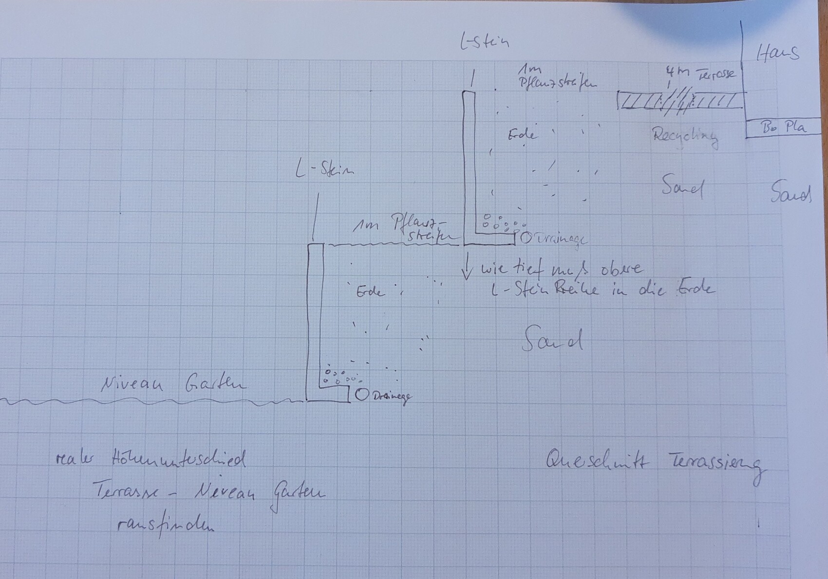

Hello dear forum members,
We need to bridge a height difference of about 1.80 - 2.00 m (6 - 6.5 feet) from the terrace down to the garden. We will measure the exact height difference in the next few days.
The plan is to build two steps using L-shaped retaining wall blocks. Starting from the house, there is a 4 m (13 feet) terrace, then a 1.00 m (3.3 feet) planting strip, followed by the first row of L-shaped blocks as a step. After that, another 1.00 m (3.3 feet) planting strip and then the second row of L-shaped blocks as the second step, which should bring us down to the garden level.
Here is an attempt at a sketch (cross-section).
Our questions:
How far below the ground level of the lower row does the top row of L-shaped blocks need to be founded? Is it sufficient if the foundation of the upper row is just below ground level?
Do you have any recommendations for reliable information sources on this topic?
If possible, after reviewing all the facts, we would like to do this ourselves, with the active support of a friend who has access to a suitably sized crane vehicle.
Thank you very much

I have indeed seen cascades from some manufacturers, but it’s unclear whether the inner row extends all the way to the bottom, starting at the same point as the outer row.

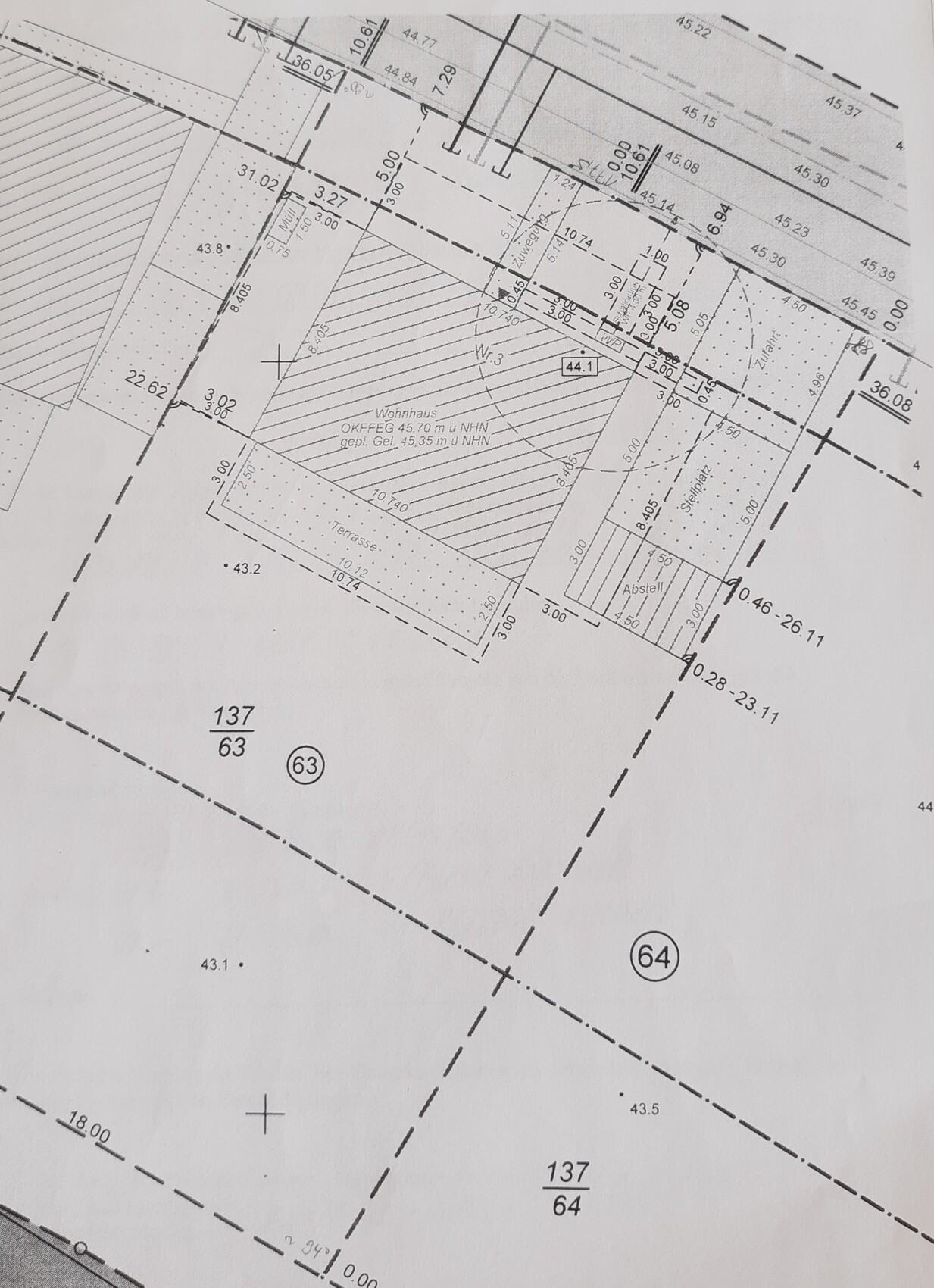

Attached is the site plan.
Ground level at the house: 45.35 m (149 ft)
Top edge of finished floor: 45.65 m (150 ft)
Top edge of finished terrace floor should be around 45.5 m (150 ft) (one step down from the terrace door)
The 43.2 m (142 ft) elevation point south of the terrace is no longer accurate, as we have filled the garden with our excavation material by about 50-80 cm (20-31 inches).
As mentioned, we will have to measure again soon.
Beneath the house and the planned terrace, the ground has been excavated and filled with compactable sand. Under the house about 100 cm (39 inches), under the planned terrace from natural level up to the current height, approximately 1.5-1.8 m (5-6 ft).
I am now looking for the soil report.
Thanks

Correction: The topsoil under the house has been replaced with 70-85 cm (28-33 inches) of fill, then additional material was added up to street level. In the south, the original elevation was 43.3 and 43.6 meters (142.0 and 143.0 feet) and raised to 45.3 meters NHN (148.6 feet). We also had sand added under the planned terrace, from the original elevation of 43.2 meters (141.7 feet) to 45.3 meters (148.6 feet).
So, almost everywhere there is at least 2 meters (6.6 feet) of sand.
