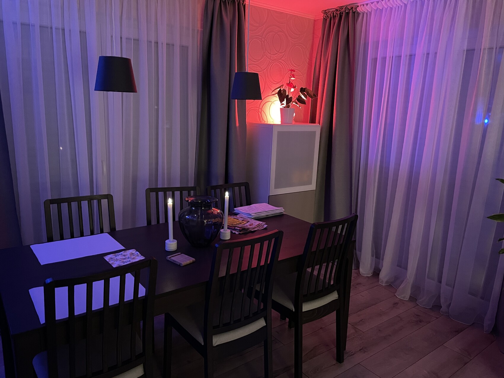

Let’s be honest: you have about 38sqm (408 sq ft) without the kitchen corner and want to place a dining table measuring 80 x 120cm (31 x 47 inches) by the window, which now causes issues with doors and access. Maybe simply consider the most obvious solution and use the table… or rather a family table… then have a patio door for passage on both the south and west sides.

Regarding the table... I was a bit surprised that the table is so small; it definitely seemed bigger to me before. I would prefer a large opening to easily bring in things like a sofa (or eventually a new large table—the old one will definitely move with us for now;) ). But fitting that will probably work better on the south side.
