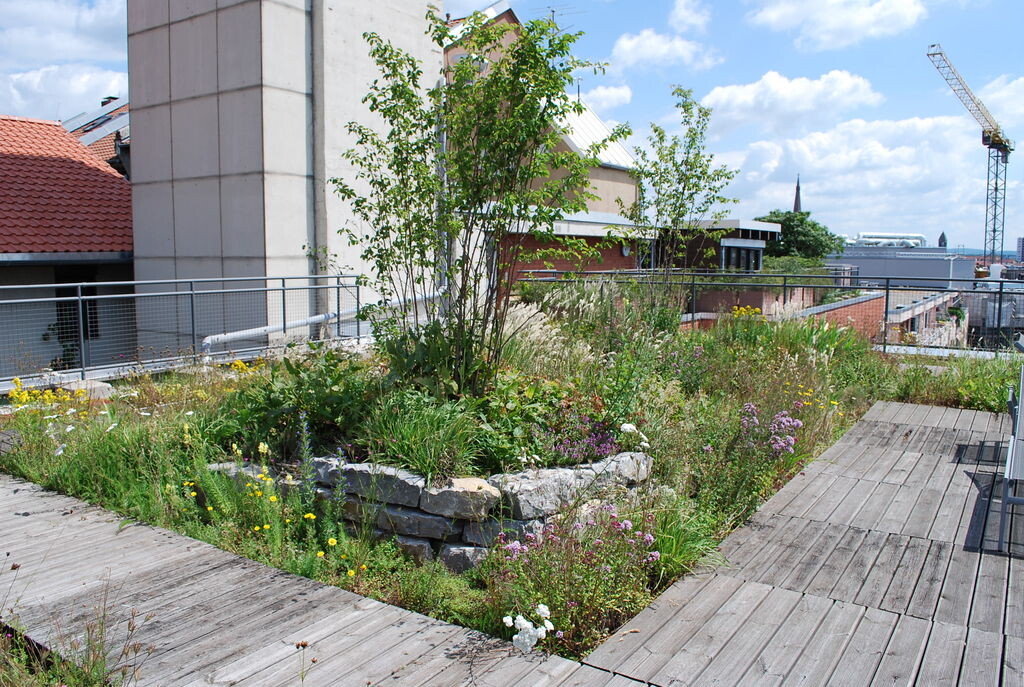

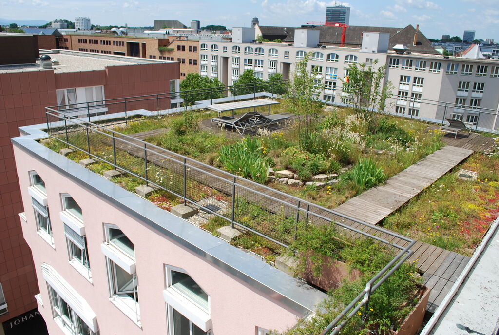

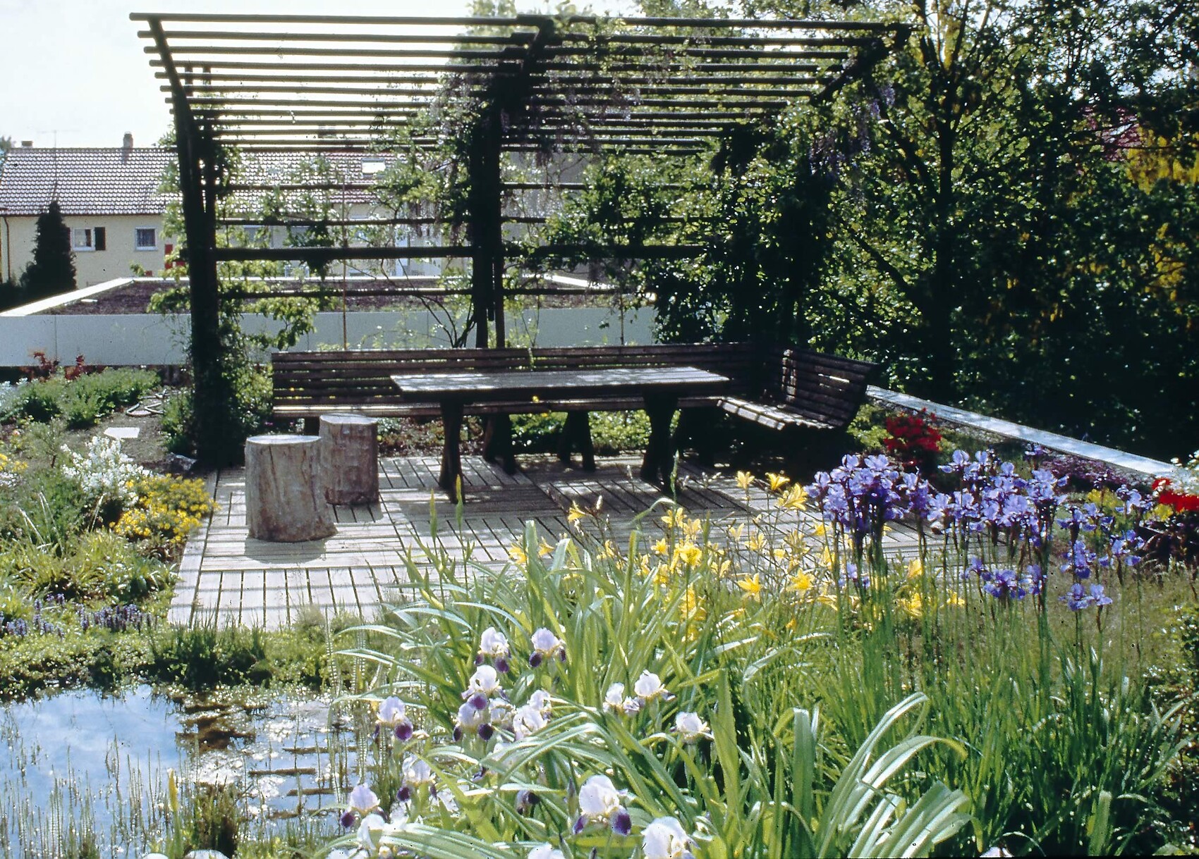

From my point of view, this rooftop terrace would just be an oversized—thus making the overall ensemble appear even smaller—bedroom balcony.I think it depends on the design. With full greenery, it could become a small additional oasis that definitely adds value. Of course, it must be allowed by building permits / planning permission and be affordable for the original poster.Mbk84 schrieb:
Since the baseline is at 410 m (1345 ft), and the height of garages is limited to 414 m (1361 ft), our understanding so far was that 4 m (13 ft) would be acceptable. I agree. I cannot see any contradiction in the zoning plan based on your extracts. Maybe the case officer at the building authority is a bit overwhelmed by the row houses.kaho674 schrieb:
I think it depends on the design. With a full green roof Like in the picture example? – there the little roof seems to be just a tiny bit larger than the entire property here, whether that still "works" at this scale?
Like in the example picture? – there the little roof seems to be just a tiny bit larger than the entire plot here; I wonder if that still "works" at this scale? There are small and large plants.
Green roofs are often encouraged by cities, as they help improve the climate.
