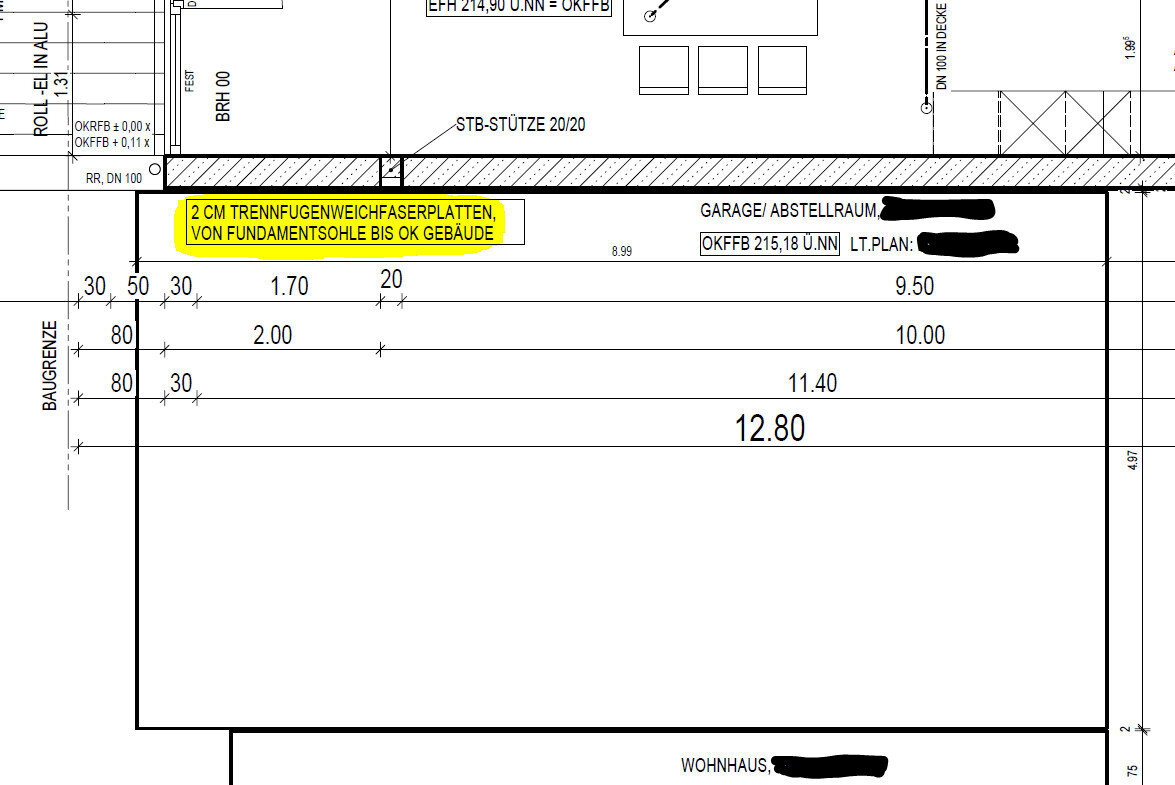

Hi everyone,
I’ve attached our plan including the execution details. In the end, there are no major special features here except for the following:
- Our 30cm (12 inches) YTONG wall was built in the usual way, and the visible part was plastered.
- Between the adjacent garage and our house, 2–4cm (1–1.5 inches) separation joints made of soft fiberboard were used.
- According to regulations, no windows are allowed, so the wall is considered a fire-rated wall.
-- Others in the street have installed windows here as well, using fire-rated windows, though I don’t know the protection class.
Regarding noise levels, I can say I don’t notice anything.
