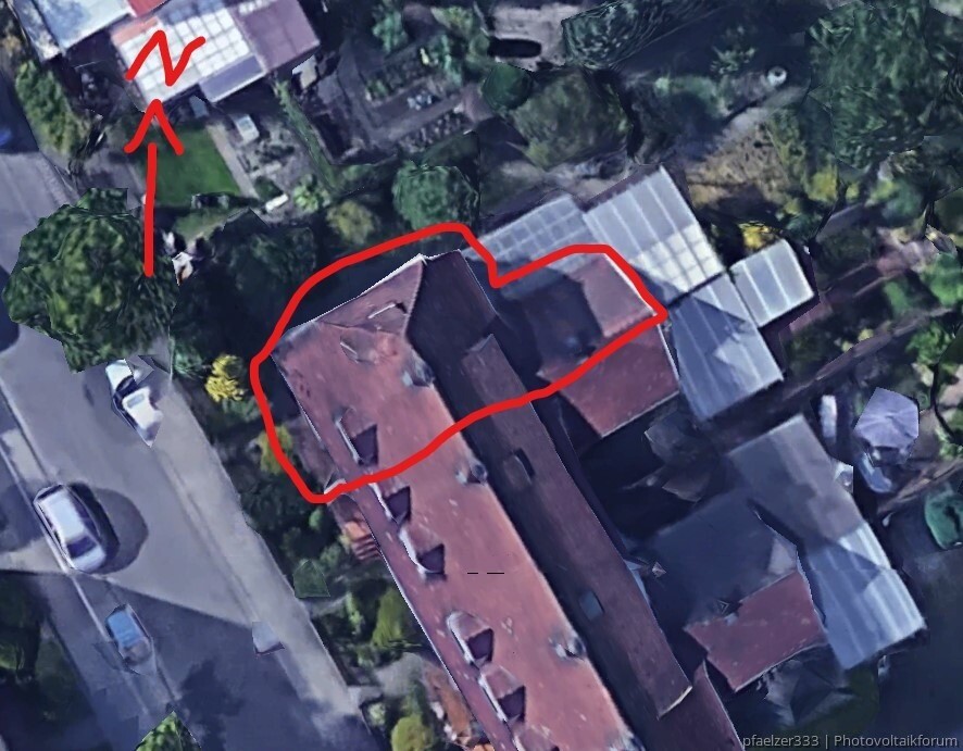

hanghaus20233 Apr 2024 08:39Then show us the house plans. The area available for the photovoltaic system is usually not that large in a terraced house.
hanghaus2023 schrieb:
Then show us the house plans. The area for the photovoltaic system on a terraced house is usually not that large. It should be close to 25–30 sqm (270–320 sq ft) on the south side.

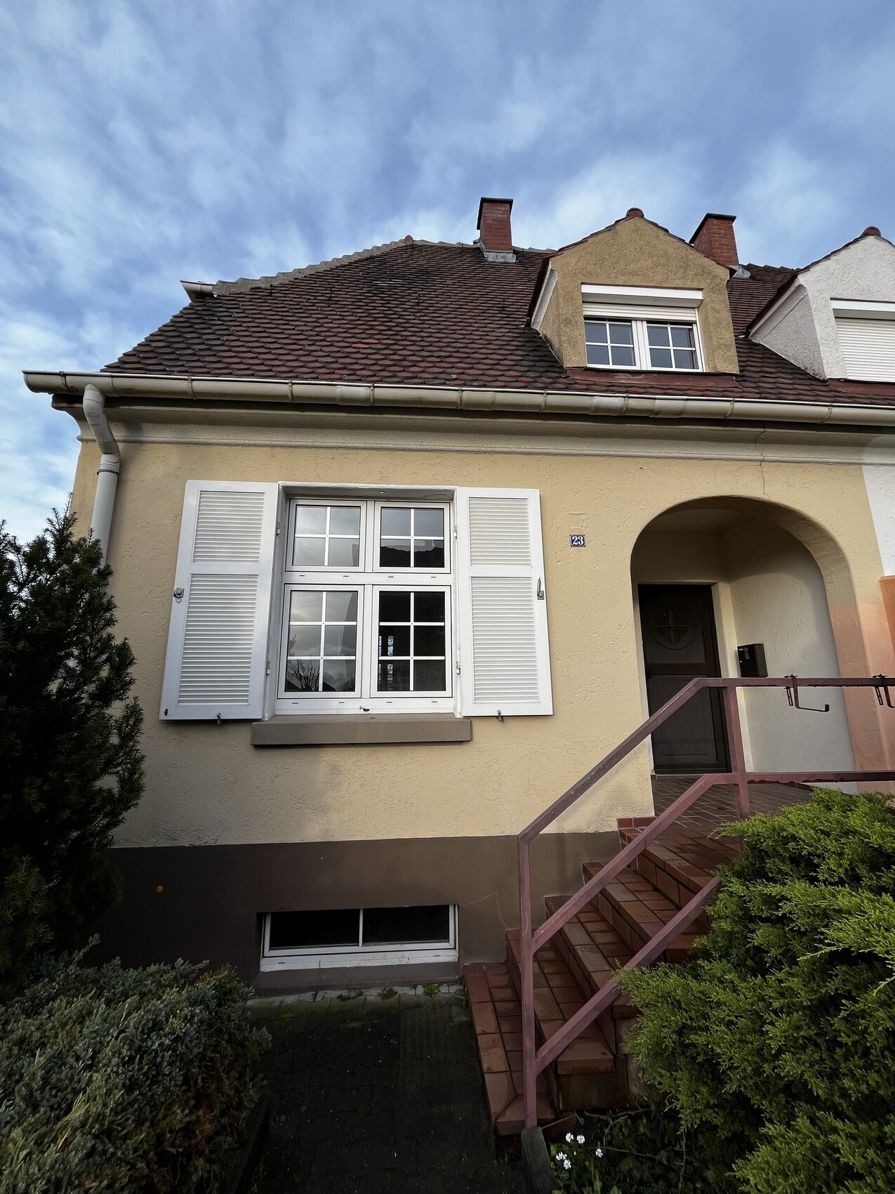

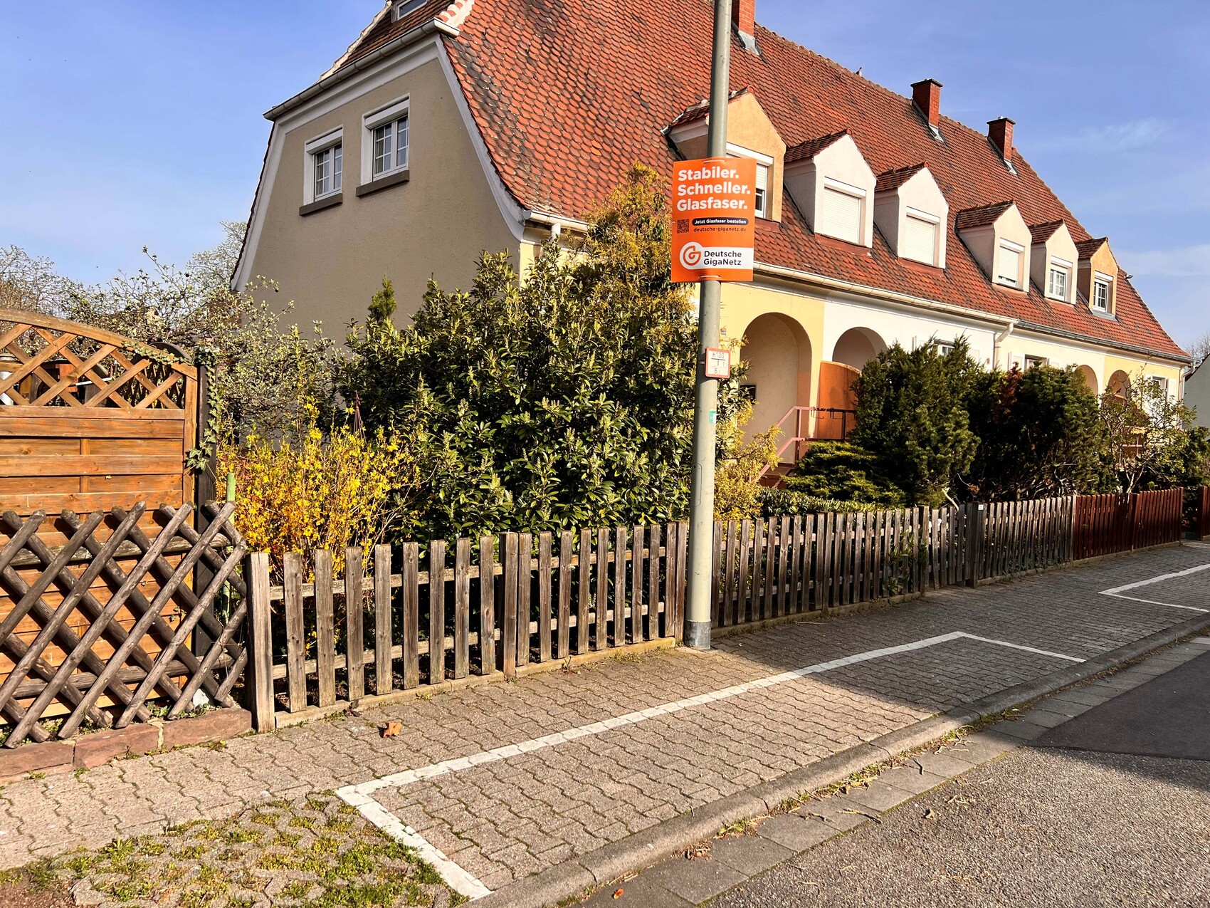

Here is an excerpt from Google Earth as well as exterior views.
