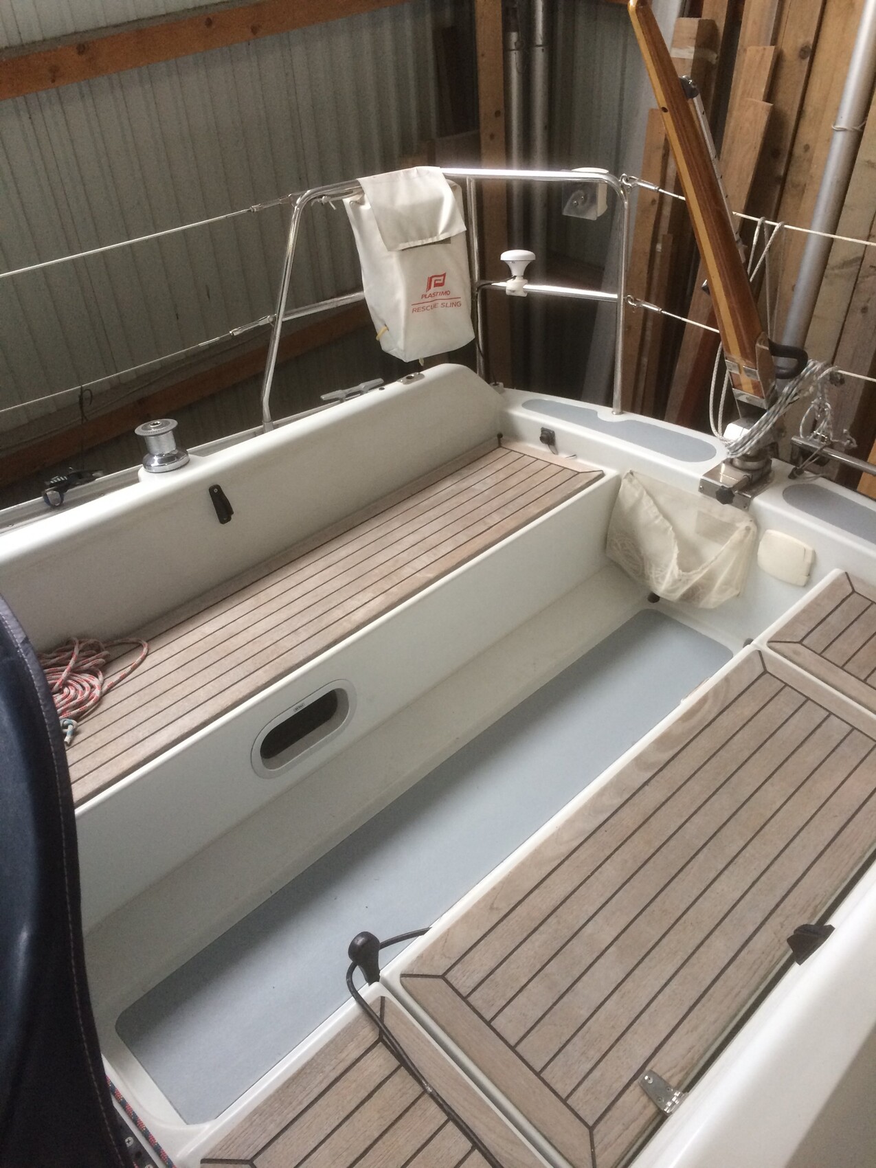

The true connoisseur, for whom the last penny does not matter, chooses Burma teak in finger-jointed decking. Note that this is unfortunately illegal rainforest timber, still unmatched, not from plantations, with natural growth rings. (On Tuesdays at half past two, he is always ironic)
Sailboat cockpit with teak decking and railing in workshop
