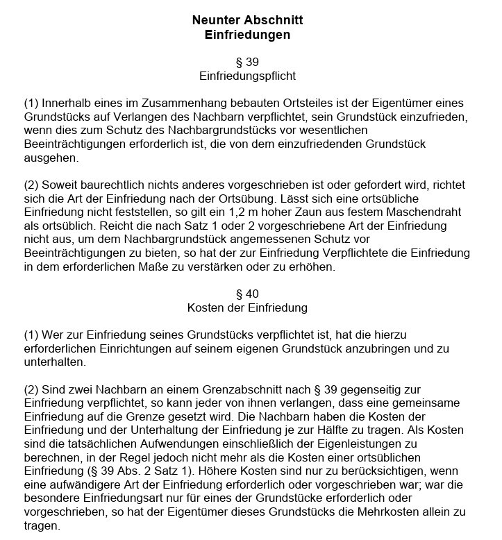

Oh, and after the wall, the neighbor wants a fence—he wants 120cm (48 inches) high, we want 180cm (71 inches). That’s why I think it’s better to separate it because the conflict won’t end otherwise. We live in an end unit of a row house, he’s in the middle, he doesn’t want to feel cramped, but we want everything tall and closed off. So I think we should mark the boundary with a simple wire fence or something similar, and he can put up whatever he wants; I don’t have to pay for it. Later, I will separate my garden with a 180cm (71 inches) fence. Yes, I will pay, but then I get what I want.

nordanney11 Jul 2025 16:19Bauherrin123 schrieb:
and if he sets up whatever he wants, I don’t have to pay for it.It’s not that simple. You still have to pay.B
Bauherrin12311 Jul 2025 16:24nordanney schrieb:
It’s not that simple. You still have to pay.I read the text but didn’t understand everything. I can also set boundaries on my side, then I thought I had agreed.
