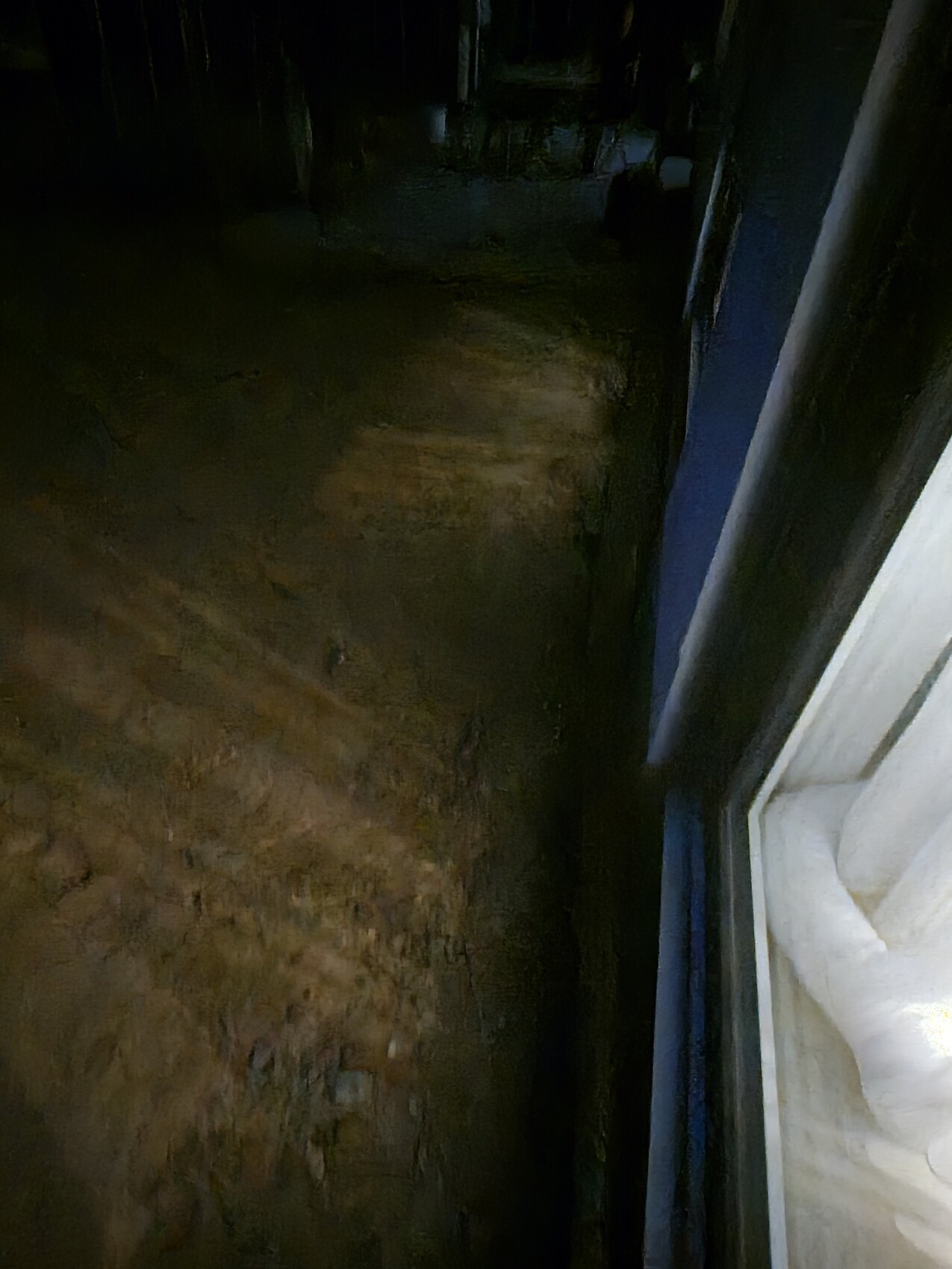

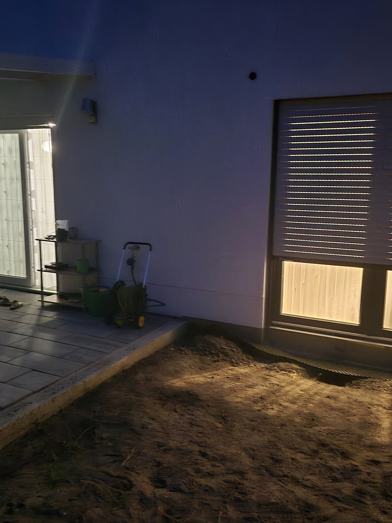

Here are some pictures.
No, we’re not just putting something up there; we involve the neighbor. He only has bad ideas, so we want to offer him a good proposal with a better idea.

Such a question with no information... always read in advance before posting a starting thread. And then have some patience.
First impressions count, after all.
About the wall:
Gerddieter schrieb:
1. That a 3m (10 feet) long, 1.80m (5 ft 11 in) high, and 20cm (8 inches) wide concrete wall in the garden is quite ugly?
No, it definitely doesn’t have to be. It’s best to separate the area at the terrace level. If you don’t like the plaster finish, you can let it be covered in climbing plants or plant a bush in front of it.
Bauherrin123 schrieb:
Is 1.80m (5 ft 11 in) enough height?
1.80m (5 ft 11 in) is probably, as is common in local building codes and neighborhood boundary rules, the maximum allowed on the property line and therefore should be sufficient!
And of course, 17.5 cm (7 inches) or a 15 cm (6 inches) thick wall is also enough.
We had something similar at two heights, so about 4.50m (15 feet) total length—about as deep as a good standard terrace. At the house, 1.60m (5 ft 3 in), then 1 meter (3 ft 3 in) towards the garden.
However, I don’t think it was anchored to the house. Anyway: it doesn’t make life and neighborly relations complicated.
We want to separate our terraces.
The neighbor has at least put some thought into it, while the slowpoke neighbors, meaning you, are now bringing up complications. Ultimately, you want this, don’t you?
So: share the wall, agree on a nice finish, and be glad the neighbor has arranged something.

Thank you very much for the answer. So the neighbor only has a 3-meter (10 feet) deep terrace, and we want to build ours 4 meters (13 feet) deep. However, the roof covering may only extend as far into the garden as theirs does, so 3 meters (10 feet). How far should the wall extend on our side, 3 or 4 meters (10 or 13 feet)? Also, we are in Rhineland-Palatinate, and according to information online, you can build up to 2 meters (6 feet 7 inches) high without a building permit / planning permission.

To me, this looks a bit like insulated concrete forms, not carefully filled by hand with concrete. Are you sure this is a foundation for a wall—meaning deep enough, properly founded, and reinforced if necessary? Or did the neighbor just support their terrace with 1-2 rows of blocks?
