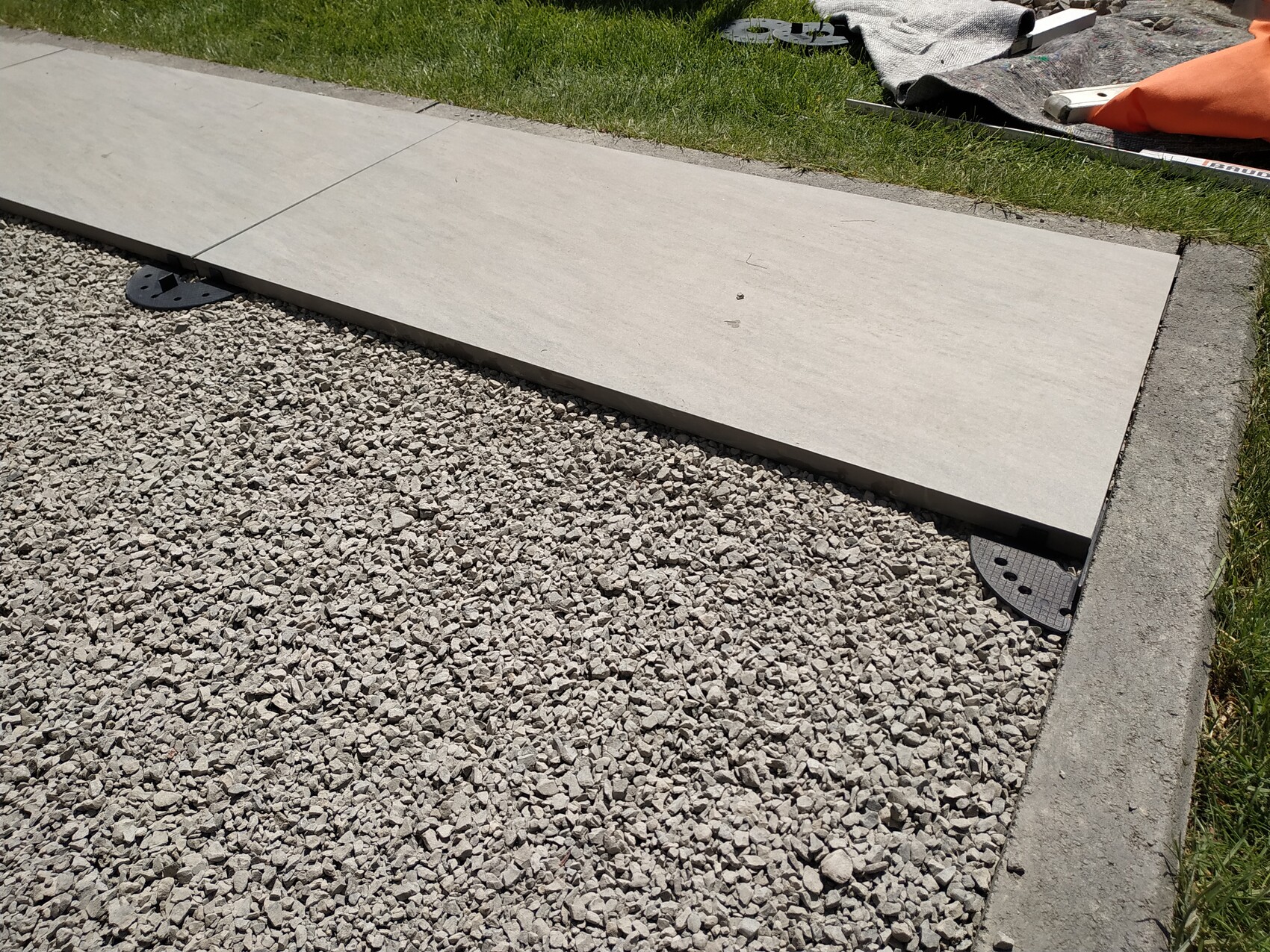

Ah, that's right! The slabs were recently reinstalled here on a crushed stone bed. The crushed stone was removed and re-compacted.
So far, so good.
Large rectangular concrete slab resting on a gravel bed, edge area and tools visible.
@rick2018
The tall pedestal supports on balconies and such are fine, but I don’t like that hollow, dull sound when you walk on them.
