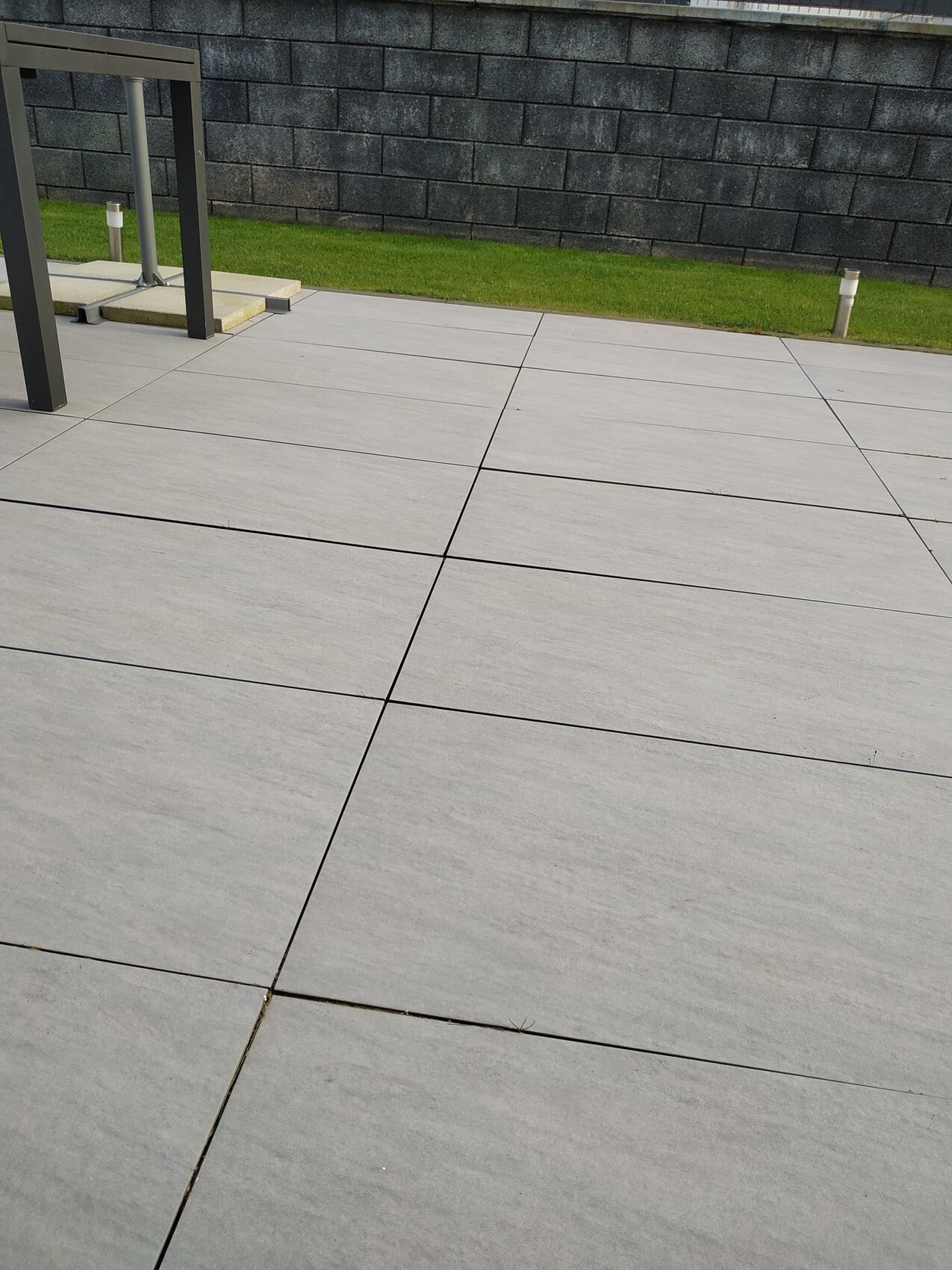

Protective mat under the pedestal supports.
There are significant differences even among pedestal supports. Those with large heads and adjustable slopes, etc., are excellent. Glue individual pedestal supports to the floor.
Currently, we have only completed the balcony and one exit. The slabs are 60 x 60 x 2 cm (24 x 24 x 0.8 inches). Very sturdy.
On the terrace, the slabs will be 120 x 60 x ? cm (47 x 24 x ? inches). We allow the rainwater to flow through and direct it into a cistern.
If a slab becomes damaged, it can be easily replaced, and retrofitting cables or pipes is simple.
