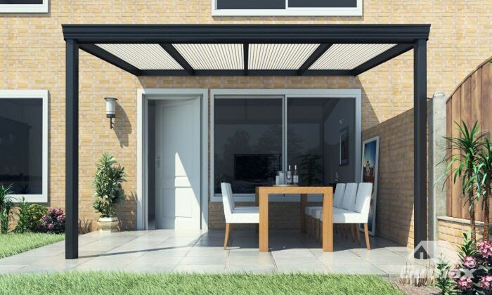

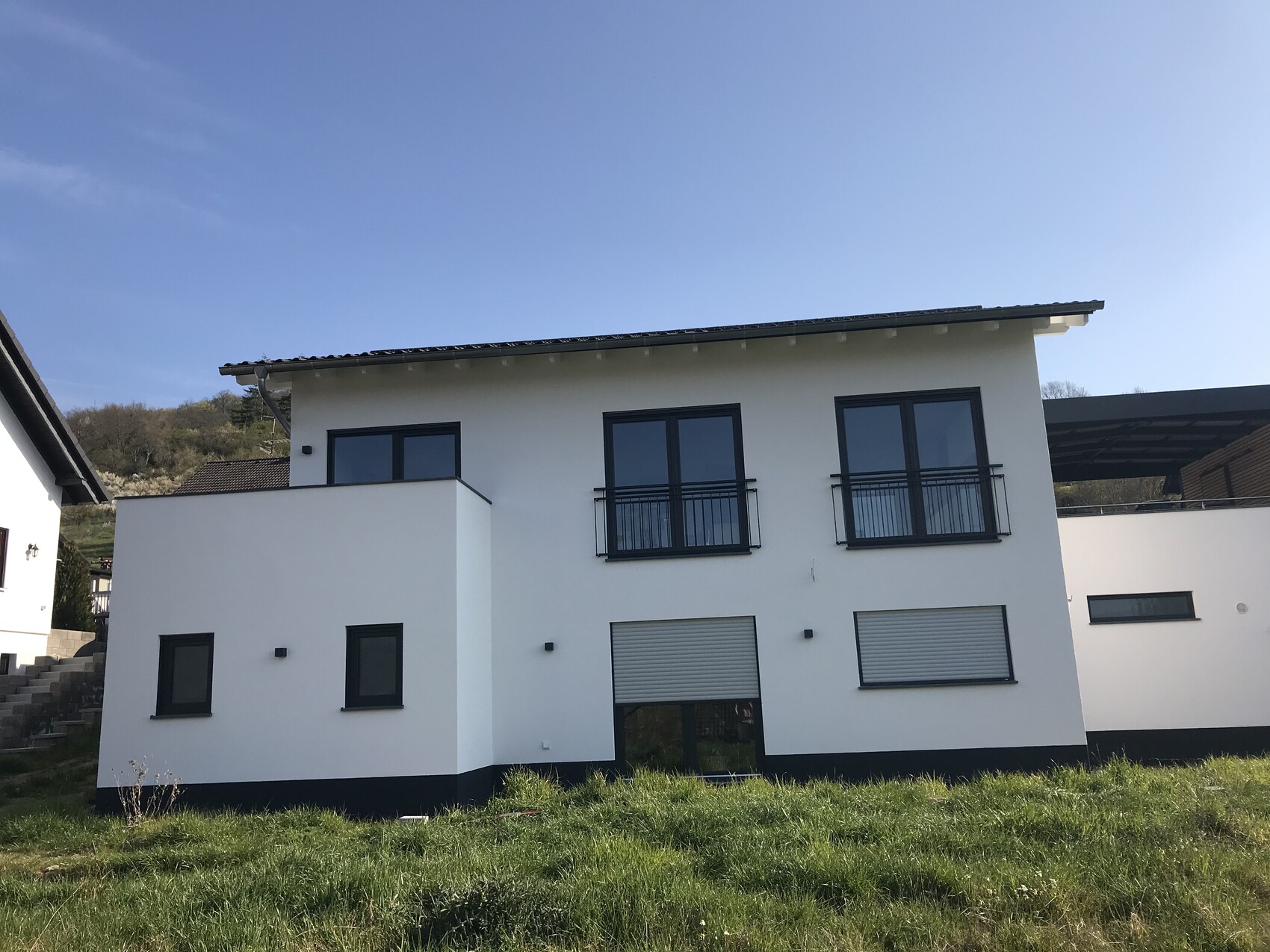

A few weeks ago, I started a thread about covering our terrace. We have now decided against a simple awning and want a fixed roof covering the entire area from the bay window to the other side of the house, about 7.60 meters (25 feet) wide and 4 meters (13 feet) deep. The terrace, which will be built in two weeks as part of the landscaping, will be the same size.
We are still unsure whether to go for a glass roof with an under-roof awning or a higher-quality polycarbonate (PC) roof, possibly without the under-roof awning. The downside of the latter option is that less light passes through and it could be noisy in the rain due to the hollow chamber design. The advantage is a significant cost saving compared to glass.
We are also wondering: when looking out from the dining room through the central floor-to-ceiling window (see picture), will we see an unattractive yellow-green roof at some point if we choose the PC? Has anyone had experience with this? The second picture shows the kind of look we would like for the roof covering, with a side wedge window on the right because a larch privacy screen will be installed underneath on the side.
Do you have any advice or tips?
Thanks!
Thanks!
