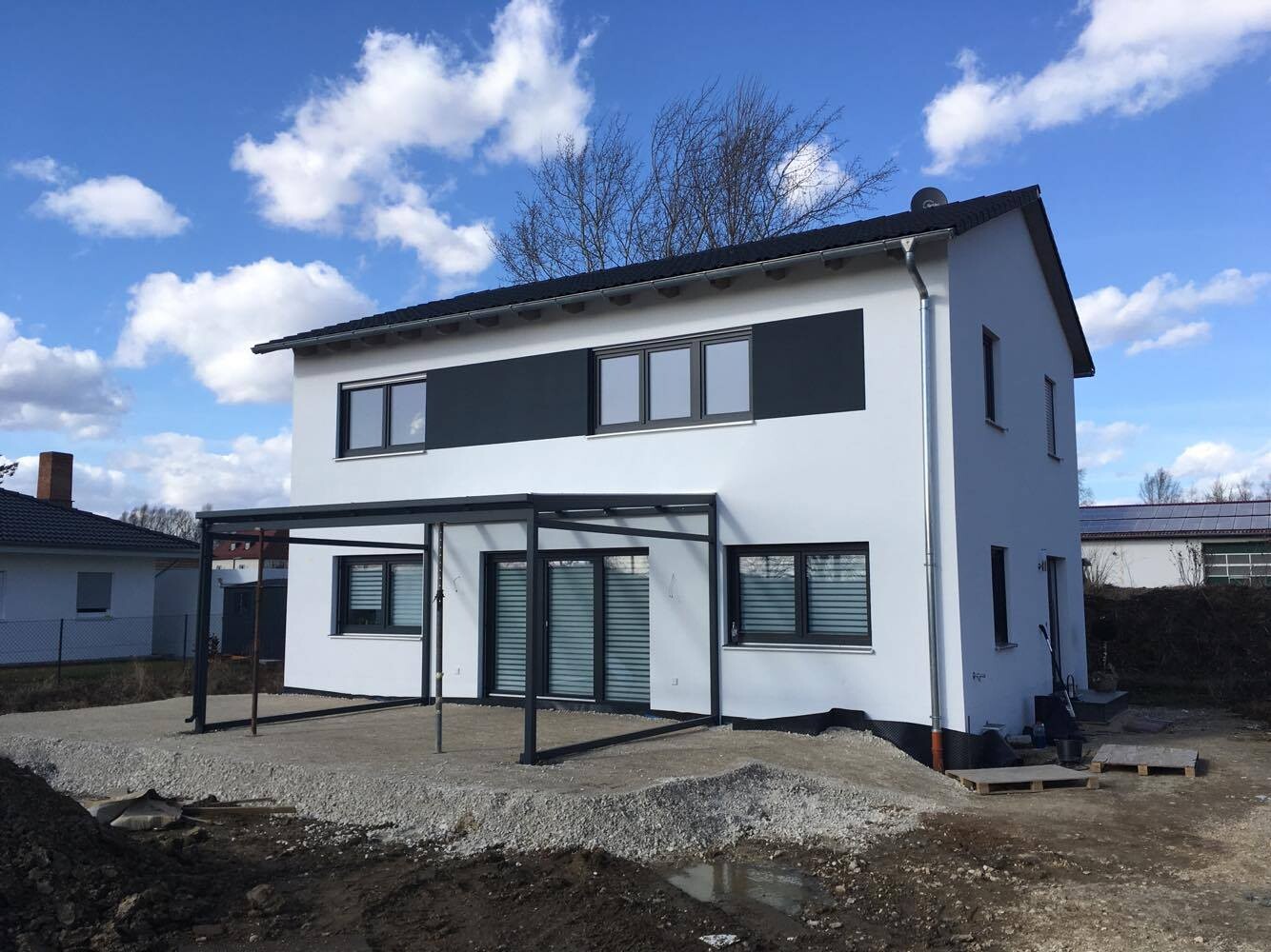

daniels872 Mar 2017 15:03This is not a conservatory but a patio roof with sliding glass doors. It is not airtight, so gas is not a major concern. Gas is also used in tents and workshops. Carbon monoxide rises upwards, and the roof structure still has openings at the front of about 8cm (3 inches), so accumulation is unlikely. However, I would only use it with a carbon monoxide detector anyway.
The advantage compared to a conservatory is that all the sliding walls can be stacked together, making the roof structure almost completely open in summer (about 75%).
The roof was completed today; the sliding walls and side wedges will be installed in two weeks.
GoodCompany2 Mar 2017 16:17Aluminum does not rot. Glass doesn’t either. So it probably has a long lifespan. These are important points, I agree with you. I generally have a high opinion of aluminum too!
Relatives of mine have a patio roof made of wood and glass. I actually like the look quite a bit, but after nearly 20 years you can definitely see that it’s not new anymore. Wood can age better or worse, depending on the type.

daniels872 Mar 2017 20:44The frosted glass is correct. However, we want an unobstructed view.
The cold conservatory costs us about €12,000 including installation.
For the floor, terrace slabs are planned.
