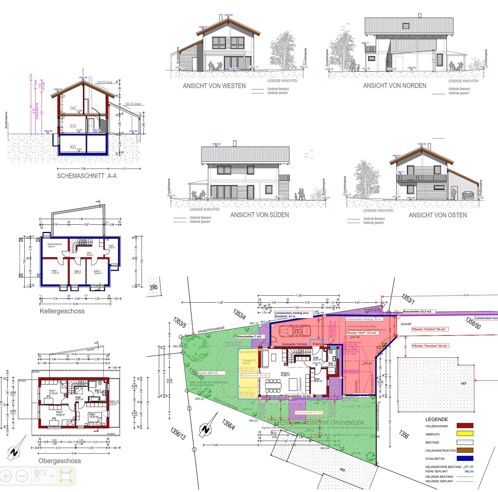

- We planned to build a patio roof 7m (23 feet) wide, but then realized that the setback requirements also apply to the patio roof.
- According to the Bavarian Building Code (BayBO), the patio roof must be at least 3m (10 feet) away from every neighbor’s boundary (I tried to illustrate this in the screenshot).

We have a 4m (13 feet) depth here, and it actually wasn’t more expensive, but we’re in zone 2, as far as I can see. In our case, they used rather narrow but taller rafters. I would find it a bit too much if that went along the entire side of the house, because then you wouldn’t really see the house at all. It might be helpful to sketch or visualize where and how posts would be positioned or need to be placed. If you upload the whole plan, which is always useful anyway, it’s easier to imagine something like that.

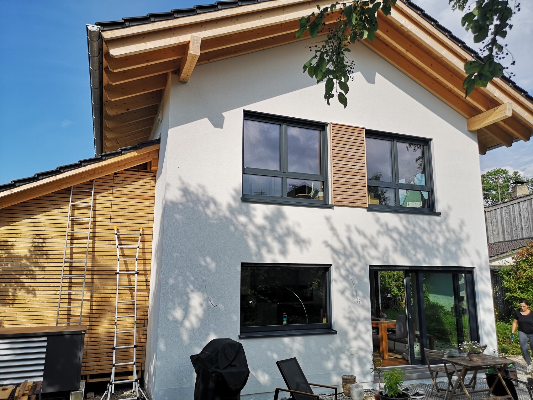

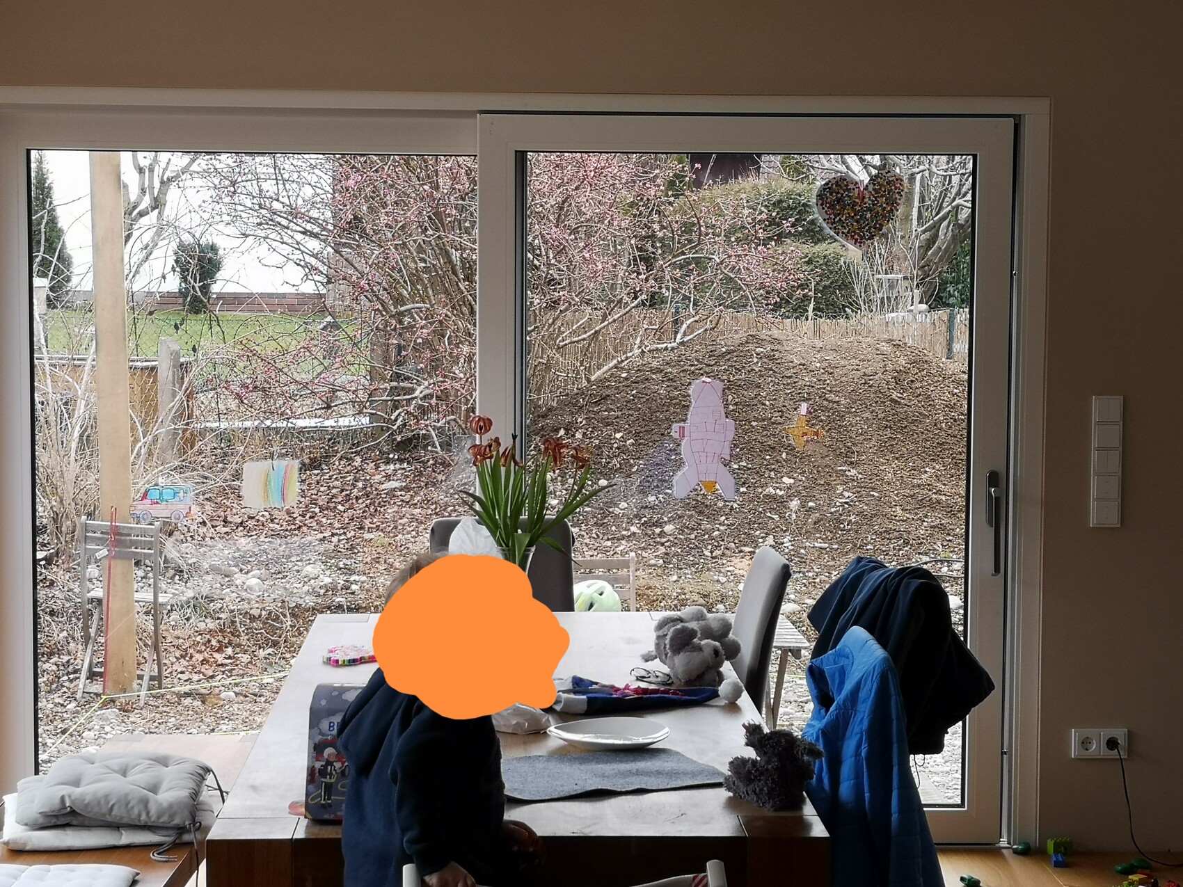

We actually tried to visualize the position of the post using a board. I’ve attached a photo from both the interior and exterior views. I’ve also attached the entire design plan. You can even see the post on the top view of the west side, exactly 3m (10 feet) from the property line. But it ends up right in the middle of the sliding door, and it’s directly in the line of sight from inside looking out to the garden. That’s what’s causing us some concern.

Steffi33
9 Apr 2025 13:20
Our experience: From our three windows facing the terrace, we look out onto four such concrete columns. This has never bothered us. PS: We also do not have a transparent roof covering… (depth 4m (13 feet))… and have never regretted it!
