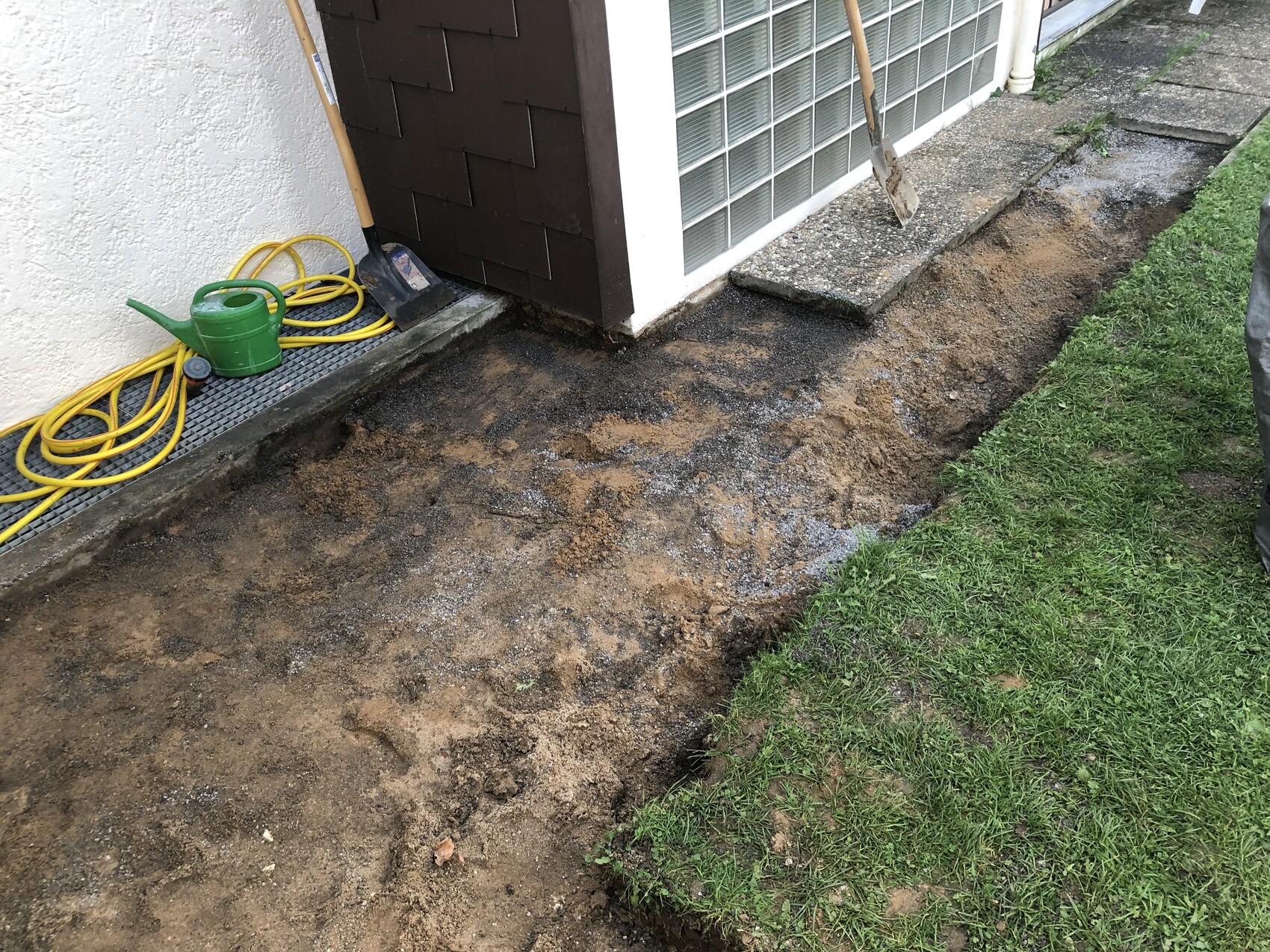

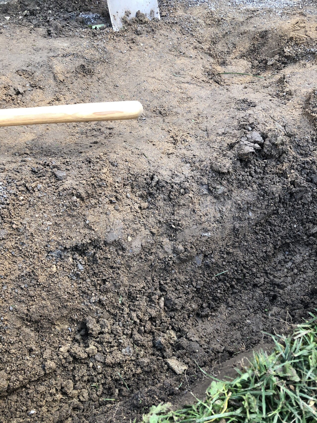

11 Oct 2022 17:24
I have now started removing the old slabs and found beneath them a layer of about 30cm (12 inches) of sand (little to no fine material) mixed with gravel, as well as a layer of about 3m (10 feet) of gravel.
You can see the sand-gravel mixture in the pictures:
Trench next to house wall: excavated earth pit with sand, shovel, garden hose and watering can.
Freshly dug soil with wooden shovel handle, grass at edge.
Apparently, there is no dedicated frost protection or base layer.
I am working in the path area, not the terrace.
How would you proceed? Is it necessary to excavate everything and re-install from scratch?
deezey
11 Oct 2022 22:10
schlukkl schrieb:
I have now started removing the old slabs and found beneath them a layer of about 30cm (12 inches) of sand (with little to no fine particles) mixed with gravel, as well as a roughly 3m (10 feet) layer of gravel.
You can see the sand-gravel mix in the pictures:
[ATTACH alt="terrassenplanung-mit-umlaufendem-weg-und-leichtem-gefaelle-599938-2.jpg"]75501[/ATTACH][ATTACH alt="terrassenplanung-mit-umlaufendem-weg-und-leichtem-gefaelle-599938-1.jpg"]75500[/ATTACH]
I am referring to the area of the path, not the terrace.
How would you proceed? Is it necessary to excavate everything and rebuild?
Yes, I think that would be the best approach here. Excavating and installing a new, clean base layer.
Since you are already undertaking the effort.
