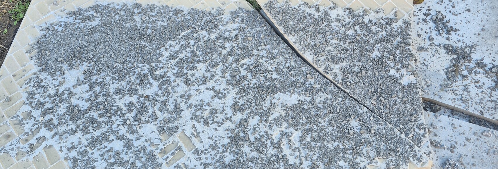

Bauherrin12322 Nov 2025 09:15N
nordanney22 Nov 2025 09:24You are showing a picture of a broken panel. There is nothing to say about that.

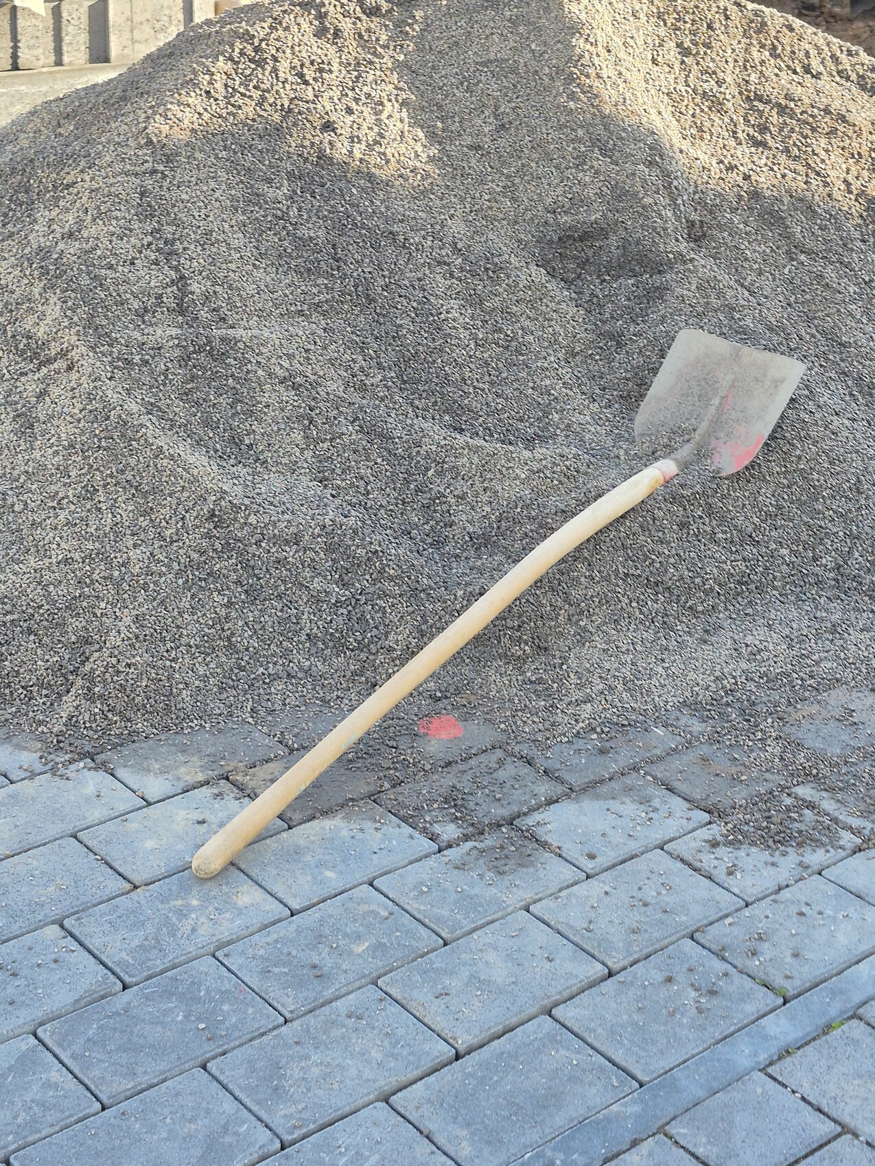

Bauherrin12322 Nov 2025 10:15Okay, I’ll explain more clearly what I meant. They installed 10m2 (108 sq ft) before I called a work stop because, in my opinion, the weather was too cold. He mixed the drainage mortar too dry, just shoveling gravel and cement together and then adding water while mixing. Then he applied too little adhesive to the tile and didn’t cover the edges. He said this was better to prevent overflow. Right after laying the tiles, he lightly sprayed water on them with a hose. I was suspicious and lifted a tile the next day, which came up easily. It broke in a different way. Can you assess from the back of the tile if everything is okay?
nordanney22 Nov 2025 10:34Short answer: it looks awful
Please show a picture of the concrete and adhesive

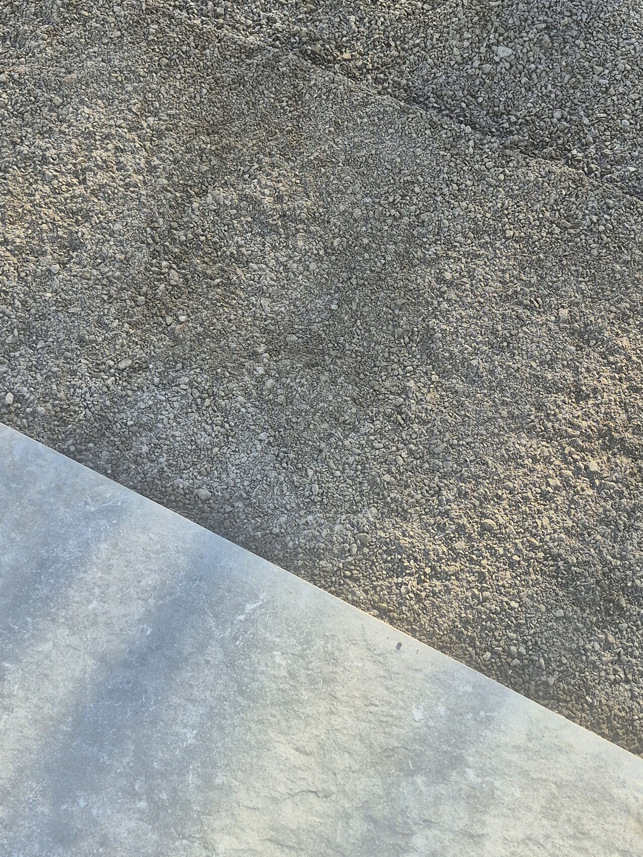

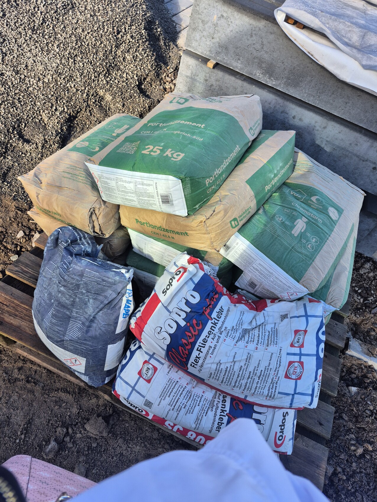

Bauherrin12322 Nov 2025 11:12N
nordanney22 Nov 2025 11:22The craftsman should have used adhesive as well. LOL
Actually, tiles are firmly set in adhesive and not just placed on the material underneath.
