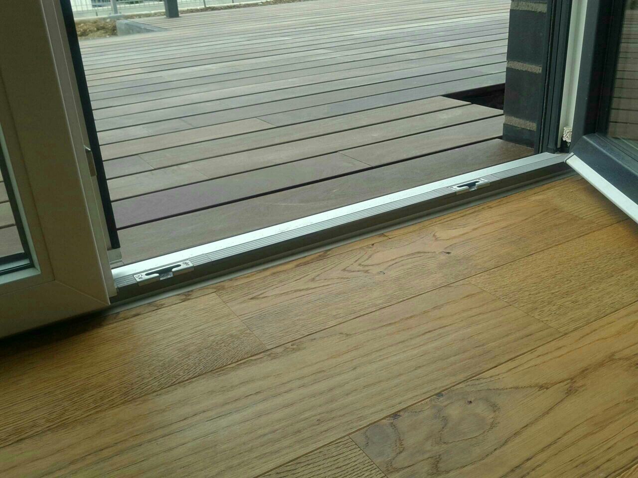

In our house, we have a double-wing patio door in the living room and a single-wing door in the kitchen. Now we have to decide between a standard threshold (about 8cm (3 inches)) and a low threshold (about 2cm (0.8 inches)). The lower threshold would come with an additional cost.
It seems that the higher threshold is more common among members here. I wanted to ask if anyone has a low threshold and how their experience with it has been.

One of our neighbors has a low threshold: a wheelchair user.
It is certainly more convenient and also looks better, but the additional cost .....

The additional cost is about 500 euros. Compared to the total amount spent on a house, it’s not much. But every little bit counts...
However, if I end up appreciating the low threshold every day, then the extra cost is definitely worth it to me.
Fortunately, the reason has nothing to do with accessibility.
A few days ago, I discussed this topic with a friend who is a carpenter and will also be installing the windows and doors. He said that a low threshold can actually be more of a tripping hazard than a standard one. You'll definitely have to lift your foot higher...
