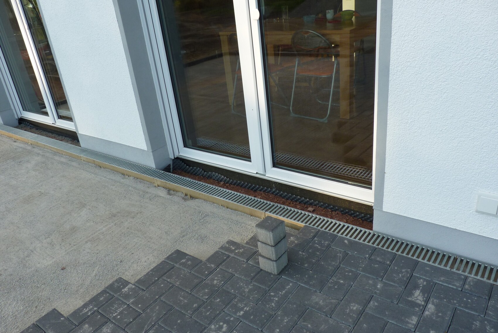

Bieber081526 Apr 2017 21:09Interesting! It was the same here at first. The construction manager from the developer didn’t inform the civil engineer that we would have a drainage channel, and no planning documents were prepared. That’s why the civil engineer built the substructure without the channel and then improvised it afterward using the path of least resistance.
We were shocked but could not prove an actual defect. After some concerns, we arranged for the channel to be rebuilt into the reveal at our own expense.
It has been watertight for about 11 months now despite being exposed on the weather side. By the way, all involved experts agreed that the channel was unnecessary. I overruled them – the customer is always right and pays for it.
Are your doors properly adjusted? Have you experienced worse weather conditions than we have so far this year? Or does it actually matter where the drainage channel is placed? You have about 15cm (6 inches) of flat surface in front of the channel where water can accumulate.

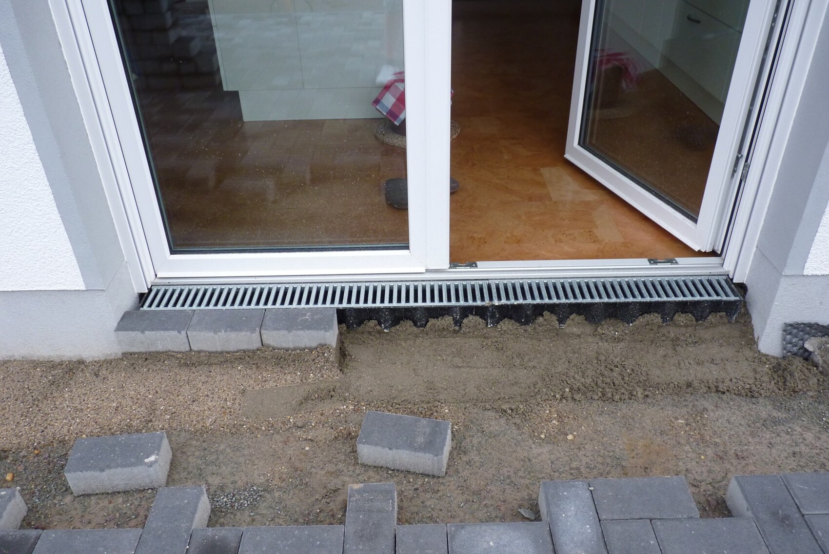

toxicmolotof26 Apr 2017 22:20We don’t have an eave, and the wind did its part. I can live with it once every two years. About 30km (18.6 miles) away, car windows were broken. So that was really severe weather.
