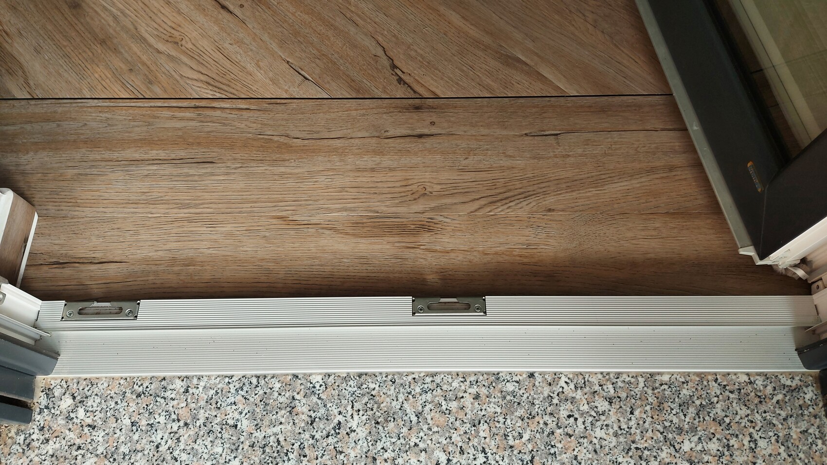

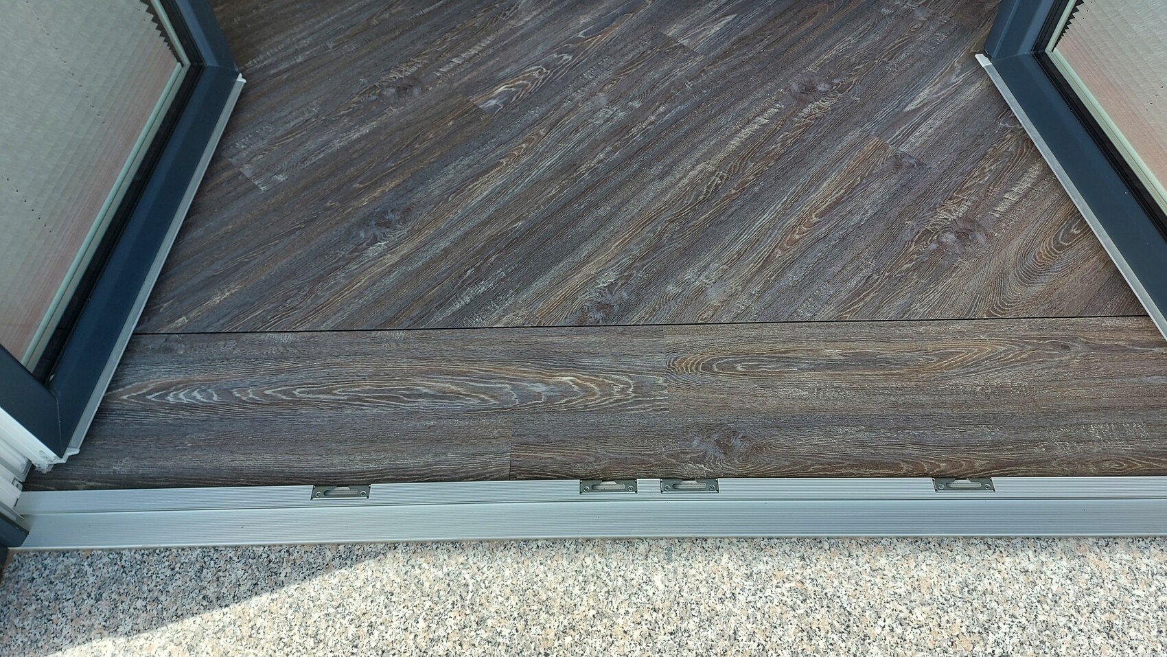

Dark wood laminate floor in front of door threshold
Metal door threshold separating wood floor above from granite floor below.
