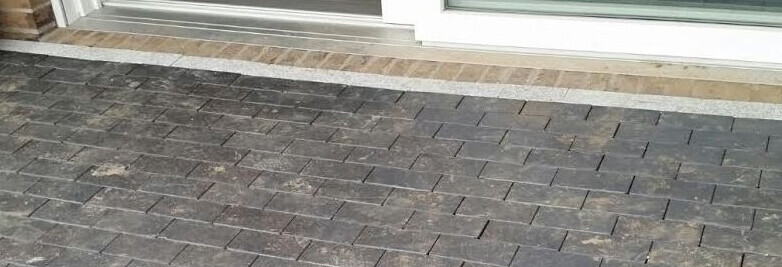

So... the paving at our place is almost finished. The terrace is paved almost level with the threshold of the sliding patio door (in the meantime, the row of granite stones has also been replaced with bricks).
This area has never been wet, since it is covered by about 2 meters (6.6 feet) of roof and is not on the weather-exposed side (fully protected on the east side and on the west side about 8 meters (26 feet) away from open exposure) – so I’m not too worried here (although of course this probably doesn’t comply with DIN standards).
However, the corner of the house is exposed to rain – but there are no openings there leading inside, just paving at a rather high level.
