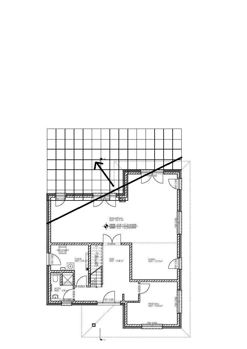

Maybe you could include this in the drawing as well? I would interpret it this way
icandoit schrieb:
or an imaginary line from the axis of the double window on the left to the axis of the double window on the right. From this axis, the slope goes up to the left and down to the right.
icandoit schrieb:
or an imaginary line from the axis of the double window on the left to the axis of the double window on the right. From this axis, the slope goes upward to the left and downward to the right.Something like this?

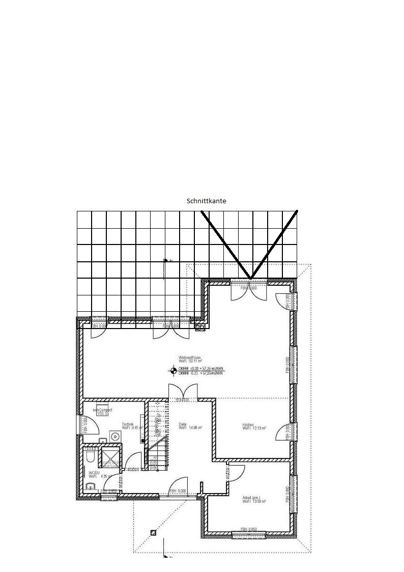

Forget the first option—no one wants the cut edge right in the middle of the terrace.
The second option looks better. The downside is that the narrow door would have a small step.
How do you plan to cover the terrace?
