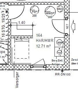

I also think 2m (6.6 feet) is too narrow. We have 3.40 x 3.80m (11.15 x 12.47 feet, 12.92 sqm / 139.1 sqft or 12.71 sqm / 136.8 sqft due to an extra wall for better division) and find that to be a good size to a) move around comfortably and b) have some space for storage.
Attached is the floor plan of our utility room:
Depending on what needs to fit inside, it becomes too narrow.
Ours is 2.50m (8 feet 2 inches) and it’s already very tight inside. However, there is a 300-liter (79 gallons) water tank positioned in the center on the left side. The door to the dryer opposite can still open; with 2m (6 feet 7 inches), that wouldn’t be possible.
Just consider this... 3 washing machines are about 2m (6 feet 7 inches) wide. With one on the left and one on the right, you have around 70cm (28 inches) in the middle to walk through. That’s tight.
