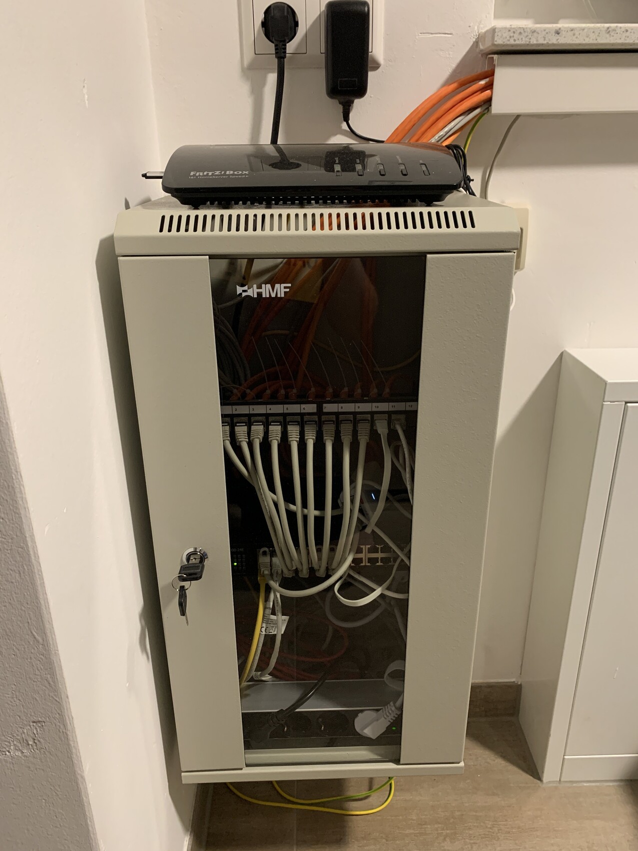

Andre77 schrieb:
Here is a fairly “compact” version. 10-inch cabinet. With a 23mm (0.9 inch) PoE switch for the existing Ubiquiti access point in the attic. The Ubiquiti access point has really excellent reviews! I think I will take a closer look at it myself.
