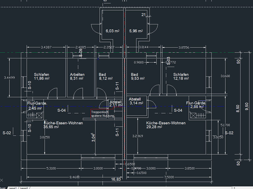

pagoni2020
6 Jul 2020 22:41
superzapp schrieb:
we faced the same problem. As a solution, we planned a somewhat unconventional idea (not yet implemented but approved by the building authority).
An external technical building (our size is about 2.5 x 6–8m (8 ft 2 in x 20–26 ft)). If possible, very close to the main building. A basement would have been too expensive, and an attic too noisy :-(
Controlled residential ventilation is, of course, still located in a small utility room inside the house (e.g., PluggIt systems).
Boundary wall construction is possible if there is no fire hazard (i.e., no gas/oil).
Oh, and one more thing: No technician enjoys installing equipment under such conditions. My brother-in-law (a trained plumber, now a building services planner) says everyone would swear loudly, especially with an emergency staircase.
Would you have some information about this external technical building? This is something we are currently considering to avoid a small building extension. What are the minimum requirements for such a room in terms of frost protection, proximity to the house, etc.?
In the attic, we would have about 150cm (5 ft) height plus a pull-down staircase. I can already hear the installer grumbling. Or it simply wouldn’t work.
knalltüte
7 Jul 2020 09:56
Hi,
our utility room is now directly adjacent to the house
(the original plan had a 1.5m (5 feet) distance from the house).
The wall will, of course, be insulated, but significantly less than the rest of the house. The wall thickness is a total of 21cm (8 inches). It will be built as a timber frame construction with mineral wool insulation and plaster
(the north wall will have brick cladding as it borders a footpath and bike path).
I believe the regulations for water and electrical connections require them to be frost-proof.
This could possibly be done more simply if necessary.
Zweistöckiges Haus mit Satteldach und seitigem Anbau, graue Fassade, schwarzes Dach, gelbe Akzente
Grundriss eines Doppelhauses mit zwei Wohneinheiten: Küche, Essen, Wohnen, Schlafräume.
