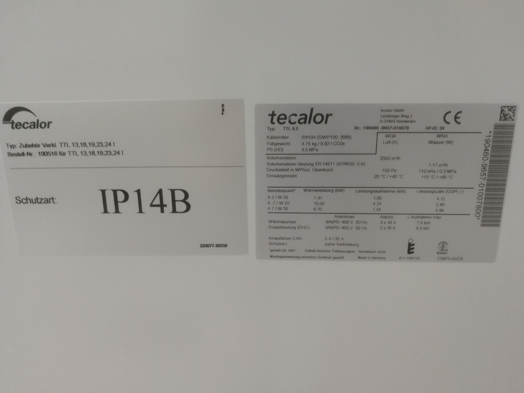

I’ve taken some additional pictures of my settings and nameplates for better analysis.

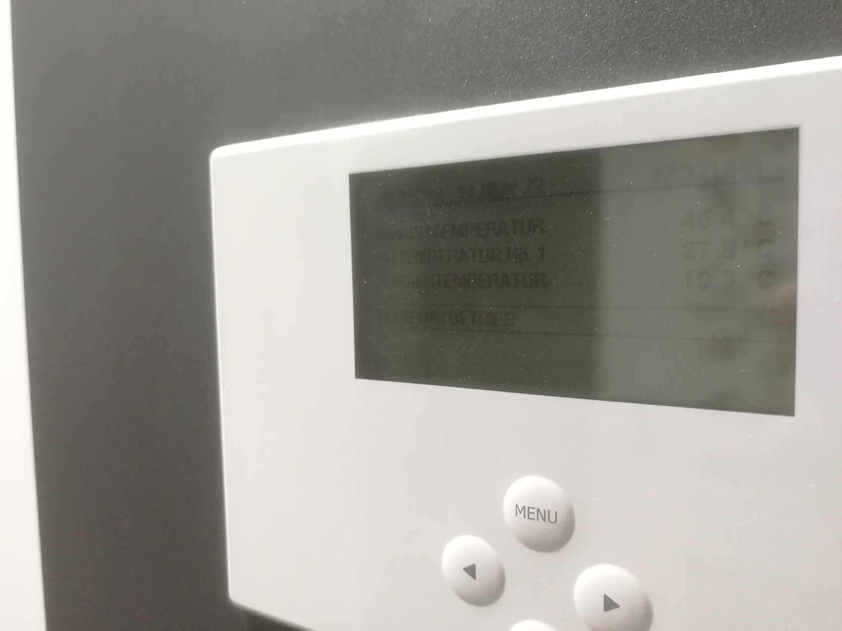

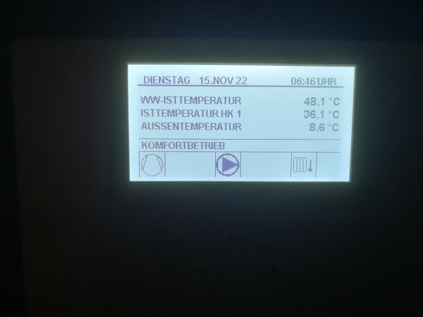

My actual domestic hot water temperature does not even come close to 50 degrees Celsius (122°F) – that can’t be normal, can it?

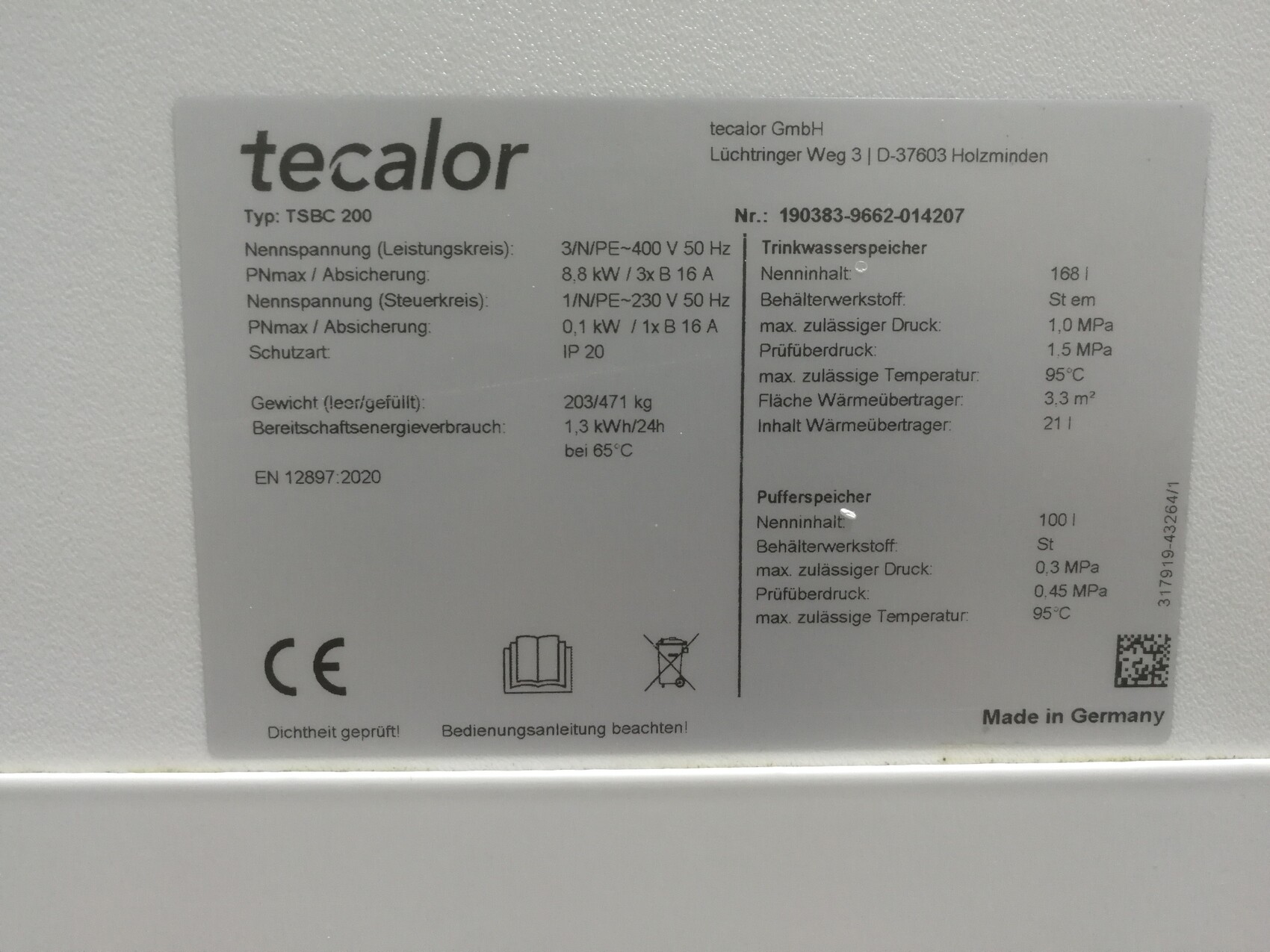

According to the nameplates, my tank has a total capacity of 268 liters (70.8 gallons), apparently divided into 168 liters (44.4 gallons) for domestic water and 100 liters (26.4 gallons) for buffer storage.

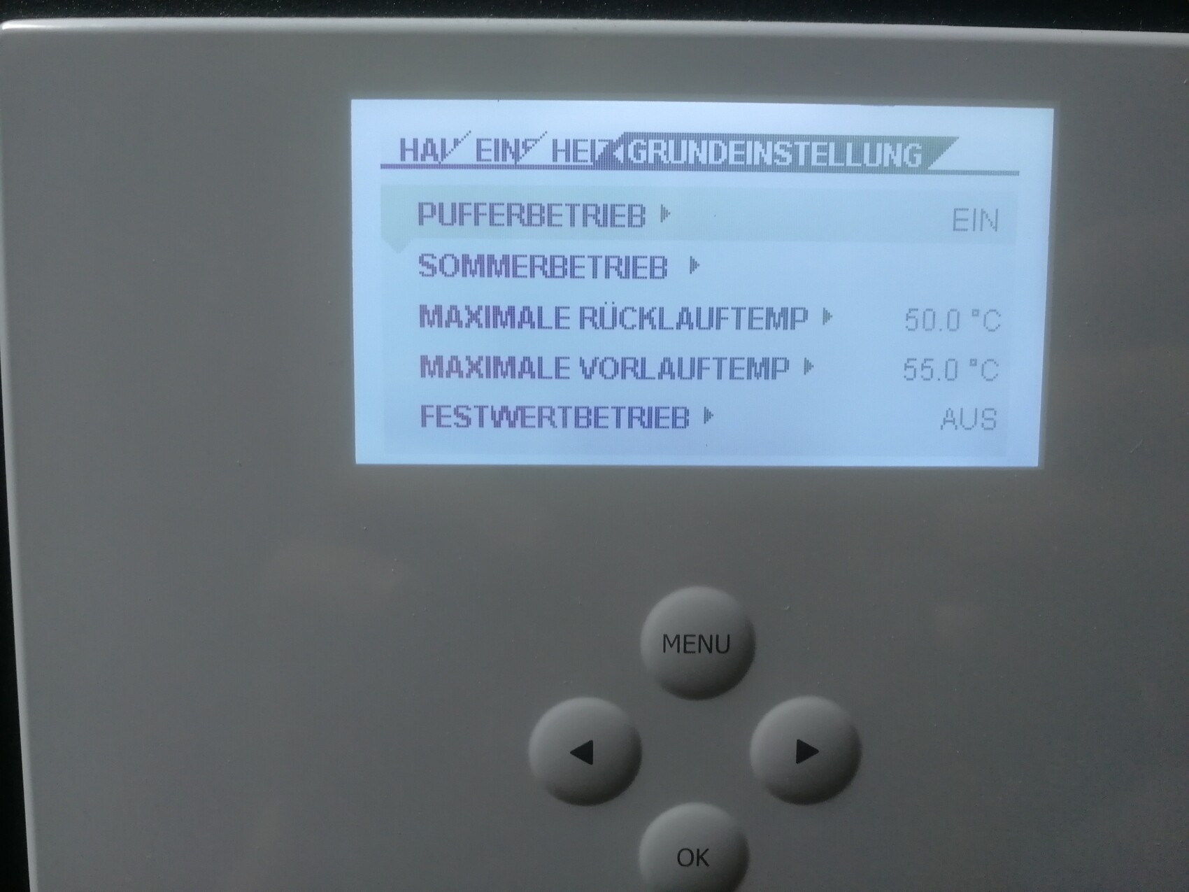

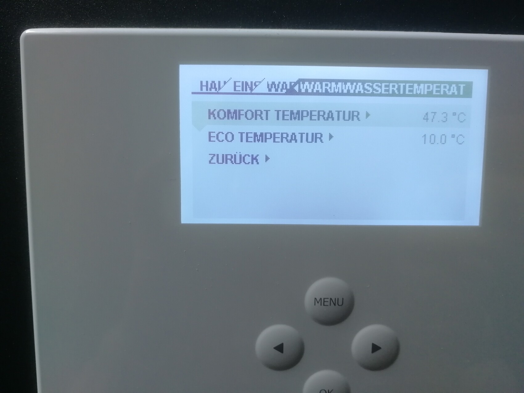

My domestic hot water COMFORT temperature is set to 47.3 degrees Celsius (117.1°F). Is this the actual "comfort temperature," or is it the maximum temperature the hot water can reach? Should I set this temperature higher, above 50°C (122°F)?

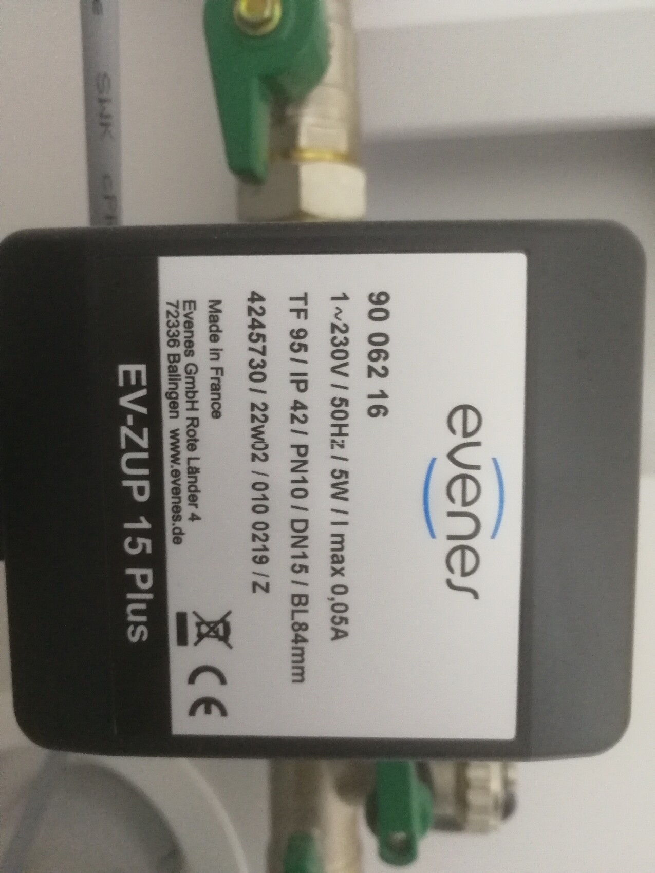

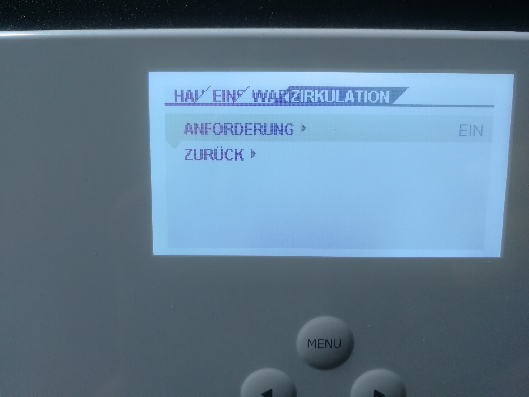

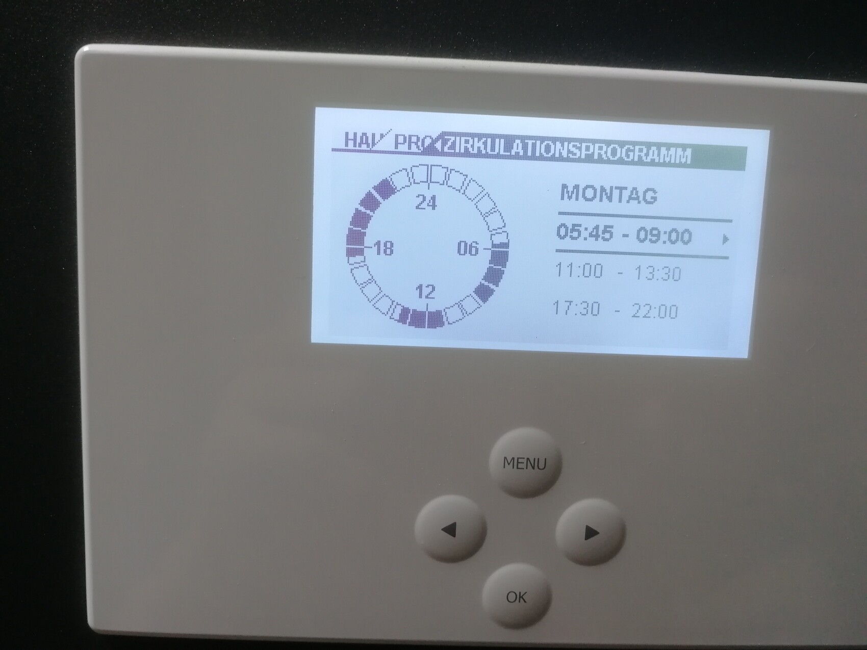

It seems like I do have a circulation pump (see pictures). The setting for "circulation" is ON, so I assume the circulation mode is active?

Yes, I would say you need to set this "comfort temperature" higher. I would try setting it to 51°C (124°F) and adjust the hot water hysteresis (there should be a parameter for this somewhere) to 4°C (7°F).
That way, the hot water should heat up to 55°C (131°F) and start again at 47°C (117°F).
Regarding the circulation, you might also want to consider whether these times make sense for you or if they should be shortened. It does consume quite a bit of energy.
