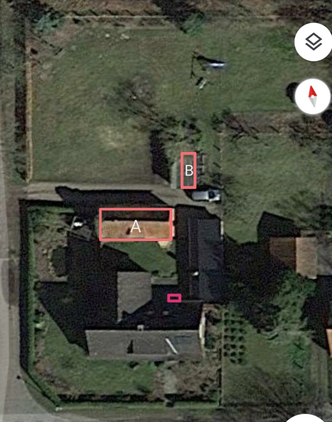

This concerns building "A," which you can see in the picture.
The garage "B" will definitely be demolished. The house entrance is marked in red. A new terrace will be built in front of the entrance.

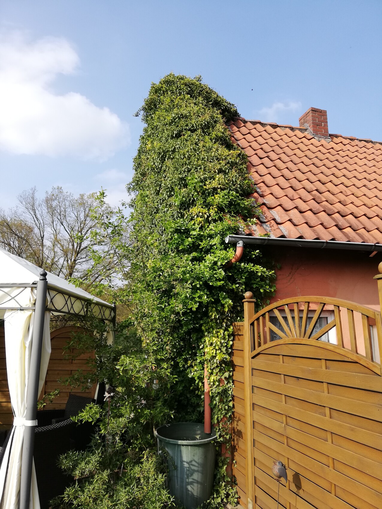

- The entire west wall is covered in ivy up to the roof, which must be removed
- New paint (possibly also new render?) on the building
(Ivy on the west side)
