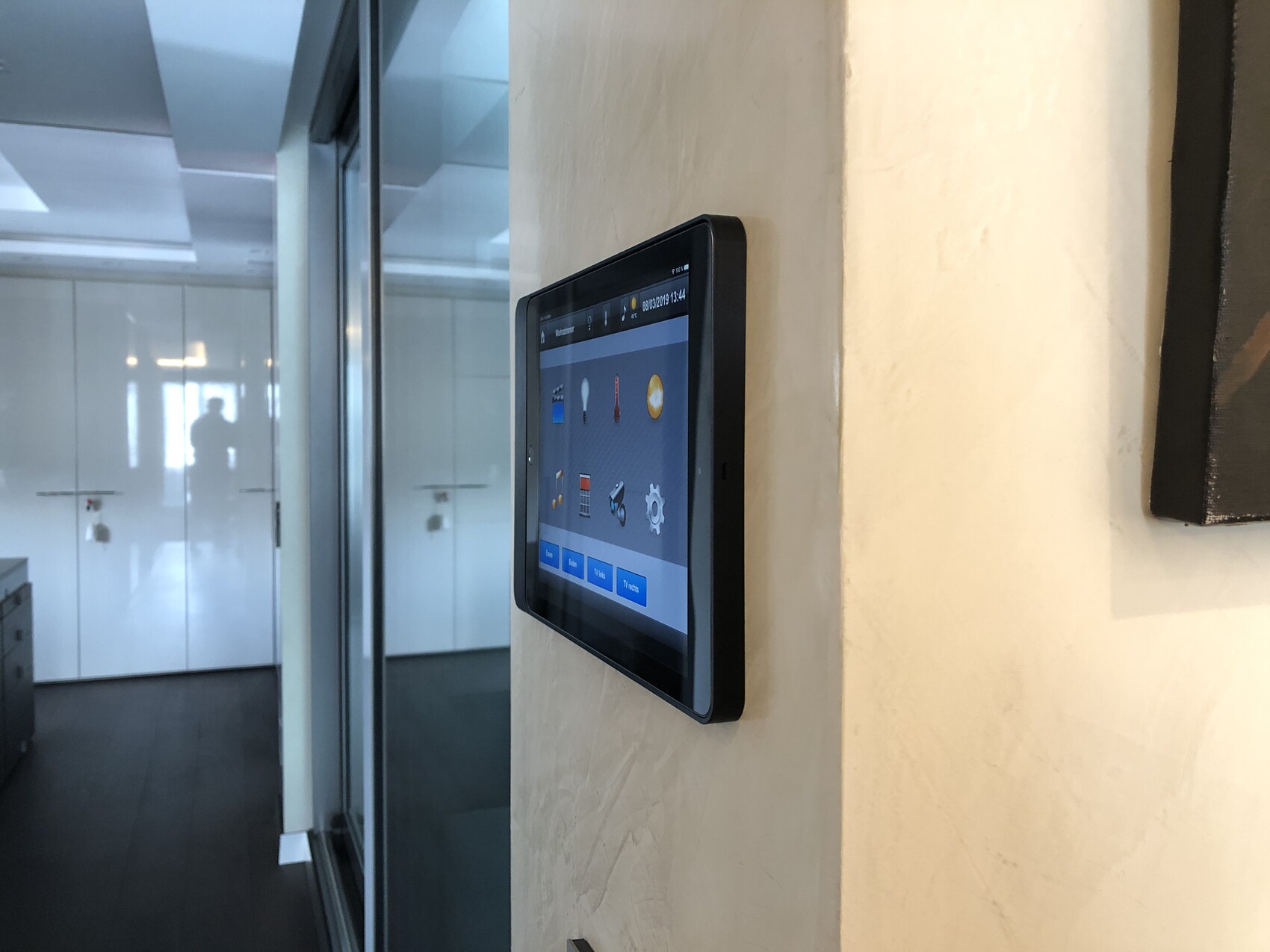

Araknis24 Feb 2022 12:22

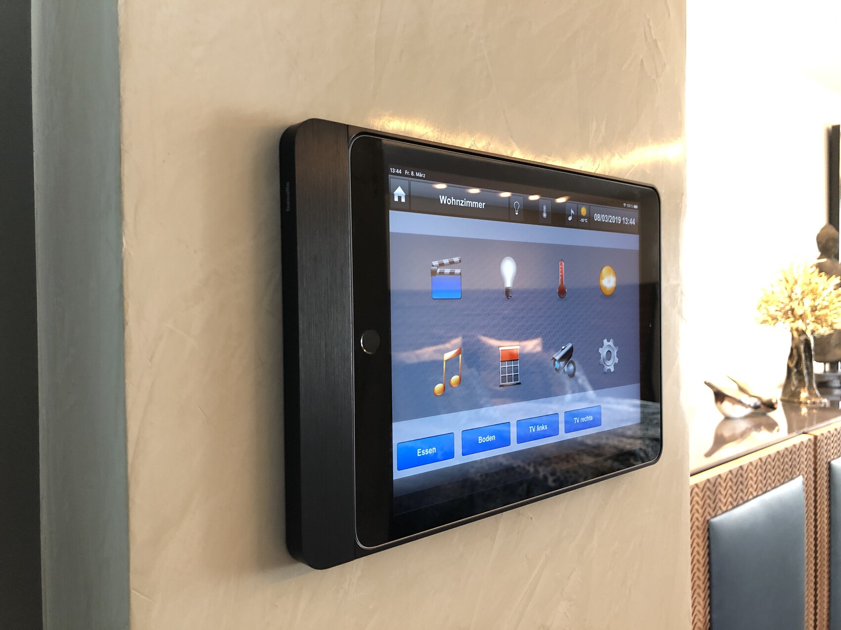

Yes, Basalte Eve with iPad. Behind it is a small flush-mounted USB power supply. This is an older photo, but it still looks the same today, or with the current versions of the Eve mounts.
Wall-mounted tablet with smart home interface in the living room, icons for lighting, music.
Tablet mounted on a beige wall with app icons; glass corridor in the background, silhouette of a person.

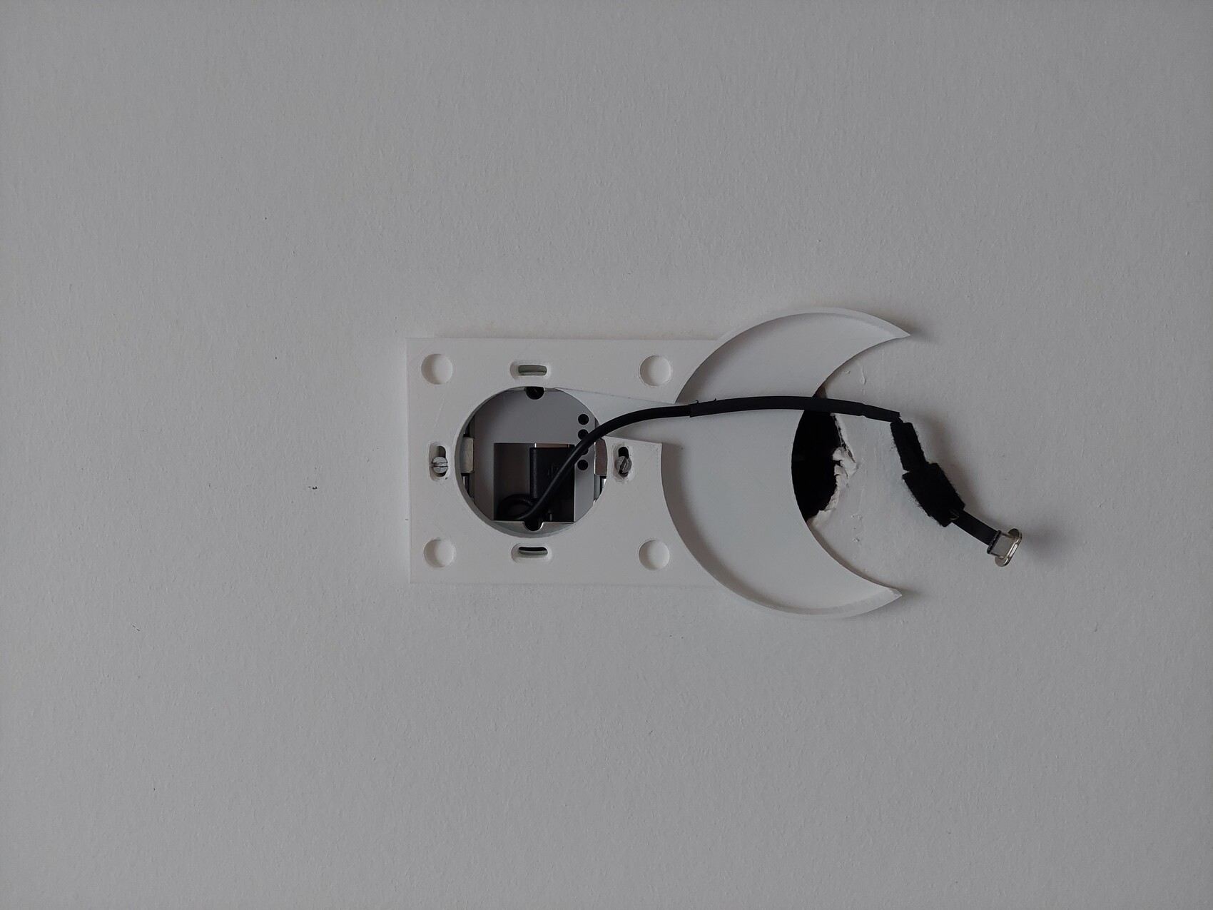

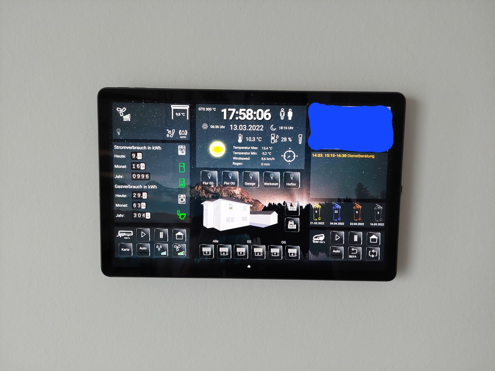

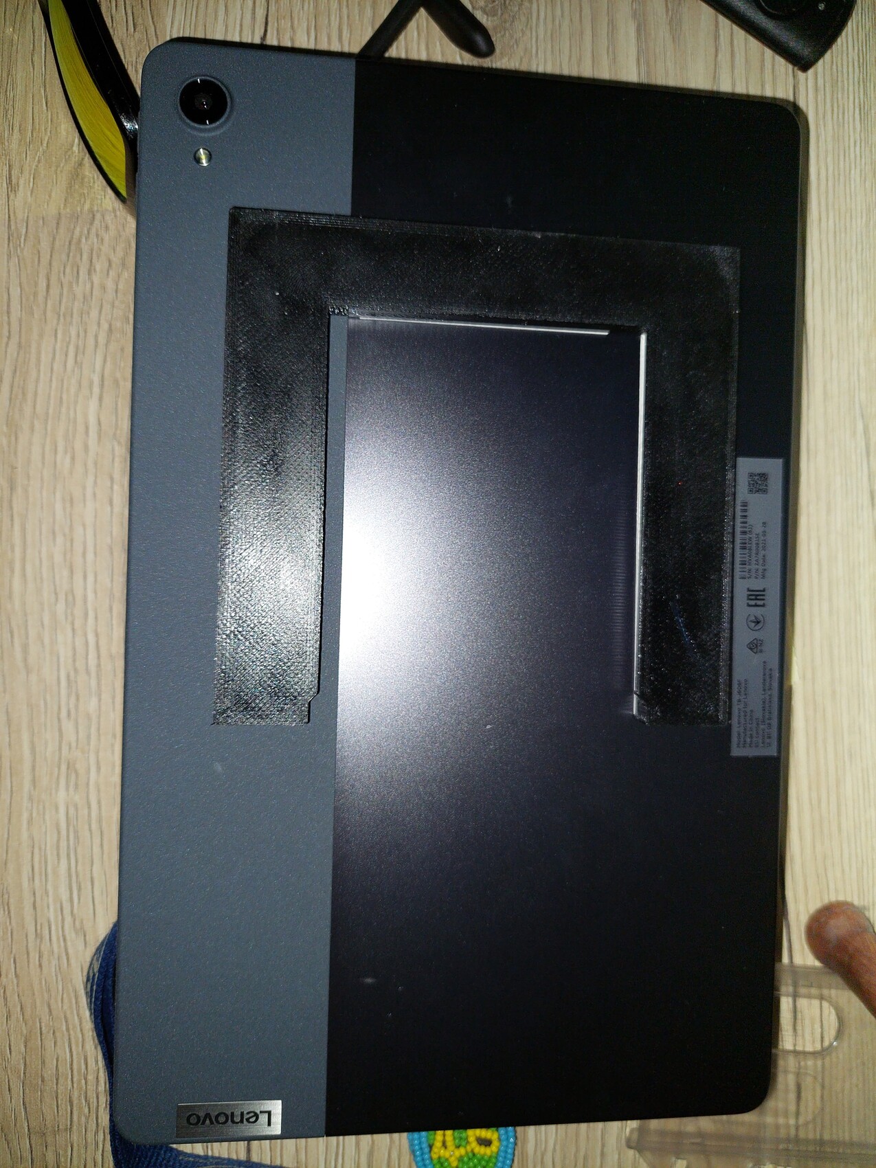

I designed and 3D printed the tablet holder myself. The wall-mounted part is secured inside the flush-mounted box with two screws. The matching piece on the tablet is attached only with double-sided adhesive tape. The tablet is then simply slid sideways onto the holder. It works like a tongue and groove joint.
Tablet on the wall showing home automation dashboard with time, weather, and energy consumption.
White wall lamp holder with crescent-shaped cover part and loose cable.
Closed Lenovo laptop on a wooden surface, photographed from above, cable on the side.
The crescent shape was originally intended for wireless charging, but unfortunately, the transmitted power is not sufficient for always-on use at full brightness.

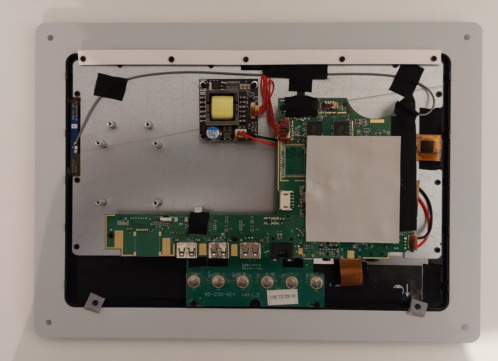

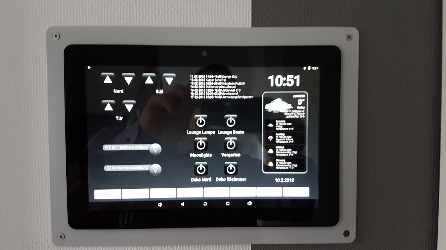

I took an ALLNET Touch Display Tablet 10-inch (new version with PoE, 299€) , removed the back cover, and mounted it on a custom-made powder-coated aluminum plate. It runs the iobroker app (see image). Unfortunately, the 2017 version had Android 5.1.1 and insufficient storage, so I ordered a new one (arriving Wednesday) with Android 11, hoping for better storage performance.
Tablet with wall panel for light control; time 10:51, weather widget
Opened electronics: mainboard, power supply transformer, circuit boards inside metal housing.
