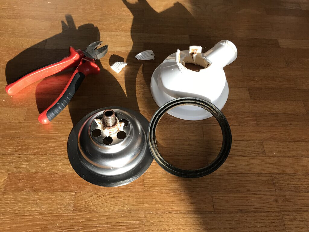

ronfruehling31 Dec 2025 14:16Hello everyone,
reporting partial completion. Ordered a new set via eBay for €24.90 (3 1/2 inches) including the complete drain with eccentric connector; hardware stores unfortunately closed since 2:00 PM. Wire cutters proved very useful. Simply cut off a bit of the plastic thread, then separated the three plastic ribs. I would have preferred to dismantle it without damage, but didn’t see a way to do so.

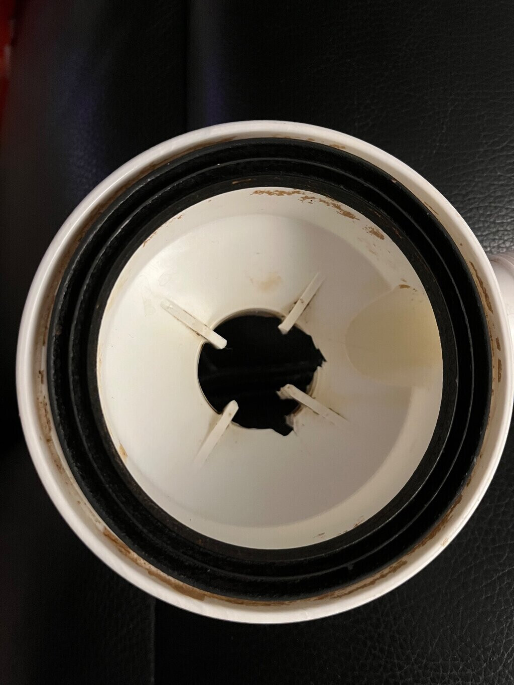

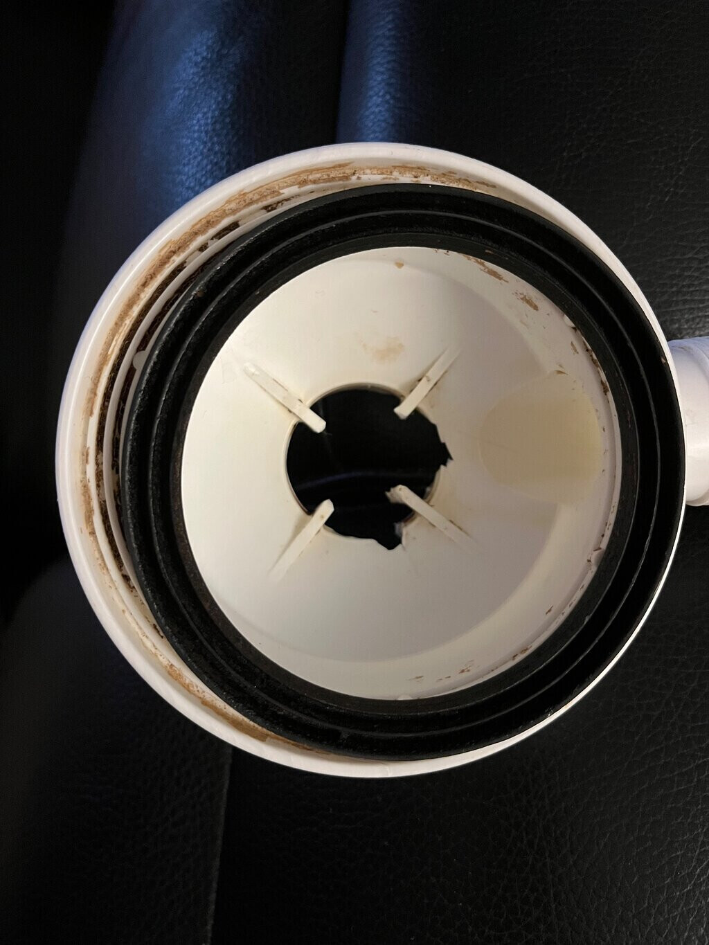

ronfruehling2 Jan 2026 22:07Hello everyone,
for the sake of completeness, here is the most likely reason for the leak.
The seal under the sink is about 10mm (0.4 inches) too small in diameter. The kitchen was delivered complete and installed by kitchen fitters. The seal held more or less poorly for 8 years, then it became hardened, and eventually, the failure occurred as expected. In the second photo, I deliberately moved the seal to the inner edge of the white plastic spout to illustrate the issue.

Spout damaged 1 – seal too small, centered
Spout damaged 2 – seal too small, off-center
