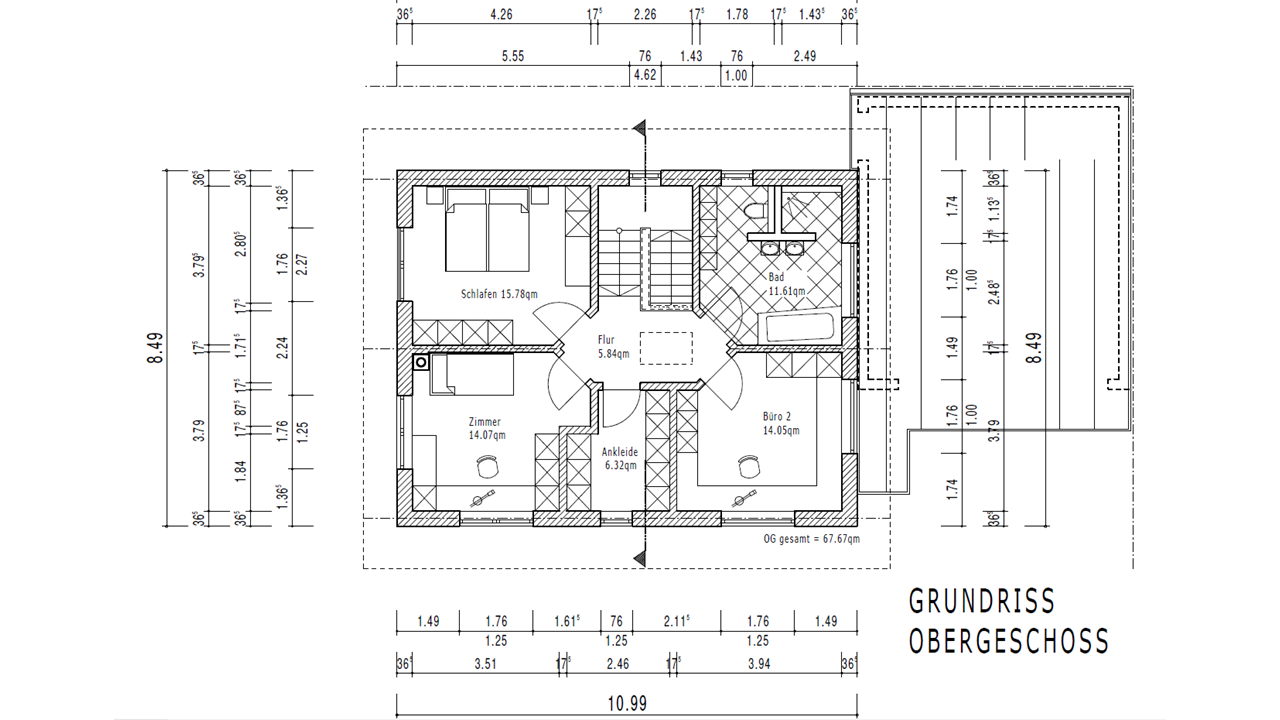

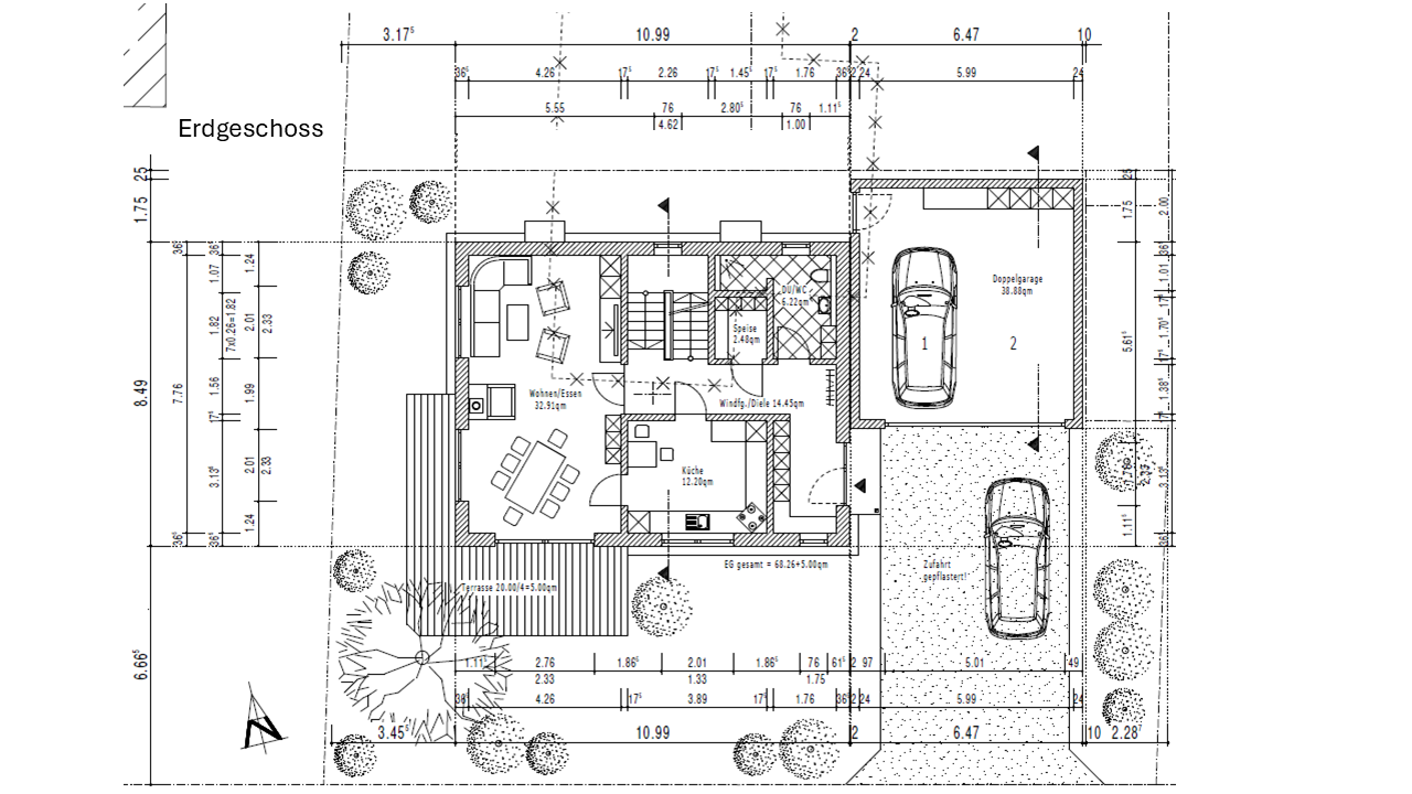

Baumweg32Hello everyone, we are planning to build a single-family home. We are 30 and 32 years old, have no children, and both work full-time in an office/home office. We have completed the questionnaire below and look forward to your expertise on our floor plan.

- Number of parking spaces – double garage plus one parking space next to the garage in the yard
- Number of floors – 2 full stories plus basement

- Other wishes/special features/daily routine, also reasons why certain things should or should not be included – ideally, when one person gets up, they leave the bedroom without having to return to it later to get clothes, so the other can continue sleeping. Also, we spend a lot of time working from home, so each needs their own office to avoid disturbing the other during calls, etc.
- Designed by: architect and draftsman
- What do you especially like? Why? – We like the possible sight lines (some doors and windows can still be adjusted). A generous entrance area is important to us when entering the house, so there is space for groceries and not feeling lost.
- What do you dislike? Why? – We are unsure about the 45-degree angled walls in the hallway. What are the pros and cons? Are there alternatives?

- What do you think makes it particularly good or bad? – We like that both our offices are the same size and separated by the closet. We also like that the closet is completely separate, so the bedroom does not have to be re-entered to get clothes once you are up (the partner can continue sleeping).

The winding hallway, the bulky fireplace, and the other unchanged features that make the house quite distinctive reveal which house it is.
Regarding your question: the doors match the slanted stove in the corner, the angled table, the tilted bathtub, and the diagonal tiling. Some elements simply won’t fit into a “standard” layout, so you should accept these unique highlights in the designs if you are attached to the rest. There aren’t that many tight spots without these features. The planner has to rely on these compromises in such cases.

In my opinion, these folding screens in bathrooms are just the same pointless trend in reality as they are on paper. Dance floor partitions that create artificial bottlenecks in oversized bathrooms: anyone who spells “genial” with an “h” is just silly *LOL* Why, first of all, start a thread "new" after nine pages, and secondly, why reset it so completely as if no “lessons” were learned from the previous discussion?
Besides, I not only notice the angled doorways but also another similarity in the graphical layout with the thread r9m3a1 "Style break due to children’s room access" https://www.hausbau-forum.de/threads/grundriss-einfamilienhaus-mit-2-offenen-punkten-stilbruch-durch-kinderzimmer-zugang.r9m3a1/ – coincidence or relation?
