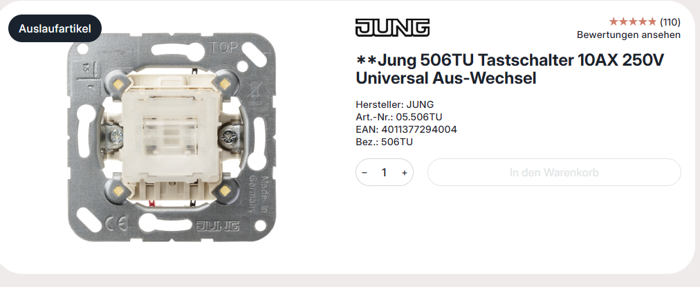

nordanney28 Apr 2026 09:27M
MachsSelbst28 Apr 2026 09:53Not many manufacturers offer something like this...
The Gira 312600 is a push-button switch that, unlike the one from Jung, is still available for purchase.
nordanney28 Apr 2026 10:18MachsSelbst schrieb:
Not many manufacturers offer something like this... Busch-Jäger with rocker switches (standard switches that return to their original position—so they always stay in the same setting)
You already mentioned Gira (they work great, I had them myself in the last house—combined with the System 55 Esprit)
Merten is similar to Busch-Jäger (they use a small spring clip)
Berker also offers push-rocker switches similar to Gira
These are just the insert mechanisms. With the many different cover plates, there’s a large range of visual options.
But the original poster said they are set on Jung (for whatever reason).
MachsSelbst28 Apr 2026 10:34That is always the risk. It seems that the Jung model is being discontinued, and whether there will be a replacement, he will have to find out.
By the way, Busch-Jaeger calls it a pressure sequence switch.
I will keep my switches and handle it with edge evaluation... Pushbuttons for lighting in a single-family house give me the feeling of a stairwell or industrial building 😀
