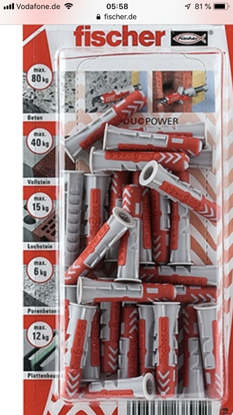

dhd82 schrieb:
I want to use the “standard” or the fastening materials that usually come with furniture, for example.
I don’t think I have ever used the dowels provided with those. They usually look much more fragile compared to the Fischer variants.
But the attached picture illustrates this quite well. The Duopower and UX anchors can basically be installed into any material; unfortunately, their load-bearing capacities vary significantly.
