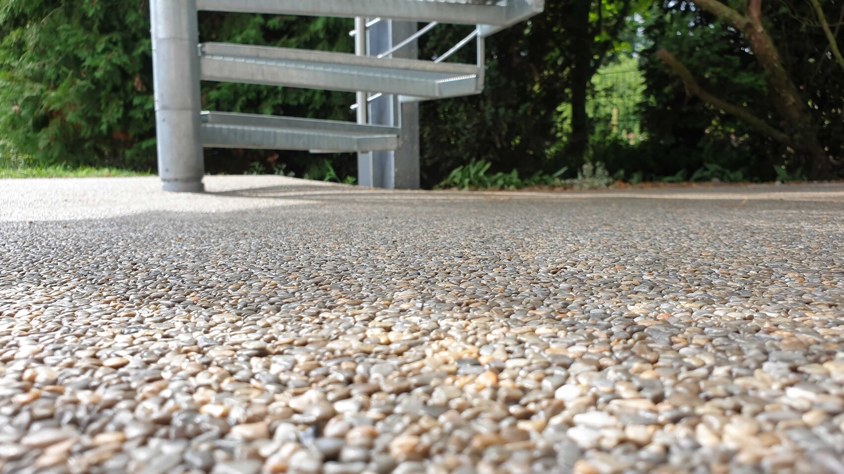

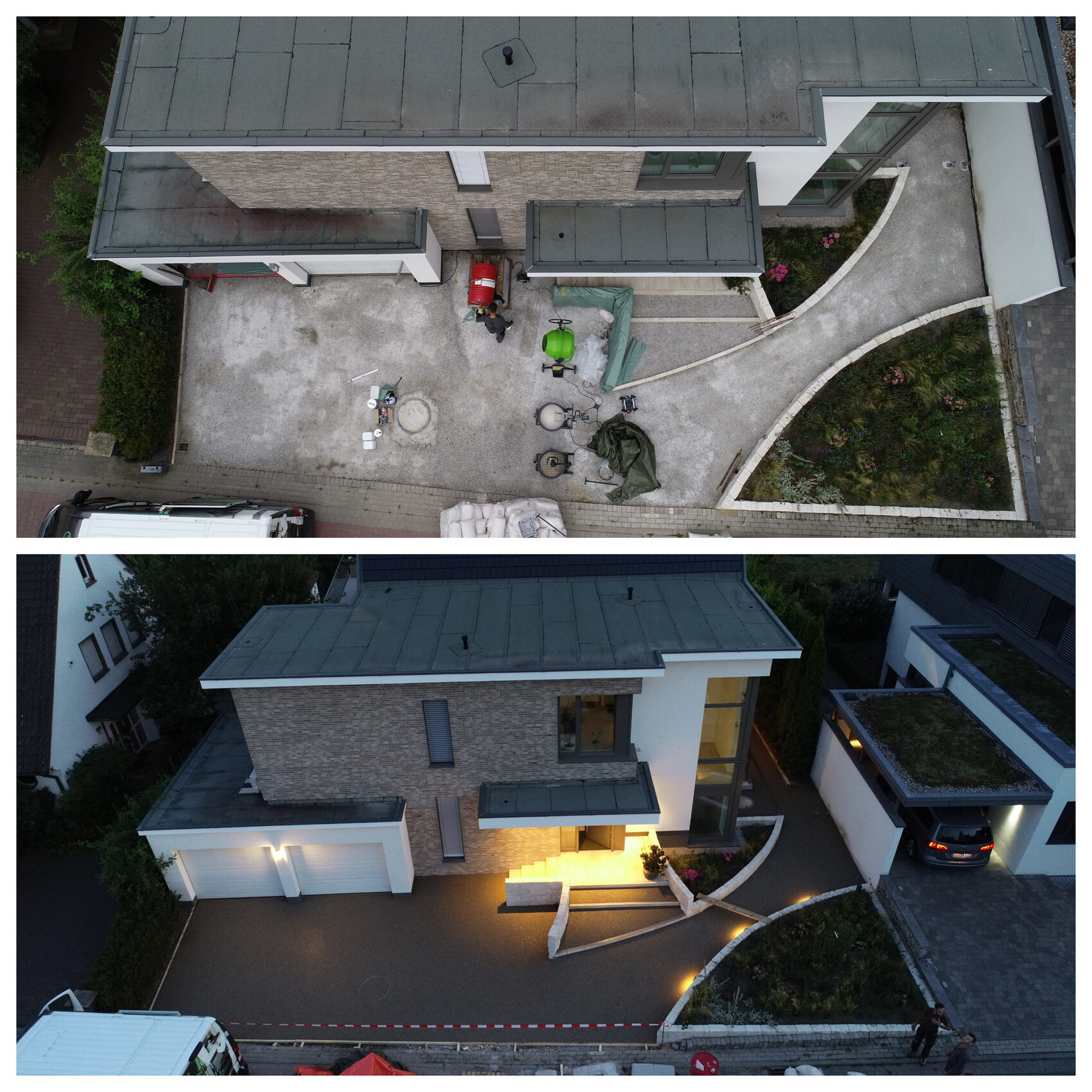

This is basically the bound gravel surface I mentioned, except that here PU is also used as a binder. Otherwise, it is a compacted mixture of grit/crushed stone.Do you happen to have any experience with this yourself?
