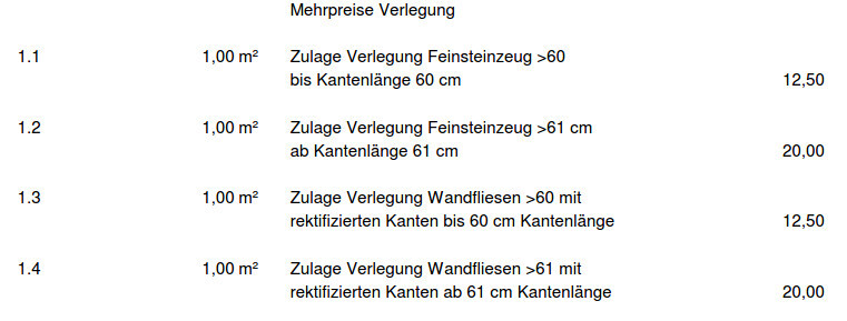

Hi,
well, for 20 € more per sqm (square meter) they must take at least 20-30 minutes longer per sqm. And I seriously doubt it’s that much.
I just checked tile adhesives for fun; the cheapest are about 0.80 € per kg (at 1-2 kg per sqm, that’s 0.8-1.6 €), and the expensive ones a bit over 2 € per kg, so max 4 € per sqm. So you can reasonably explain a 3-4 € per sqm surcharge for porcelain stoneware, but definitely not 12.5 € per sqm.
Silly question: is porcelain stoneware always rectified? I just noticed that here they only want a surcharge for rectified wall tiles. For floor tiles (which are rectified porcelain stoneware here), it seems not to matter?!
I’m curious; we’ll meet with the tile people again on Saturday. In the end, we might completely redo the tile planning…
