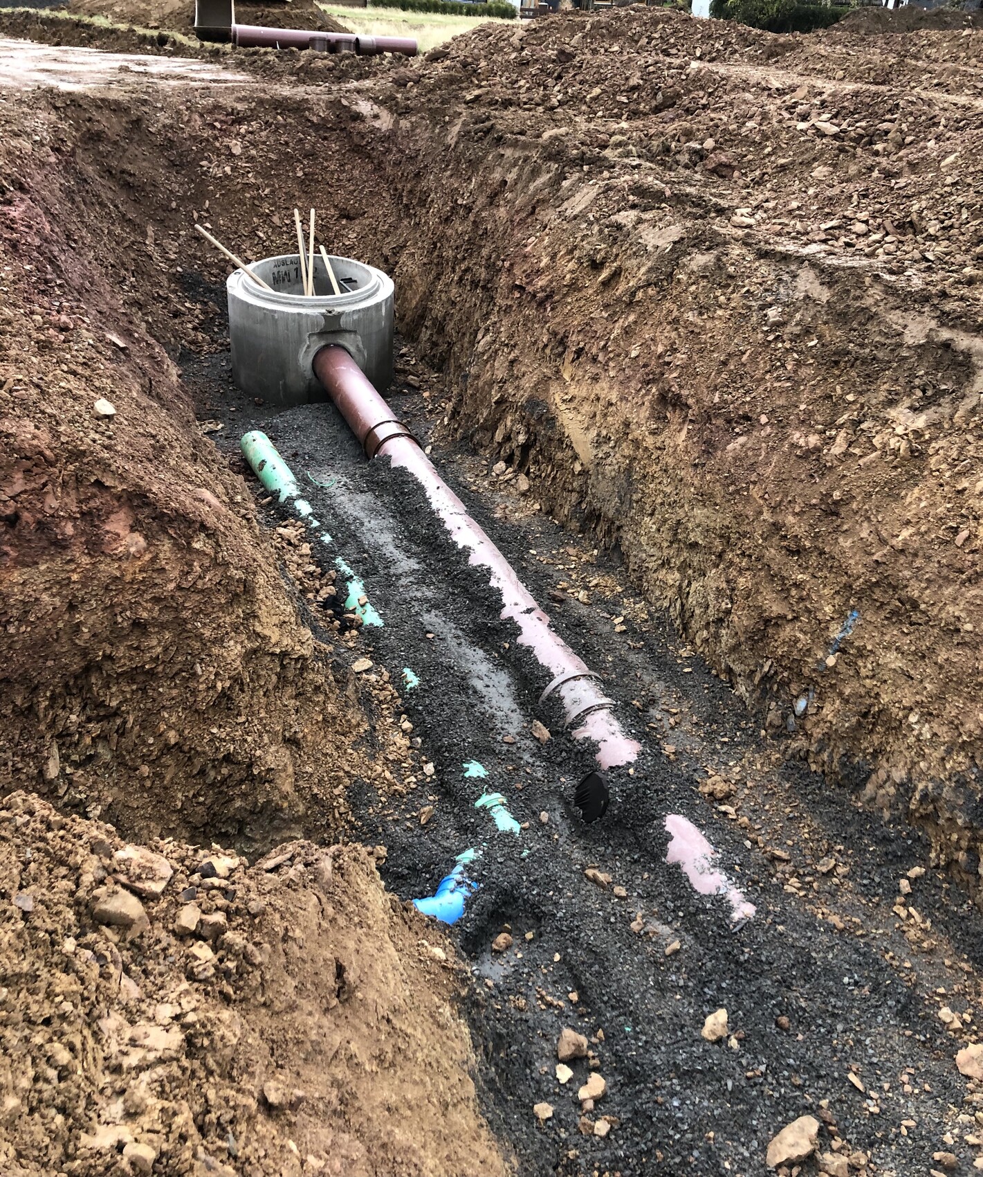

I need to tap into the collective knowledge of the forum once again.
Currently, the access road/(construction) road to our new housing development is being installed.
Under the road, only two plastic pipes are visible (1x wastewater and 1x green empty conduit):
Today, I seriously started wondering where the utility lines for
– fiber optic
– power/ground cables
– water connection
– possibly gas line
are located?
Usually, the wastewater pipe is the deepest pipe under the road, isn’t it?
However, in picture 1 it can be seen that the back part of the road – aside from the asphalt layer which is already finished – has no visible channels or utility lines emerging.
I’m a bit confused and hope for some clarification. 😀
Thanks in advance!

Gartenfreund1 Nov 2021 01:19No idea how it is usually done, but for us, gas, water, and so on run underneath the sidewalk.
DaSch17 schrieb:
Or will it be reopened later? I can’t imagine that. That wouldn’t make any sense. That’s exactly how it’s done. There’s hardly any other way, since if all the utility installers worked at the same time, they would get in each other’s way with the construction equipment and trenches. Typically, due to the different elevations of the utilities within the road structure, the construction sequence is as follows: first the deep utilities, like the sewer, then water, followed by gas/district heating, and finally copper, fiber optic cables, electricity, and empty conduit systems.
