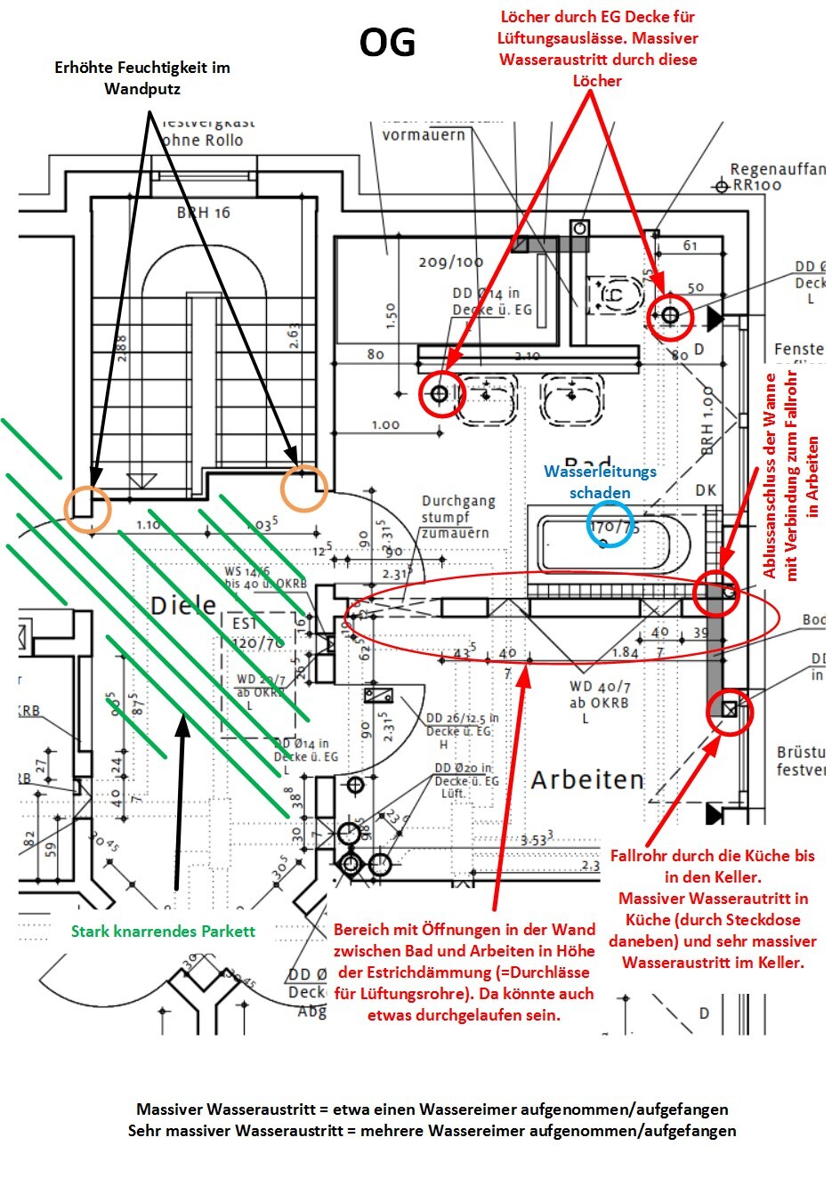

In our new build, a fresh water pipe burst today, probably the supply line to the bathtub. As a result, water suddenly leaked through the ventilation openings on the floor below, from the sockets in the kitchen, and from the ceiling in the basement next to a downpipe.
Without going into the detailed plans: it is certain that the bathroom screed and insulation are completely wet. The bathtub is located at one end of the room, while the ventilation openings in the ceiling, through which the water then flowed downwards, are at two other ends of the room.
The question now is how do we _reliably_ determine how far the damage has spread?
The kitchen below also must have been affected. The sockets are next to a downpipe, and the water has run along it into the basement.
The corridor upstairs and an adjacent study might have been impacted as well. Is there any way other than removing the parquet flooring and breaking up the screed?

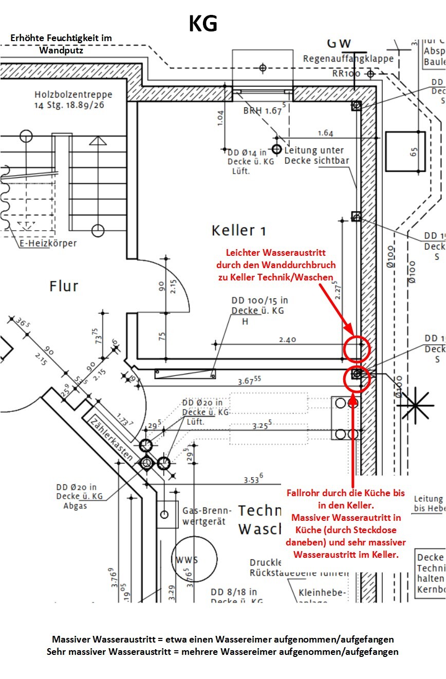

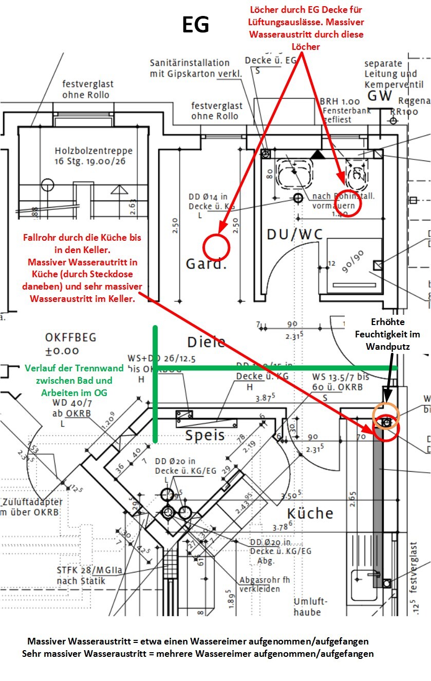

Hi Klara,
This concerns the upper floor (UF), ground floor (GF), and basement.
A water leak occurred in the upper floor bathroom, and then the water flowed down to the ground floor and the basement.
In the basement, there likely wasn't much damage; the water was about 5 mm (0.2 inches) high on the tiles, but they are sealed with thick silicone along the walls (tiles skirting). We completely removed the water ourselves. I’m not worried about the floor there.
However, the rooms do have screed on top of an insulation layer, partly even with underfloor heating.
The upper floor is particularly problematic because the screed insulation is extensively wet, and possibly the ground floor as well, since the water ran down the soil pipe through the basement ceiling (ground floor floor) into the basement. Now, no one knows whether the water fully went down into the basement or how much remained within the screed structure of the ground floor.
Only tiled floors were affected by the water leak. The parquet and laminate flooring did not get a drop of water directly. At the moment, there is almost no visible damage, apart from some damp spots on the walls.
Our main concern is now that the screed insulation and the screed have absorbed a lot of water.
