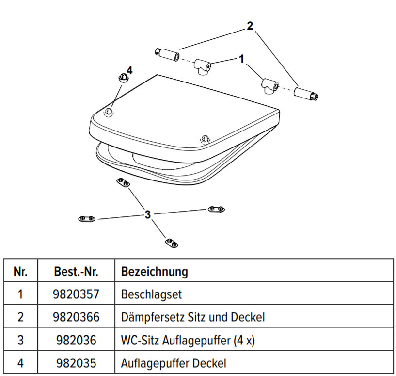

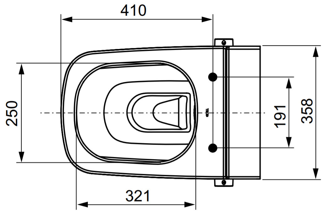

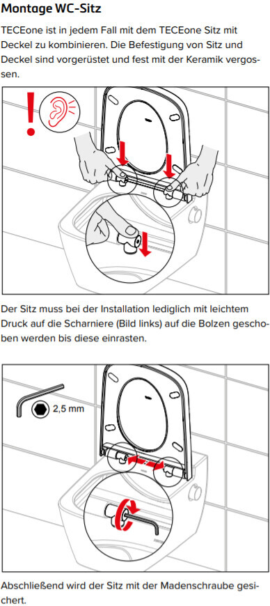

I am looking for a suitable toilet seat for the TECEone toilet.
I have attached drawings.
The TECEone toilet seat is not an option for this project due to design reasons.
Thank you very much!

Image 1:
Top view of toilet seat with dimensions and screw mounts on the right.
Image 2:
TECEone toilet seat installation: place seat on bolts, snap in, and secure with set screw.
Image 3:
Exploded view of a toilet seat with mounting kit, damper set, and support buffers.

The mounting system here is different from most toilets: factory-prepared and permanently embedded bolts.
