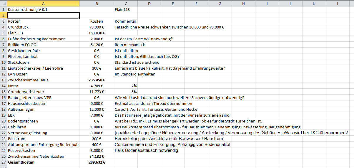

Ok, I will gradually include all the construction costs.
Cost Calculation V0.1
Flair 113
Item Cost Comment
Land 75,000 € Actual prices vary between 30,000 and 75,000 €
Flair 113 153,030 €
Underfloor Heating Bathroom 2,000 € Is this necessary in the guest restroom?
--> definitely! How else do you get heat in there? Such small rooms cool down very quickly.
Shutters Ground Floor / Upper Floor 5,120 € Fully mechanical
--> think carefully about this! Retrofitting is very complicated. My parents regret not choosing electric ones.
Painted Plaster 0 € Included
--> What quality? Level 3? I suspect more like Level 2, which is not suitable for painting.
Tiles, Laminate Flooring 0 € Included; Does this apply to the upper floor too?
--> check the detailed scope of work very carefully. Tiles are included at a per square meter price. If you use more, you pay extra. Skirting boards are rarely included. Laminate is also important — what kind of underlay it has and the abrasion class, so again, the price per square meter matters. Tiles usually only cover bathrooms (often only splash zones, not up to full wall height), hallways, storage rooms, and sometimes the kitchen.
Power Outlets 0 € Standard is sufficient
--> I really doubt that. The standard is usually 3 outlets per room. Trust me, that’s quite sparse.
Speaker Cables / Conduits 300 € Estimated roughly. Does anyone have experience here?
LAN Sockets 0 € Included in standard
--> read the detailed scope of work carefully to see what is included. Sometimes they only account for the cables, not the sockets. And what about TV? Satellite?
Subtotal House 235,450 €
Notary 4,709 € 2%
Land Transfer Tax 11,773 € 5%
Construction Supervisor, e.g., Private Building Owners Association 0 € How much does that cost and are additional experts necessary?
--> we hired one from the Homeowners’ Protection Association and would always recommend that. We paid 300 € per visit.
Utility Connection Fees 6,000 € Taken initially from another thread
Outdoor Facilities 12,000 € Carport, driveway, terrace, garden, and hedge
--> never ever! You can easily spend 12,000 € just on the driveway (possibly including the terrace) if you have it done professionally. A decent carport alone costs around 5,000 €. We were in the “we’ll do it ourselves later” category. So far we have spent:
Soil fill - 1,000 €
Paving stones for our (large) driveway: 2,000 €
Plant rings to temporarily support the slope (will be replaced with a wall in a few years): 400 €
Stones for terrace edging: 400 €
Concrete for various foundations: 1,000 €
Rented excavator: 240 €
Curbstones: 300 €
Almost 5,000 € and we still have a lot left to do. No terrace yet, no paved driveway, etc.
Fitted Kitchen 7,000 € That’s what our current one cost, and we are very satisfied
Soil Report 0 € Included with Town & Country. However, it must be clarified whether it is sufficient for the local authority.
Fees 1,000 € Taken from a construction cost thread – for house number, drainage approval, building permit / planning permission
--> Our building permit / planning permission actually cost us 1,200 €. There were some special cases.
Surveying Services 3,000 € (qualified site plans / elevation surveying / staking out / building survey; What does Town & Country cover?)
--> They don’t cover any of this. 3,000 € might even be tight.
Temporary Construction Power 300 € Provision of connections for construction water / temporary electricity
--> For us, the meter was 270 €, and the connection for temporary power 380 €. Construction water is easy. You’ll probably get a standpipe and pay rent per day. For us, it was 3 € per day.
Soil Excavation Disposal 400 € Container rental and disposal; depends on soil quality
--> I had to laugh here. Our 4 cubic meter (around 140 cubic feet) rubble container alone cost 200 € rental. You should budget significantly more for soil excavation.
Contingency Costs 8,000 € In case soil replacement is necessary
--> You can only estimate this once you have the soil report. Before that, it’s guesswork. You might get by with some compaction or, like us, need to excavate about 1 meter (around 3 feet).
Subtotal Additional Costs 54,182 €
Total Costs 289,632 €
Here it is again as an image. If there is a better way to copy-paste from Excel, let me know.
I have replied in your quote. I really think you need to carefully review all costs again. Hot tip: Take the Town & Country scope of work and read exactly what is included and what is not. It’s best to get professional advice as well.
