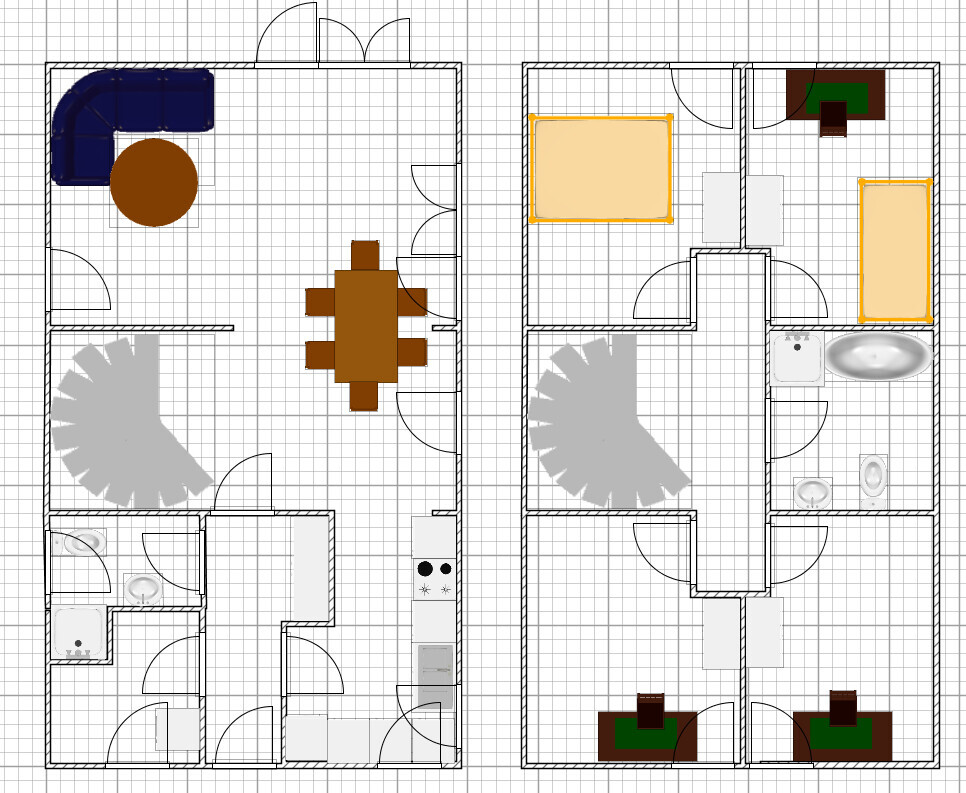

So, we have found a floor plan that we really like. We made some minor changes to better suit our ideas.
Special House Designs
Design Number 4 – Point 114.2
Floor plan: two apartments; left side living room with blue sofa, dining table; right side bedroom, bathroom.
What do you especially like? Why?
The central living area, because that is where family life takes place. The kitchen, dining room, and living room are arranged in an L-shape, which works very well.
The staircase is clearly visible.
Windows in every room allow good ventilation and natural daylight.
Five rooms of equal size that can be used flexibly.
What do you not like? Why?
Cost estimate according to architect/designer
134,500 €
Which details/extensions could you do without?
Which details/extensions are indispensable?
Why does the design look the way it does now?
Standard design from the planner.
What do you think about the design? Do you think the price limit of 280,000 € can be maintained with this plan? What weaknesses do you see in the plan? I would personally prefer more storage space downstairs instead of a second shower, but there is still plenty of time to think about that.

Where should the wardrobes be placed?
chbest
1 Dec 2017 21:32
Pumbaa schrieb:
Where are the wardrobes supposed to go?
According to the plan, they are to be placed against the interior walls. They are also shown there on my plan. However, in the master bedroom, this will probably only work if the bed is positioned lengthwise under the sloping ceiling and one person always has to climb into bed.
kbt09
1 Dec 2017 22:19
Is a sloped roof going to be added there as well? Which one? How high is the knee wall?
When I compare the initial “open plan” draft to the current version, I see more of a “waste of space” in the open area, while the fourth children’s or additional room is missing.
I would call the bathroom on the upper floor rather small, especially the shower.
The utility room on the ground floor will mostly be a technical room; I don’t see space for much more.
Overall, this is now a different house design than the first version. It would always make sense to orient the floor plans to the north and ideally place them drawn onto the property layout, so the spatial relationships can be assessed better.
11ant1 Dec 2017 22:26
kbt09 schrieb:
Is the roof slope going to be added as well? Which one exactly? How high is the knee wall?
I estimate 40-45° and about knee-high knee wall, so around 1m (it’s a Danwood).
kbt09 schrieb:
In general, this is now a different house design compared to the first option.
Yes, somehow there isn’t a clear overall concept visible.
chbest schrieb:
Plot size
Probably 300 m² (3,230 sq ft)
… also sounds like “there’s no concrete plan yet.”
