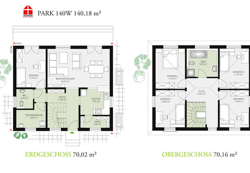

Design number 1 - Park 140 W
Central living area where family life happens. Kitchen, dining, and living rooms are ideally arranged in an L-shape.
Windows in every room for good ventilation and natural light.
Five equally sized rooms that can be used flexibly.
What do you not like? Why?
Quite a few doors on the left side of the plan, making that area feel busy.
Estimated cost according to architect/planner
163,400 €
Which details / expansions can you do without?
Which details / expansions are absolutely necessary?
Why does the design look the way it does now?
Standard design from the planner

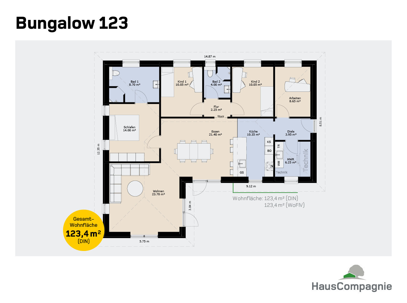

Design number 2 - Bungalow 123
Windows in every room for good ventilation and daylight.
Guest toilet is easily accessible from the center.
Two showers.
The large bathroom is only accessible through the master bedroom.
Only three children’s rooms.
The children’s rooms vary in size.
xxx €
The master bedroom is too large.

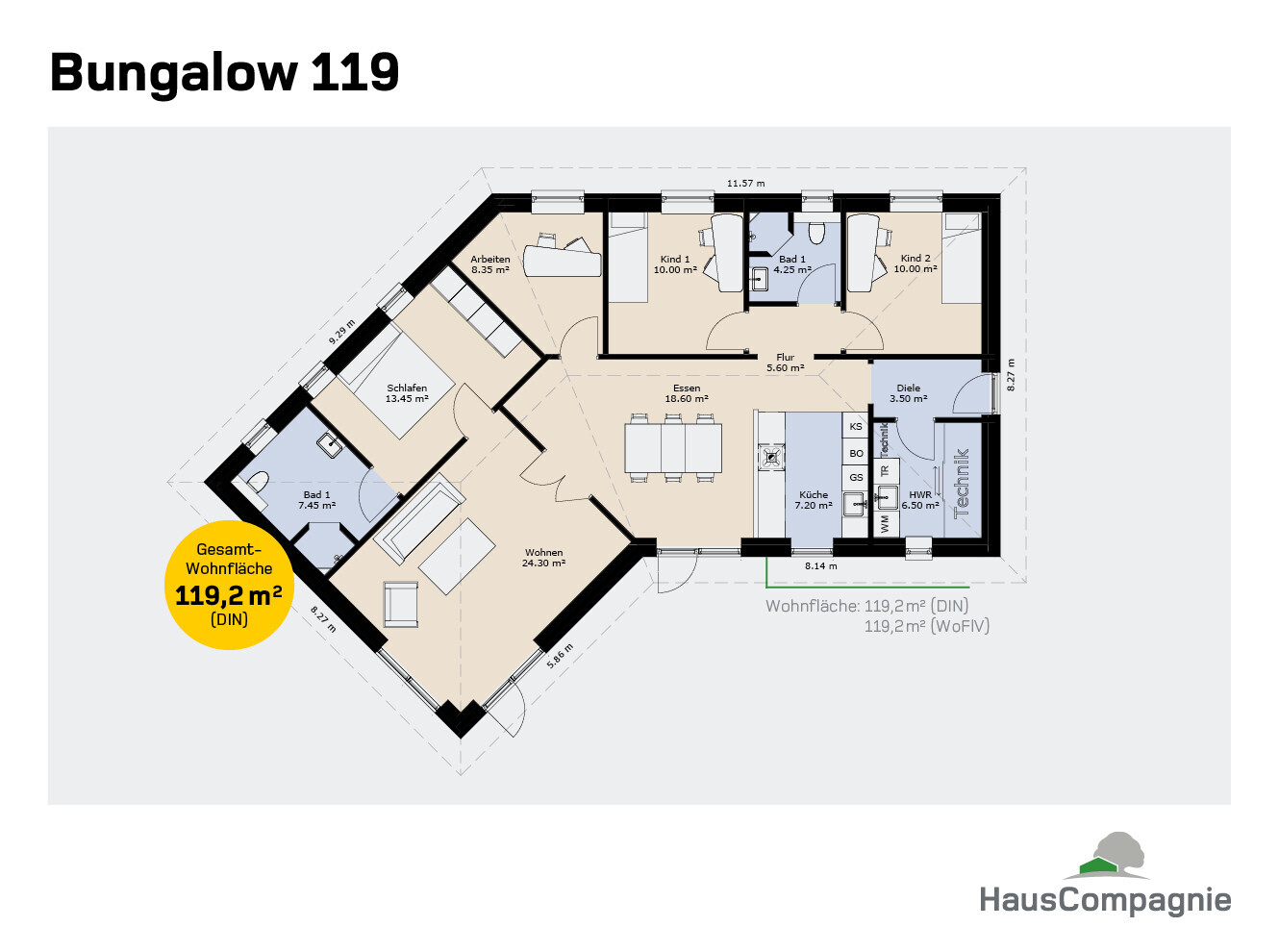

Specific House Designs
Design number 3 - Bungalow 119
Guest toilet is easily accessible.
Two showers.
A terrace in the bottom right of the plan has abundant sunlight during the day.
xxx €
163,400 €
Two showers.
xxx €
Two showers.
xxx €
