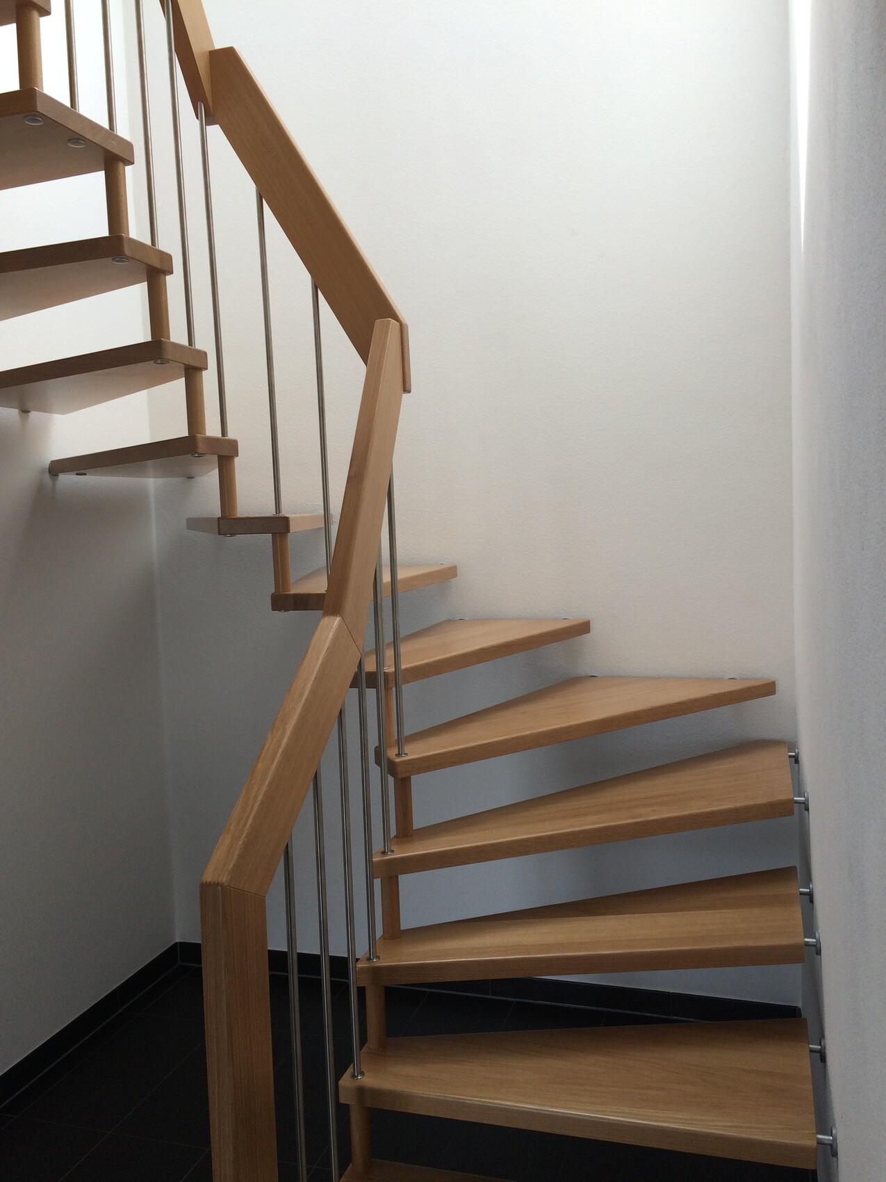

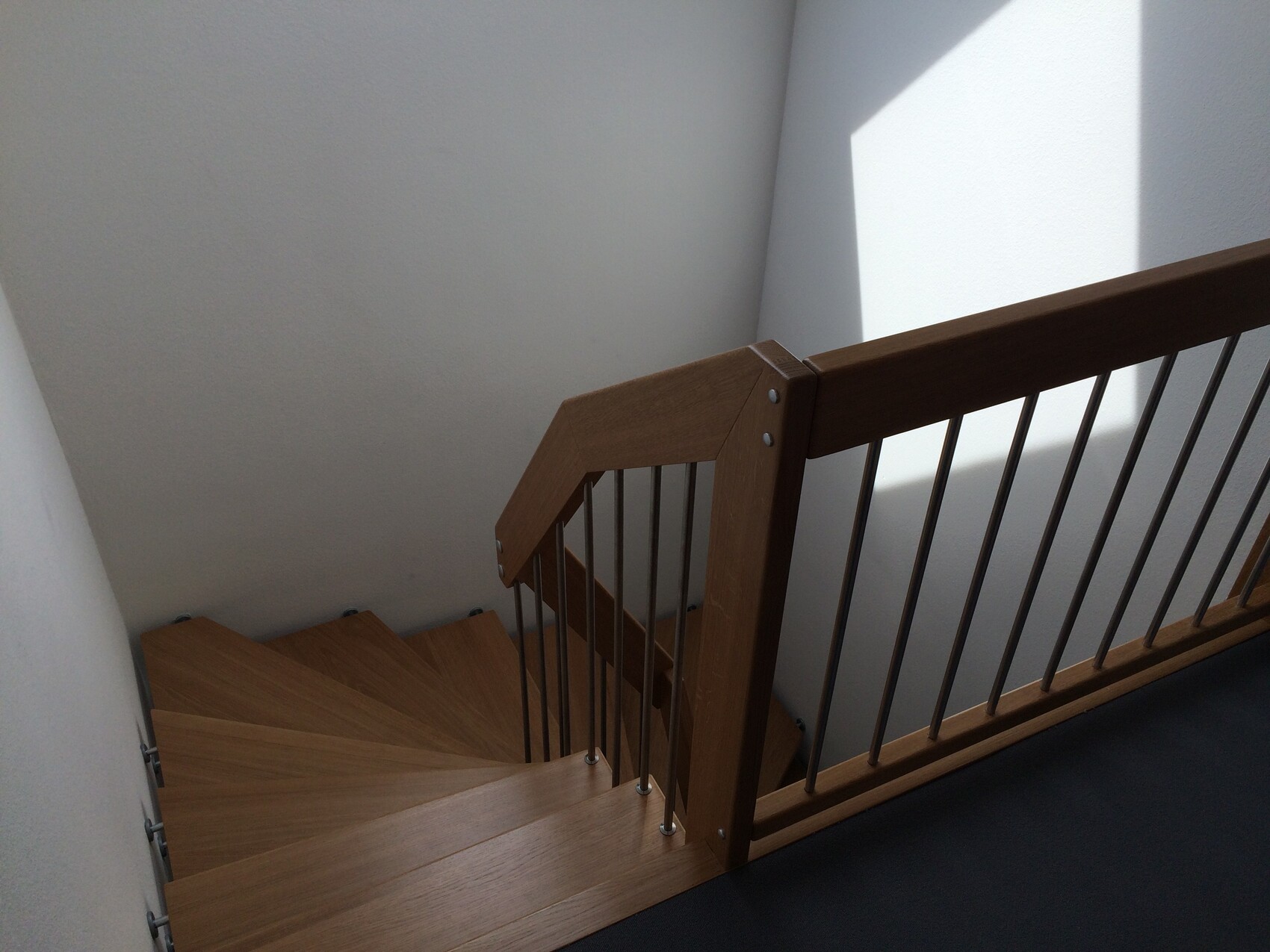

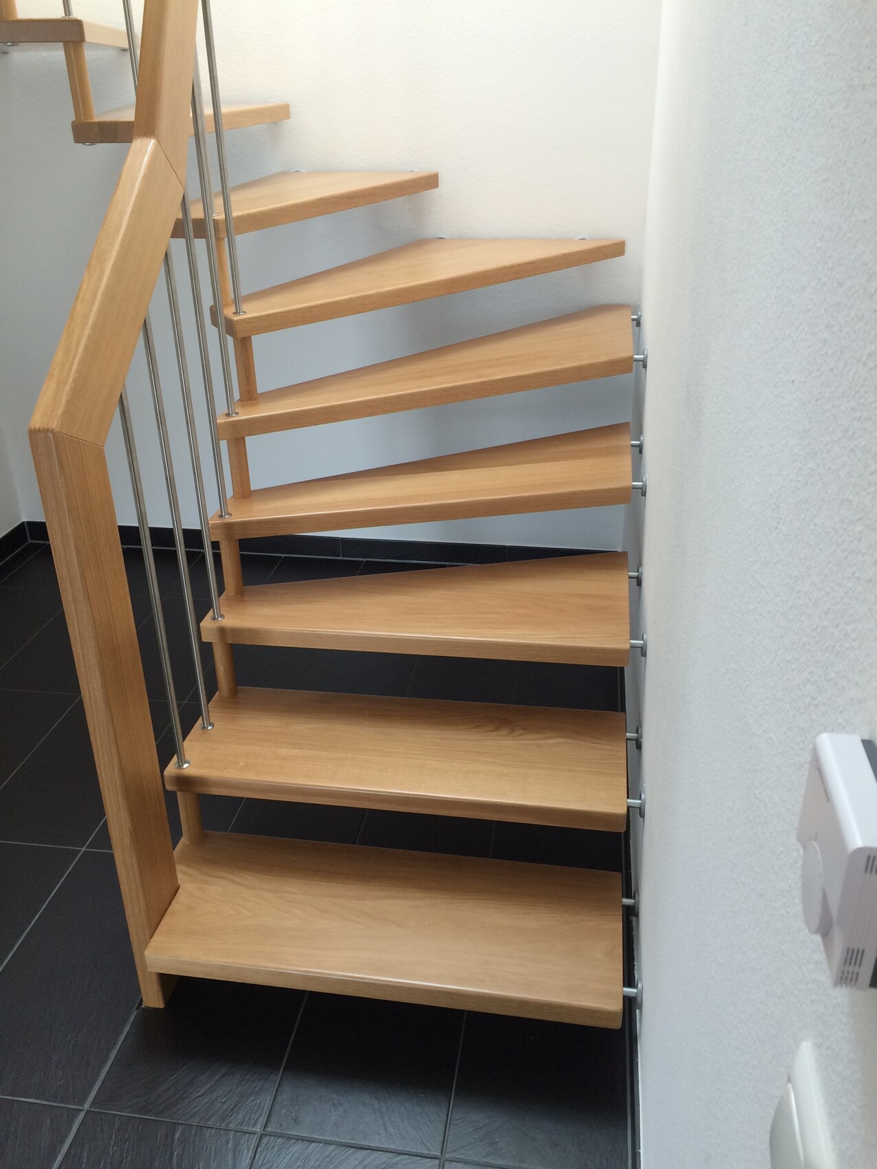

The staircase looks very short... it should really be around 220 cm (87 inches).I’m not sure if I’ve posted these before, but attached are some pictures of the staircase.
It will be the same design, with stainless steel rods and oak.

The staircase in the photos is too small. How do you get a wardrobe or a bed box up there?
According to the tiles, the staircase opening is just 1.80 meters (5 ft 11 in) and the tread width is under 85 cm (33 inches).
14 steps is also too few for comfortable and safe walking.
Regards
