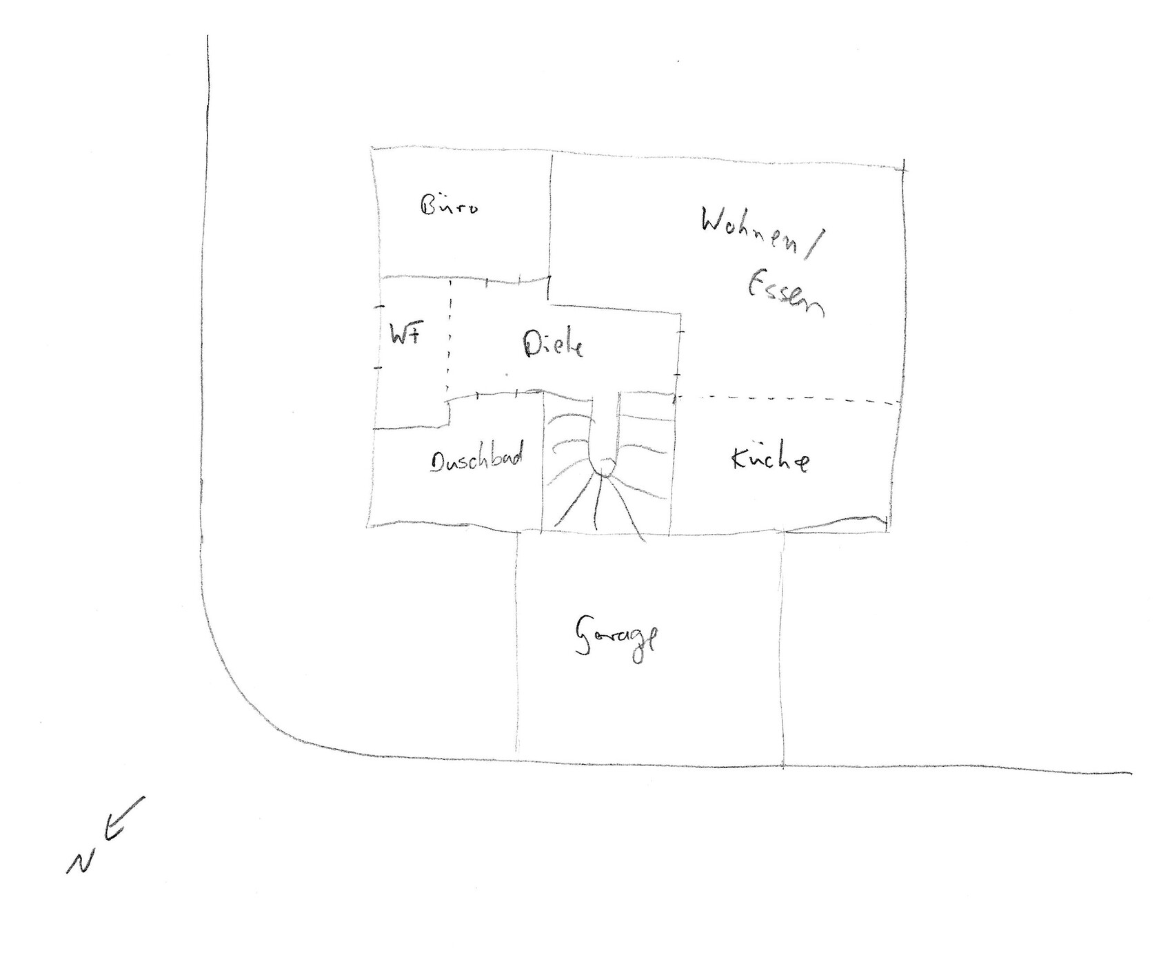

I think I will get some ideas for the upper floor; the tricky part is the ground floor because of the required office.
Attached is the sketched idea; the dashed lines are just conceptual room dividers—there should be no walls there.

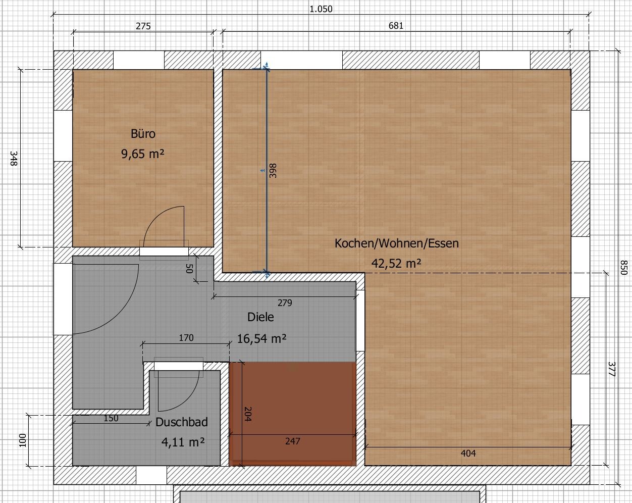

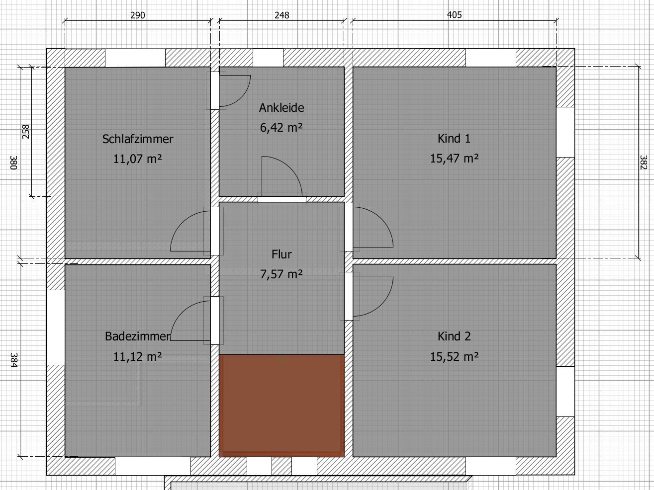

So, we have now thought about how it should look.
The floor plans are attached.
Info: Exterior walls 36.5 cm (14 inches), interior walls on the ground floor 17 cm (7 inches) except the wardrobe near the bathroom, on the upper floor the vertical walls 17 cm (7 inches), the horizontal ones 11 cm (4 inches).
I hope the dimensions are sufficient; if not, please just let me know briefly.
RobsonMKK schrieb:
Office: Family use or home office? Home office (working from home)
...with remote work, spatial separation is essential. My wife sometimes works night shifts, so it’s also necessary to be able to sleep during the day
I think I will get some ideas for the upper floor, the tricky part is the ground floor because of the required office.
...Does remote work mean a home office?
What do you mean by spatial separation? Do you have clients visiting?
Do you work only from home or a few days per month?
Can the office also be used as a guest room?
If night shifts and the related daily rhythm need to be regularly planned now and in the future, I would consider deviating from standard designs like Town & Country and think about whether it might be more practical to have the active living floor with a large open-plan kitchen, children’s rooms, and the office downstairs, and then the parents’ floor above with a living room at the front.
If the office has no client visits, it can also work very well upstairs.
Regards
The office is planned solely as my workspace for tax reasons.
There is no customer business. However, I currently work at least 18 out of 20 days from home.
The night shifts occur 3 or 4 nights per month, with only one "critical" night in total (from Saturday to Sunday) when the youngest child still doesn’t understand that Mom needs to sleep. However, the situation will be different by the time we move, and she will certainly understand. At 4 years old, she will also likely visit a friend on Sundays.
And even though the floor plan bears some resemblance to the first one, we were actually inspired by something else.
