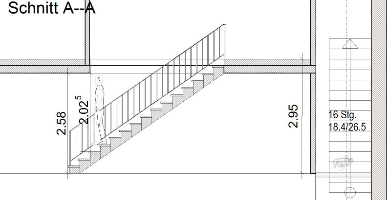

I would carefully plan the staircase, because if something doesn’t fit, it could ruin the entire floor plan.
I roughly calculated the dimensions relative to the length of the house. At about 37 degrees, the staircase will be quite steep, as it is rather short. The headroom will be very tight, just on the edge of the minimum requirement.
