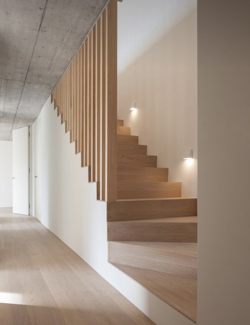

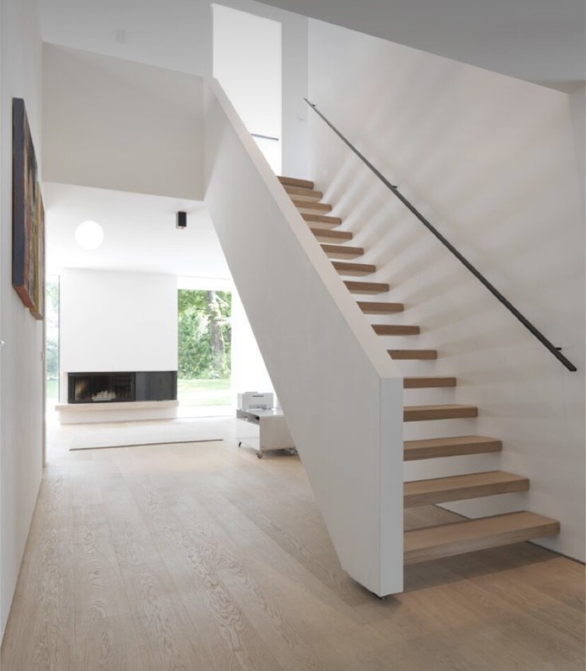

I quickly gathered some staircases (caution! from Pinterest) that appeal to us. Which of these would be like the "wedding cake"? All of them, even the second one. The third is probably the most discreet form of a design that is compatible with a general contractor.

Sorry, but my enthusiasm is turning into the opposite right now. You had a budget and a plan. Because of the budget, you had to downsize significantly but you are not willing to give up anything. As you can see, it doesn’t work that way in house building.The architect’s floor plan isn’t completely wrong regarding your wishes, but it doesn’t offer much flexibility. Too many unnecessary details obscure the focus on what’s essential and reduce your living space. Yes, you can sit on a 2m (6.5 ft) sofa, eat at a table 80cm (31.5 inches) deep, and use a bathroom without a window. But all that just for a dormer that, after three years, no one will use because it’s simply boring?
Of course, no one wants to talk anyone out of their dream home. But seeing your staircase selection again—only the finest. Honestly: I’m afraid you have to scale back your expectations, or financially this will go badly.
