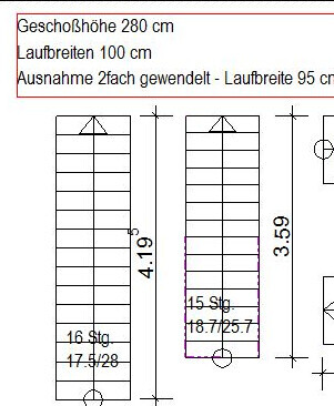

Choose a spot in the garden or elsewhere and mark out the dimensions of the entrance area of the future living room.
Include the table with chairs (in use) and the transition to the kitchen or the living area.
Then discuss the staircase with the architect regarding its length and the rise and run measurements. When I look at the section, the run in particular seems to be the critical point. The rise is indicated as 15, which corresponds to approximately 18.66 cm (7.35 inches), which is generally acceptable. Your finished ceiling height should be around 248 cm (8 ft 2 in) – is that correct? The run, with an estimated current stair length of 370 cm (12 ft 2 in), is about 26 cm (10.2 inches), which should be sufficient, but it’s worth checking whether that feels comfortable to you.
Excerpt from my stair samples:
Technical stair floor plan with dimensions, floor height, and steps
Info for everyone ... The 15 risers are always shown as only 14 counted steps because the 15th riser leads to the floor of the next level and is no longer a true step.
