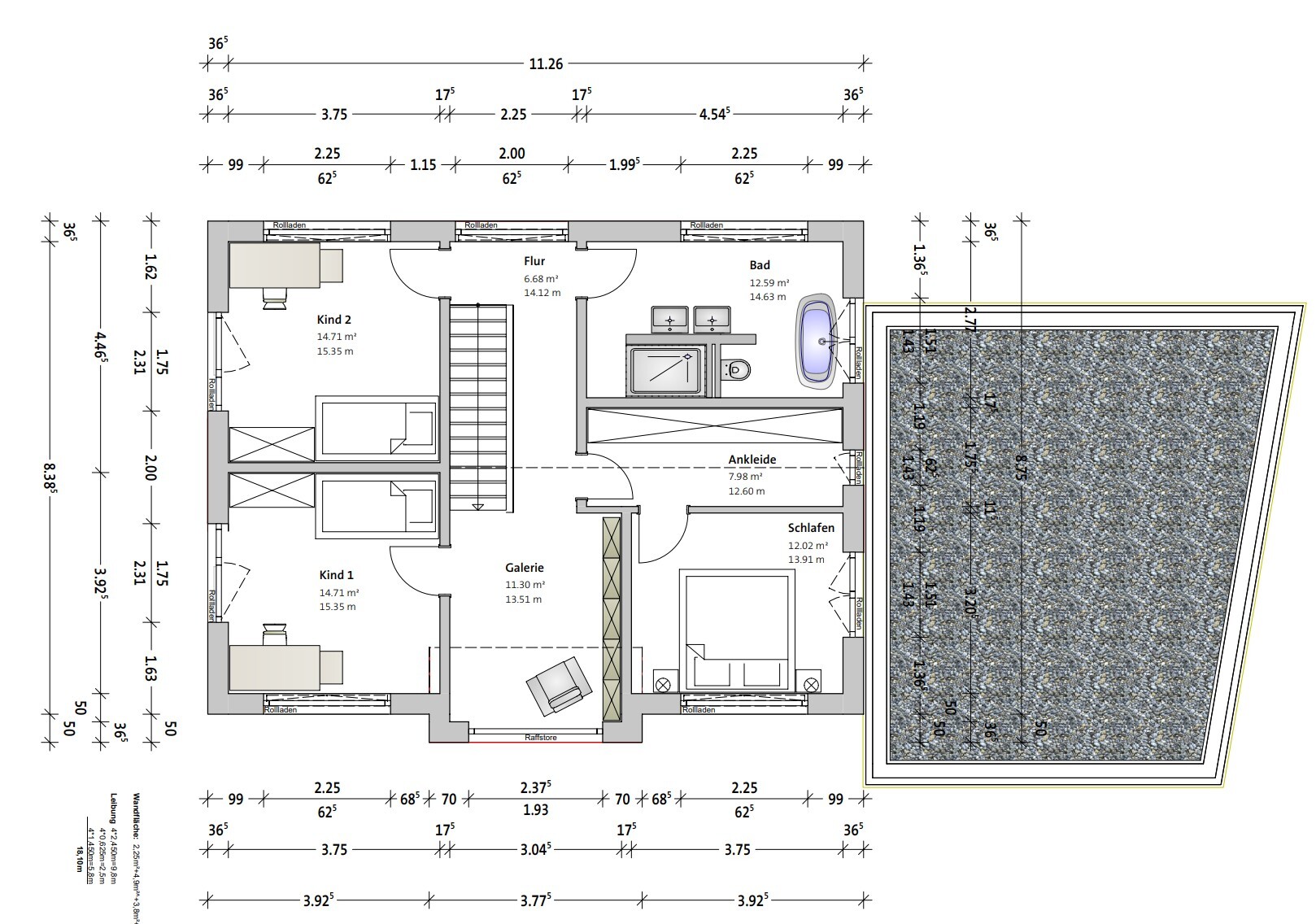

I’m venturing into this part of the forum to share our floor plan for discussion. I’m hoping for constructive feedback and ideas in case improvements would be advisable.
We want a bright house of about 160-170 sqm (1700-1830 sq ft). We would prefer an open staircase design, but it should not interfere with the floor plan. The flat roof dormer is more than just a nice-to-have... 🙂
Overall, we like the current floor plan very much, but since we are building novices, we would like to go over it with you experts to identify any possible issues. As we haven’t signed the contract with the general contractor yet, there are unfortunately no detailed dimensions available. The furnishing in the kitchen, bathroom, and living area is not yet fixed, so please don’t focus too much on those!
Orientation: the street and entrance are on the north side, terrace faces southwest.
Plot size: 854 sqm (9190 sq ft)
Slope: no
Site coverage ratio: 0.4
Floor area ratio: 0.8
Building envelope, building line and boundary: 3 m (10 ft) from plot boundary
Edge development: garage approx. 1 m (3 ft) northeast
Number of storeys: max. 2 full floors
Roof type: gable roof 30-45°, hipped roof 25-35°, shed roof, flat roof possible
Style: modern
Orientation: southwest
Maximum height/building limits: ridge height 8.50 m (28 ft)
Additional requirements: driveway max. 4 m (13 ft) wide
Client requirements
Style, roof type, building type: modern gable roof house (without eaves)
Basement, floors: no basement; 1.5 or 2 storeys; cold roof
Number of people, ages: 4 people (42, 41, 8, 5)
Room requirements on ground floor: kitchen, living, office, shower/WC, utility room; upper floor: sleeping, dressing room, 2 children’s rooms, bathroom, reading corner
Office: used for family or home office? 1 home office
Number of overnight guests per year: max 2
Open or closed architecture: open and bright
Open kitchen, kitchen island: open (but no direct view to living area), kitchen island if possible
Number of dining seats: 6 (preferably extendable to at least 8)
Fireplace: bioethanol / water vapor fireplace
Music/stereo wall: no
Balcony, roof terrace: no, but projecting bay window on upper floor
Garage, carport: garage or carport (6x9 m (20x30 ft) – position and storage room next to or behind garage not fixed yet – orientation on plot either lengthwise or widthwise)
Further wishes / special features / daily routine, also reasons for decisions:
Origin of the design: original floor plan from Gussek House “Zypressenallee,” adapted to our needs and wishes by a general contractor’s planner
What do you like most and why? We like the layout and orientation of the ground floor, with sightlines from the entrance area
What do you like least and why? Uncertainty whether the kitchen is too tight; arrangement options for living room (sofa, piano!, bioethanol fireplace?) – possibly remove the middle square window in the living area on the ground floor in favor of more space for furniture?
Price estimate from architect/planner: 600,000 EUR (including garage, additional construction costs)
Personal price limit for house including equipment: 600,000 EUR
Preferred heating system: air-to-water heat pump
If you have to give up on certain details or extras:
- Can give up: staircase, 10 sqm (110 sq ft) of living space
- Cannot give up: bay window on upper floor (I just really like this nesting box)
The desire for a bay window with reading window and open architecture was implemented, combining examples from various magazines...
see above
Slope: no
Style: modern
Client requirements
- Seating window on upper floor (bay window) – to hopefully bring plenty of light into the hallway and provide a nice view
- Open staircase (straight or with landing, no preference)
- Kitchen without direct line of sight from living area
- Office preferably with garden access
see above

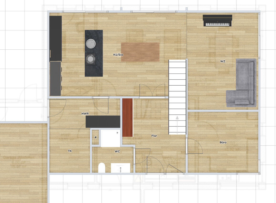

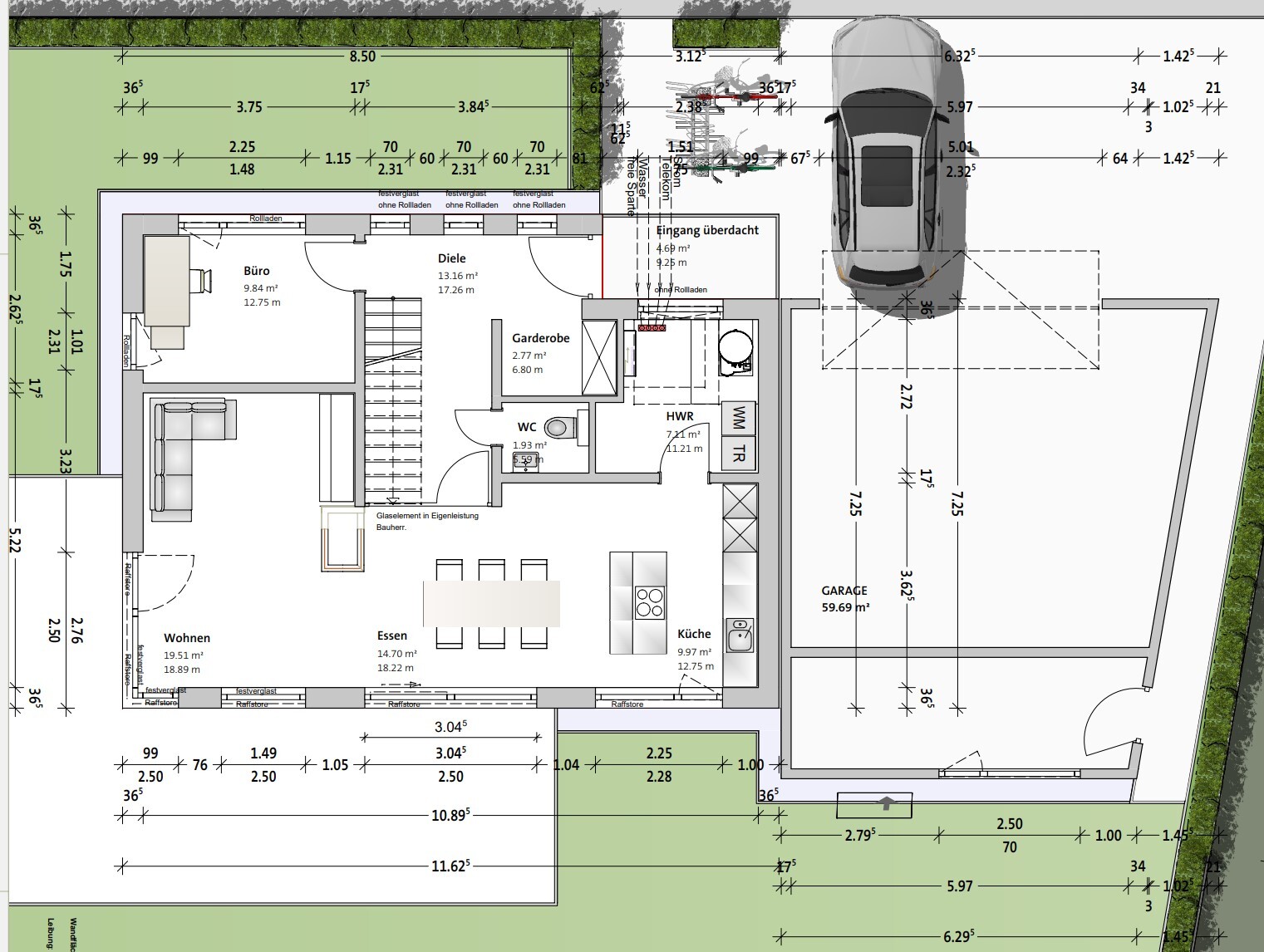

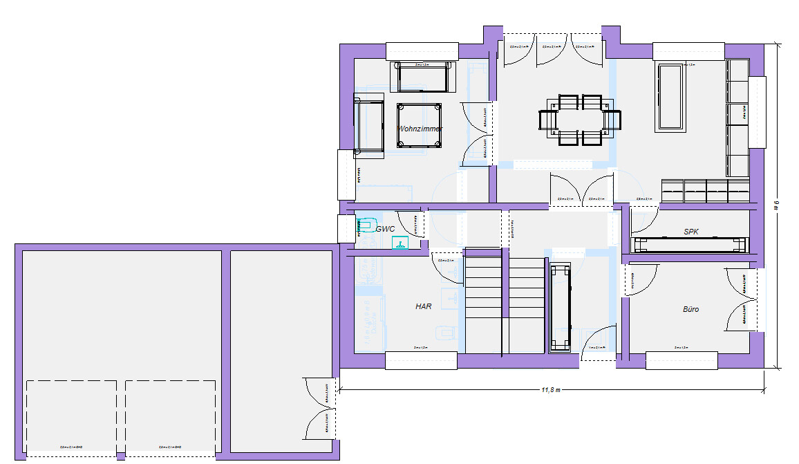

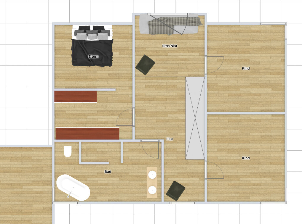

epinephrin15 Feb 2023 22:52We have now signed the construction contract and, in this context, asked whether the floor plan may be shared in a forum for discussion... 🙂
So here is the new design – due to cost reasons, the floor area was reduced from 175 to 160 square meters (1884 to 1722 square feet), which we can live with quite well.
The entrance area was positioned to the side because I prefer not to look from the dining table directly at the front door and discarded children's shoes. The utility room could be larger, but as mentioned, we had to downsize... Initially, the staircase extended into the living area, but I would like to have the option to create a partition towards the hallway. I’m curious about opinions on this change.
Costruttrice15 Feb 2023 23:11K a t j a schrieb:
So now you’re running through the kitchen with dirty laundry?That was my first thought too. Of course, you have to make compromises sometimes, but I would definitely reconsider that. Having access to the washing machine and dryer in that spot would be inconvenient for everyday use.
E
epinephrin15 Feb 2023 23:14K a t j a schrieb:
So now you’re running through the kitchen with dirty laundry? Or are you still planning the laundry chute from the bathroom?Laundry chute from the bathroom or dressing room. It actually hasn’t been included in the plans yet. You always notice everything.Similar topics
