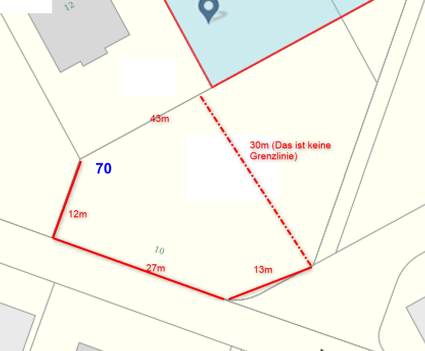

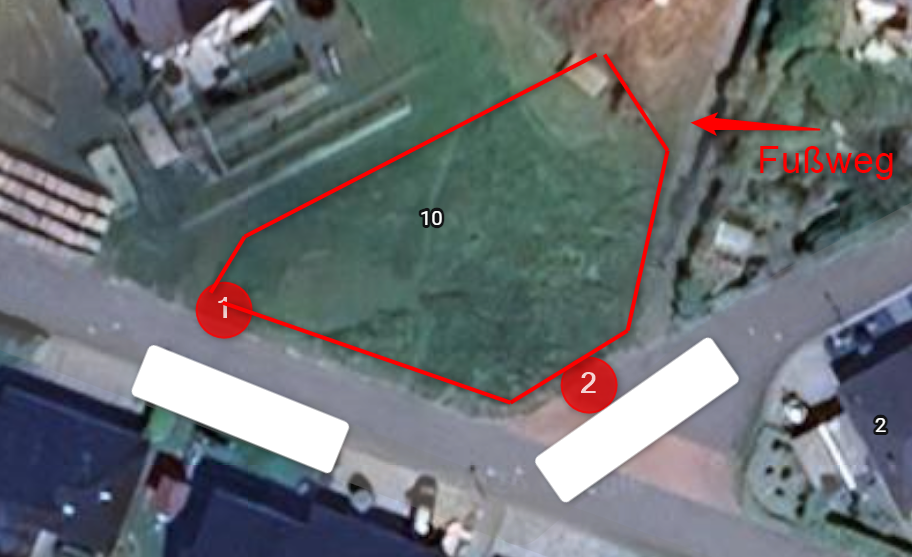

The plot looks as follows and is around 1100 sqm (12,000 sq ft):
I have marked point 1 for a driveway from the western side. Point 2 could alternatively be used for a driveway from the south-eastern side. My current draft, which assumes a driveway from the street on the west side (marked as point 1 in the graphic above), roughly looks like this:

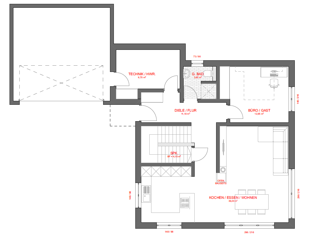

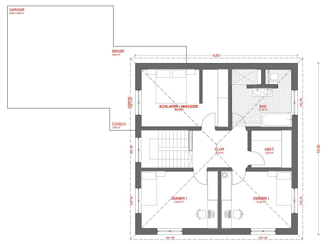

We have spoken with several companies, but most require us to provide floor plans. Therefore, the draft is based on our own ideas and is not finalized.
- Office located slightly apart on the ground floor, so guests do not “get lost” there
- Office can also be used as a bedroom (possibly for older age)
- Kitchen faces the street
- Separate dressing room available
What do you not like? Why?
- Bay window for the technical room
- The small, cramped bathroom on the ground floor
- Location of the master bedroom above the technical room – all conceivable installations run through the bedroom from the technical room

I have reviewed the post you mentioned and am happy to report that we have significantly more space available.
I just pulled the main dimensions from the floor framing system:
Please note: The dashed line is only a guideline to help estimate the total width of the building plot.
I appreciate any suggestions.

and to the architect for suggestions Alternatively: first consult the architect, then take your floor plan and equipment list to various suppliers.
A fundamental question you need to ask yourselves:
- What are the favorable sides of the plot? Which ones are less favorable?
- How important is natural light to you? Both in the living spaces and on the terrace?
An 1100 m² (11,840 sq ft) plot is quite large and therefore offers many possibilities.
Do I understand the text correctly that the floor plan is oriented to the northeast? ("Driveway from point 1" would, if a straight line, suggest the plan is oriented to the northeast if you want to drive straight into the garage.)
Considering all this, as well as the missing meter specifications:
- The living room is placed in the darkest corner of the open plan area. Some may like this; others may find it too dark.
- The utility room (HWR – Hauswirtschaftsraum) could be problematic due to the second door. It costs important space for placement and wall area. Effectively, the utility room would only be about 6 m² (65 sq ft) sized if you compare it to a "normal" utility room without this second door. Its unusual shape, together with the garage, also leads to a significant cost increase.
- The hallway on the ground floor will be completely dark; the only natural light may come from the front door. There will likely be hardly any storage space here either.
- The differently sized children’s rooms could lead to disagreements in the future.
- I am only moderately satisfied with the bathroom on the upper floor. I think some corners may end up quite dark.
- The storage room on the upper floor is good. However, I suspect it will also need to be used for the washing machine and similar appliances because the utility room is very small.
Please don’t take this as criticism; I really mean it constructively:
Overall, I find the floor plan a good starting idea to build on. However, personally, one planning detail ruins the plan for me. That is, the tail wags the dog—meaning the floor plan is so fundamentally subordinated to the car (and the second door through the garage). Given the house dimensions, the ground floor (especially the hallway area and the utility room) could be designed more beautifully and functionally if the garage did not play such a central role.
On the plot, a garage by the street (which would not be the case here), or on the east or north side (depending on the property), would also be better located than in the west area, where you tend to have more sun in the afternoon.
