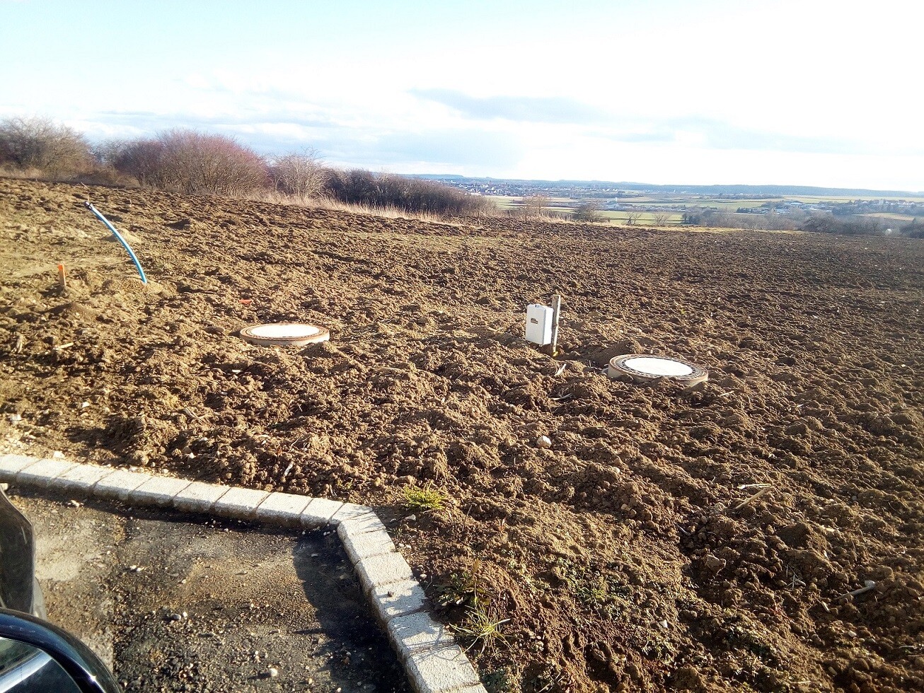

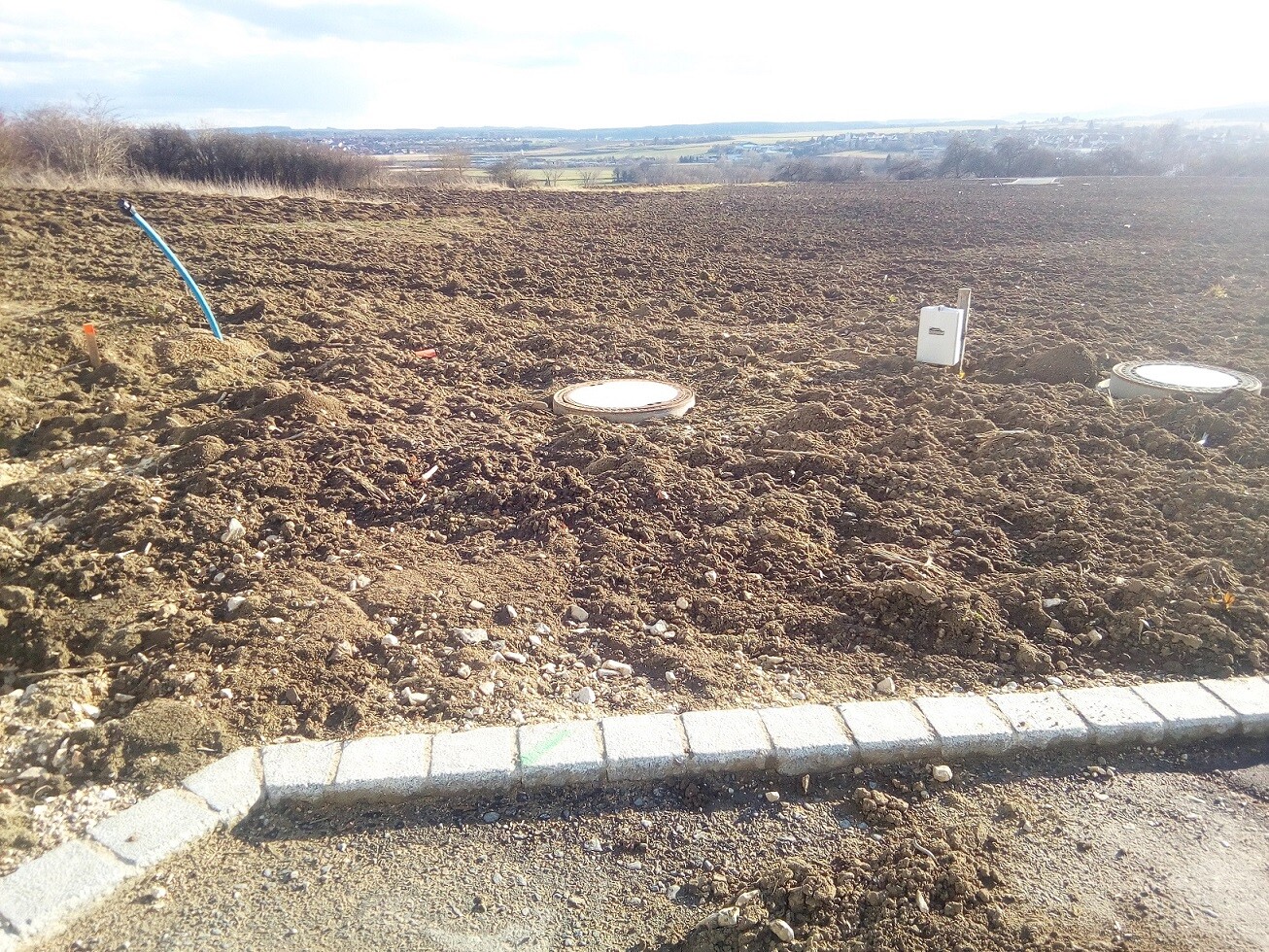

Plot size: 625m² (6729 sq ft)
Slope: approx. 2m (6.5 ft) over the length

Orientation: southeast
Maximum height / limits: with roof pitch 0 – 27° (0 – 27°): eave height max. 6.0m (20 ft), ridge height max. 8.5m (28 ft)
No neighbor to the south! Nature reserve

Since the road doesn’t even reach the site here, just creating access will probably cost a significant amount. A double garage is not cheap either.

I see the slope as a problem for your ideas: a terrace on the south with a slope there won’t work. Embankments are expensive (I repeat what others said).
However, I can imagine two levels on the plot, one being a basement level with a terrace in the southwest. Above it, the sleeping area as the entrance level. From the driveway, it would look like a bungalow. Instead of a double garage, a single garage with a carport connecting to the house or a double carport.
Edit: I might be wrong about the slope, then it would be a normal two-story house with some fill for the terrace.

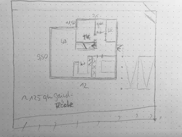

A rough sketch... I’m looking at a ground floor area of about 125 m² (1350 sq ft)... with a slightly smaller rectangular shape upstairs. This gives us a living area of around 200 m² (2150 sq ft). No basement, but a pantry on the ground floor and a utility room on the upper floor. 2000€ x 200 m² (2150 sq ft)
400,000€ or 360,000–420,000€
plus additional construction costs
plus landscaping
plus garage/carport
plus painting and flooring
The sketch
The upper floor matches roughly as well: 2 children’s bedrooms, a master bedroom with walk-in closet, utility room, and bathroom.
So I assume you have deliberately received some examples that you did not like because they do not want to take the project.

But backing out to the junction is also inconvenient :-(
I still see the planner having to figure out how to make the garage / driveway situation work for both cars.Please take a look at the attachment... access is not a problem.
Yes, I’d like to know what rooms you want to fit in on the upper floor besides the standard 2 children's rooms... The space plan comes first... What you imagine for your basement-equipped city villa isn’t actually what you want.
Write up a room program for basement, ground floor, and upper floor and develop your house according to that.
Regarding costs: Raising the ground level also means retaining walls... allowed? Desired?
Maybe two stories are enough... you could end up with 180-200 square meters (sqm) (1,940-2,150 sq ft)I can gladly summarize in the next post (for clarity) what we want on each floor.

I believe the architect didn’t place the technical areas without good reason, because in the end the house will run out of budget.
You want two full stories, an (unfinished, possibly prepared) attic, a basement, all on about 100 square meters (sqm) (1,075 sq ft) footprint (160 sqm + 80 sqm basement / 1,725 + 860 sq ft), a (solid?) double garage, and your budget is 350,000 EUR? I’m not convinced, especially if that also includes additional construction costs. (350,000 - 50,000 = 300,000 => 1,250 EUR/sqm) … no way… especially not in Baden-Württemberg.
I want to predict:
a) the basement will be dropped.
b) The garage will be a precast concrete garage or a carport.
Keep in mind a house without a basement really needs extra storage space!!! Garage +1 meter (3 feet) and utility room not less than 10 or 12 sqm (107-130 sq ft). Attic accessible by space-saving staircase (not a folding ladder!) and within the insulated envelope!!!
If any money surfaces somewhere... see the attachment. (Warning, staircase moved, so the upper floor plan is dead! Anyway, everything only makes sense as a whole. A ground floor without an upper floor isn’t a ground floor.
No attic... You won’t go up there later anyway. That’s why the roof pitch will be around 25° (degrees).

@tox your “drawn” floor plan looks quite similar to ours, only we made the guest room an additional cloakroom.

Regarding the slope, I attached two photos for you – the 2-meter (6.5 feet) difference between single-family houses refers to one property compared to the other... Our neighbor seems to have most of that 2 meters.
So it’s not as extreme on our property. But a slab foundation still costs about €25,000 (about $27,000),... without much benefit.
