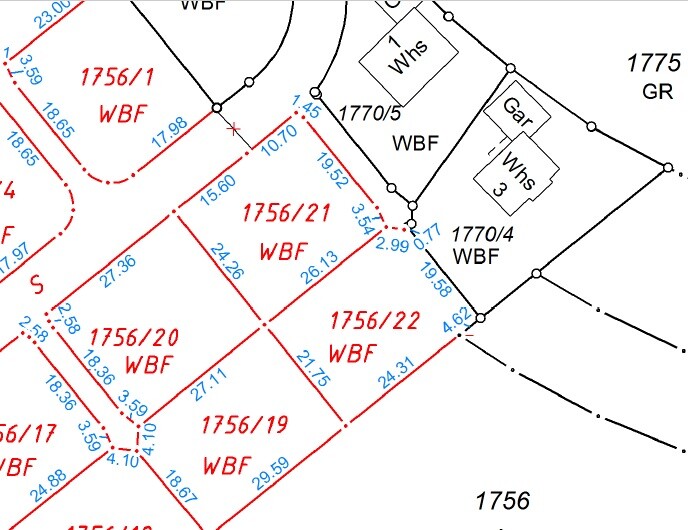

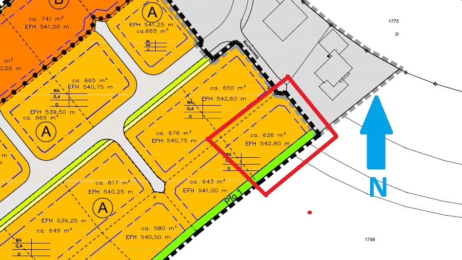

Plot size: 625m² (6729 sq ft)
Slope: approx. 2m (6.5 ft) over the length
Site coverage ratio: 0.4
Floor area ratio: none specified
Building setback lines: 3m (10 ft) from neighboring properties
Edge building: with utility building (garage)
Number of storeys: none specified
Roof style: none specified
Architectural style: none specified
Orientation: southeast
Maximum height / limits: with roof pitch 0 – 27° (0 – 27°): eave height max. 6.0m (20 ft), ridge height max. 8.5m (28 ft)
No neighbor to the south! Nature reserve

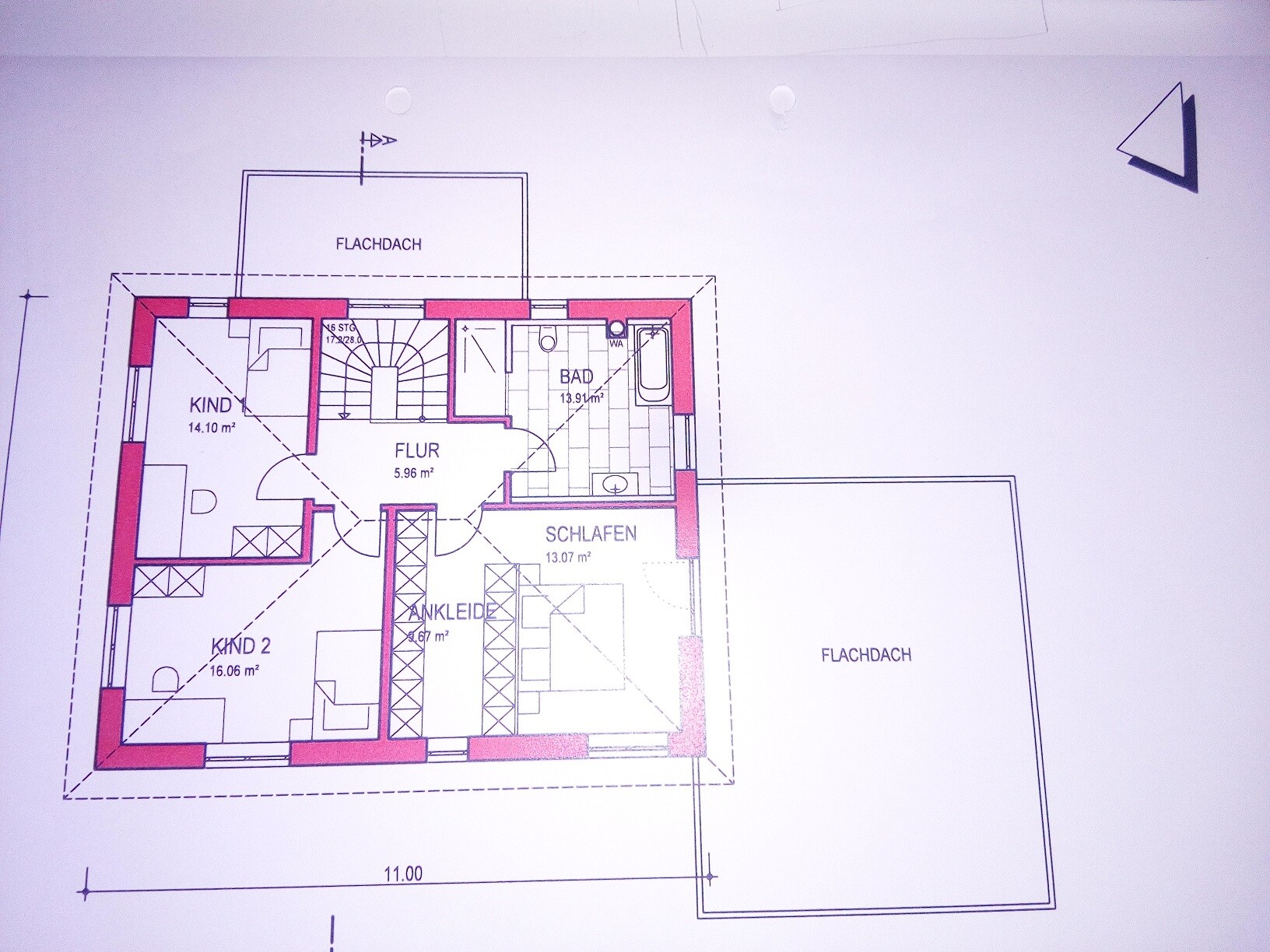

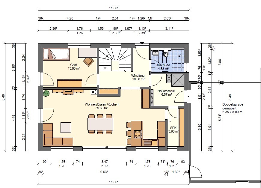

About the floor plans:

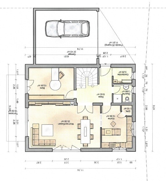

Ground floor from architect: laundry room upstairs despite info about basement; kitchen in wrong place according to orientation; cloakroom forgotten.

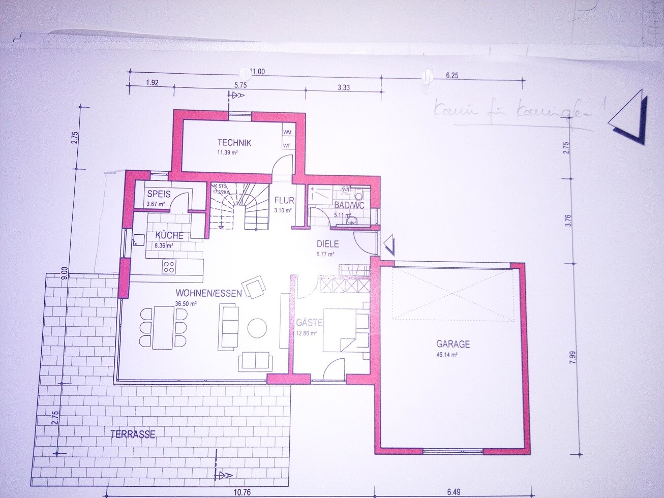

Ground floor version 1 by developer: all requirements forgotten, tiny front door, tiny hallway, utility room, looks uninspired (this is the second draft!)
Ground floor version 2 by developer: garage (in my opinion) on wrong side, bad sun orientation, also looks bleak...
I believe the kitchen should be on the sunny side in the middle of the house and the living/dining area to the left, like an L layout... This way you would fully benefit from the sun, right? With a large window wall on the northern corner of the house then...

That means approximately 90 sqm (970 sq ft) on the ground floor (spacious, bedroom, shower bathroom, and the usual...), which means 180 sqm (1,940 sq ft) plus basement. Are you aware of that?Wow...... I’m totally stunned :-/
Yes, I would like to know what rooms you plan to include on the upper floor besides the standard 2 children’s bedrooms... The layout program comes first... What you imagine with your basement-equipped city villa is not really what you want.
Write a room layout program for the basement, ground floor, and upper floor, and develop your house accordingly.
Regarding the costs: raising the ground level also means retaining... Is that allowed? Desired?
Maybe two floors are enough... you could get 180–200 square meters (1,940–2,150 square feet).

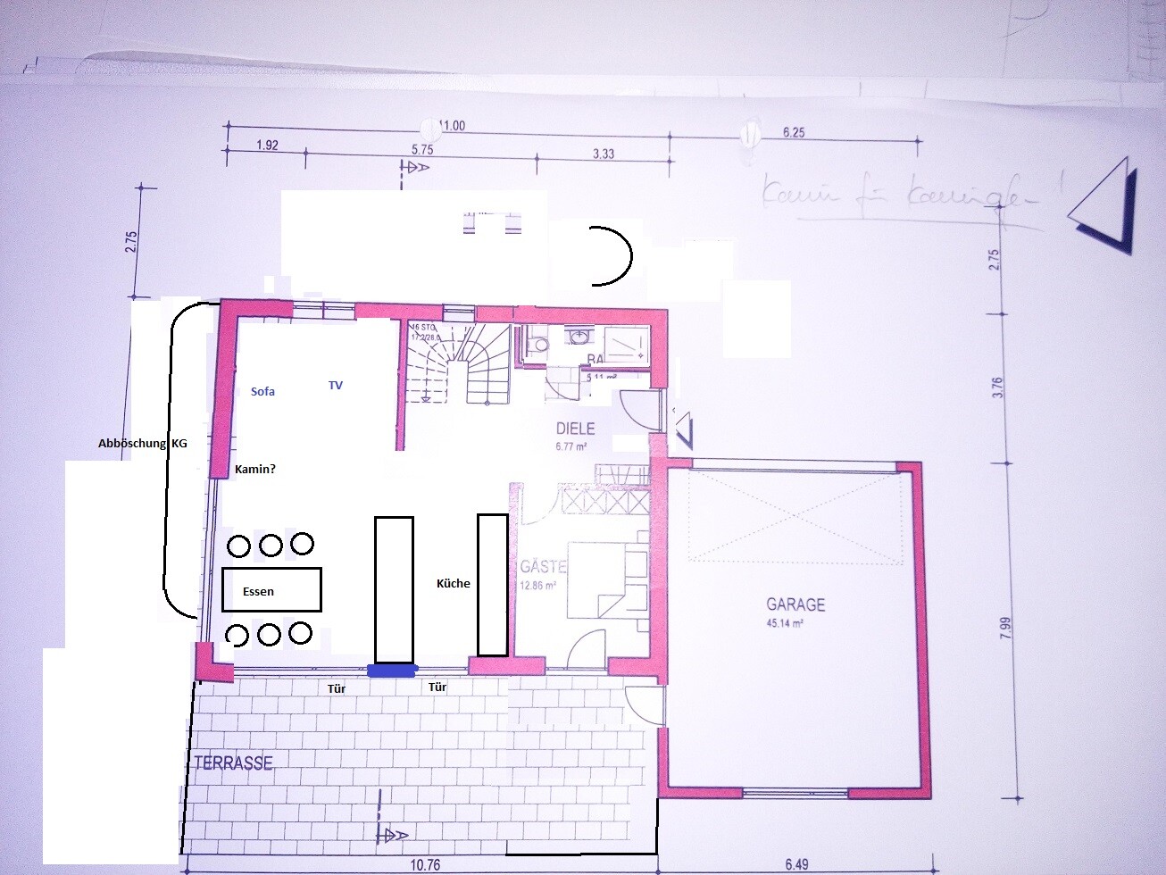

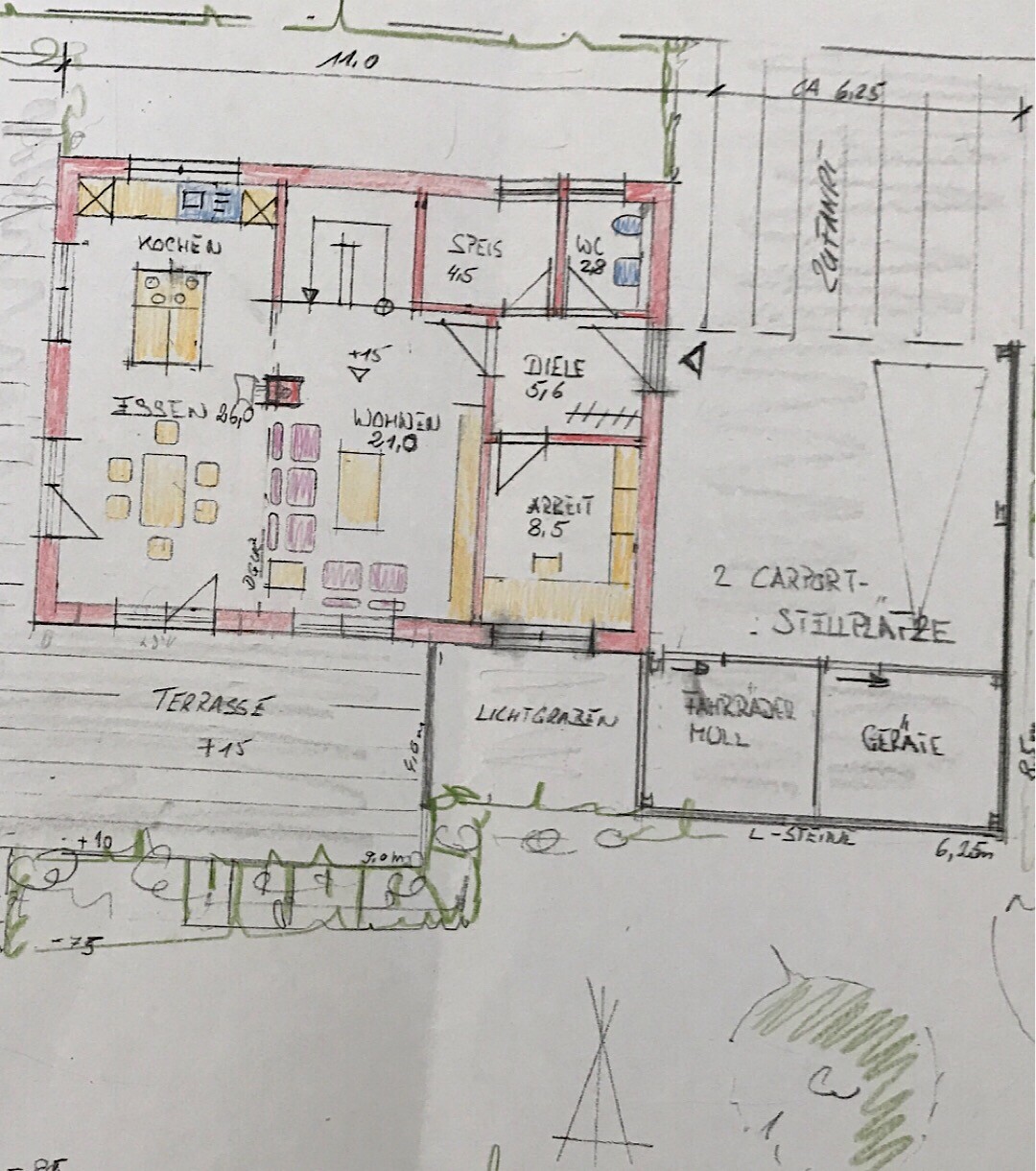

toxicmolotof15 Mar 2018 23:51Preliminary note: If I had to choose, I also prefer the architect's design.
I believe the architect did not place the technical installations without good reason, because you might run out of budget for the house in the end.
You want 2 full floors, an (unconverted, possibly prepared) attic, a basement, all on about 100 sqm (1076 sq ft) of floor area (160 sqm (1722 sq ft) + 80 sqm (861 sq ft) basement), a (solid?) double garage, and your budget is 350,000 EUR? I’m not quite convinced, especially if incidental construction costs are included in that budget. (350,000 – 50,000 = 300,000 => 1250 EUR/sqm (116 USD/sq ft)) ... no chance ... especially not in Baden-Württemberg.
My prediction:
a) The basement will be cut.
b) The garage will be a precast concrete garage or a carport.
Keep in mind that a house without a basement especially requires additional storage space! Garage + 1 meter (3 feet) and the utility room should not be less than 10 or 12 sqm (108 or 129 sq ft). The attic must be accessible by a space-saving staircase (not a folding ladder!) and be within the insulated building envelope!
If any money is left somewhere... see attachment. (Warning, staircase shifted, which ruins the upper floor plan! It only makes sense as a whole. A ground floor without an upper floor is not a ground floor.)

The
@tox your "drawn" floor plan looks quite similar to ours, except we turned the guest room into an additional wardrobe.
Regarding the budget, I also see the basement being cut.
