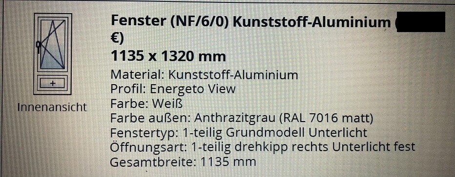

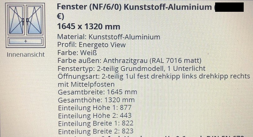

We have a semi-detached house from 1921 with good insulation and fairly new windows from 2017, which we also bought in 2017. Unfortunately, it currently has no external shading. Our house stays cool for a long time, but the longer a heatwave lasts, the more it heats up. When temperatures stay above 30°C (86°F) for several days, even the best insulation can’t prevent the heat build-up. The living room and one child’s bedroom face east, so the sun beats down relentlessly on them until around 1 to 2 p.m., and for the rooms facing west, the sun arrives around that time as well. We now want to retrofit external shading as protection against heat. Below you’ll find the types of windows we have. The lower transom windows cannot be opened. There is no electrical wiring in the window reveals.
Based on my current research, the only really practical solution here seems to be an external roller shutter. Electric operation would likely be too much effort to retrofit; manual operation would mean drilling into four-year-old windows (thermal bridge?). They are PVC-aluminum windows, and we did not cut any corners there. Then there are various types of clip-on blinds, but those are ruled out because of the lower transoms and usability, right?
Our main priority is really effective protection against heat. We could also consider external blinds (such as Venetian blinds) if the operation works well. Since we all like to sleep in complete darkness, very good blackout capability would be a bonus, although our internal roller blinds already do quite well in that regard. We are the type who like to ventilate early in the morning and then keep everything tightly closed until evening during hot periods, because we just can’t take the heat otherwise—we are definitely not sun-lovers. The external window reveals have a depth of 22.5cm (9 inches), so there is quite a bit of space there for solutions recessed into the niche.
I wanted to tap into your collective experience here. Sometimes you can’t see the forest for the trees or imagine problems where none exist.
Attached are the types of windows we have.
