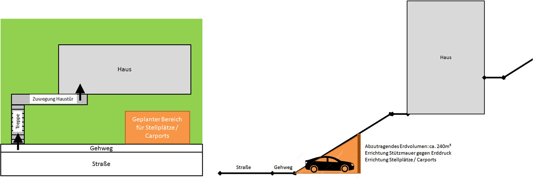

our family owns a house on a hillside. We are currently considering adding extra parking spaces / carports (e.g., 2-3 parking spots plus a bike shed) on the property for personal use and guests. The planned area would be located directly along the property line facing the street, allowing direct access from the street to the parking spaces / carports. Due to the hillside location, a significant amount of soil would need to be excavated (initial rough estimate about 240 m³ (310 cubic yards)) and a retaining wall would have to be built to resist earth pressure. I roughly sketched the idea in the attached images (not to scale). According to the soil report from the original house construction, aside from a thin top layer of topsoil, only layers of claystone (decomposed/weathered) and sandstone should be expected (no rock or similar).
Grundriss: Haus auf grünem Grundstück, Zuwegung, Treppe, geplanter Carport/Stellplätze.
We are first looking for a rough cost estimate, especially concerning the earthworks and retaining wall construction—that is, the cost of creating the parking spaces alone (without carports). In this context, I am curious if anyone has done something similar and could share some initial experiences. Experienced users might also share their gut feeling, as I really have no sense of the potential size of the project. Many thanks in advance for any input!

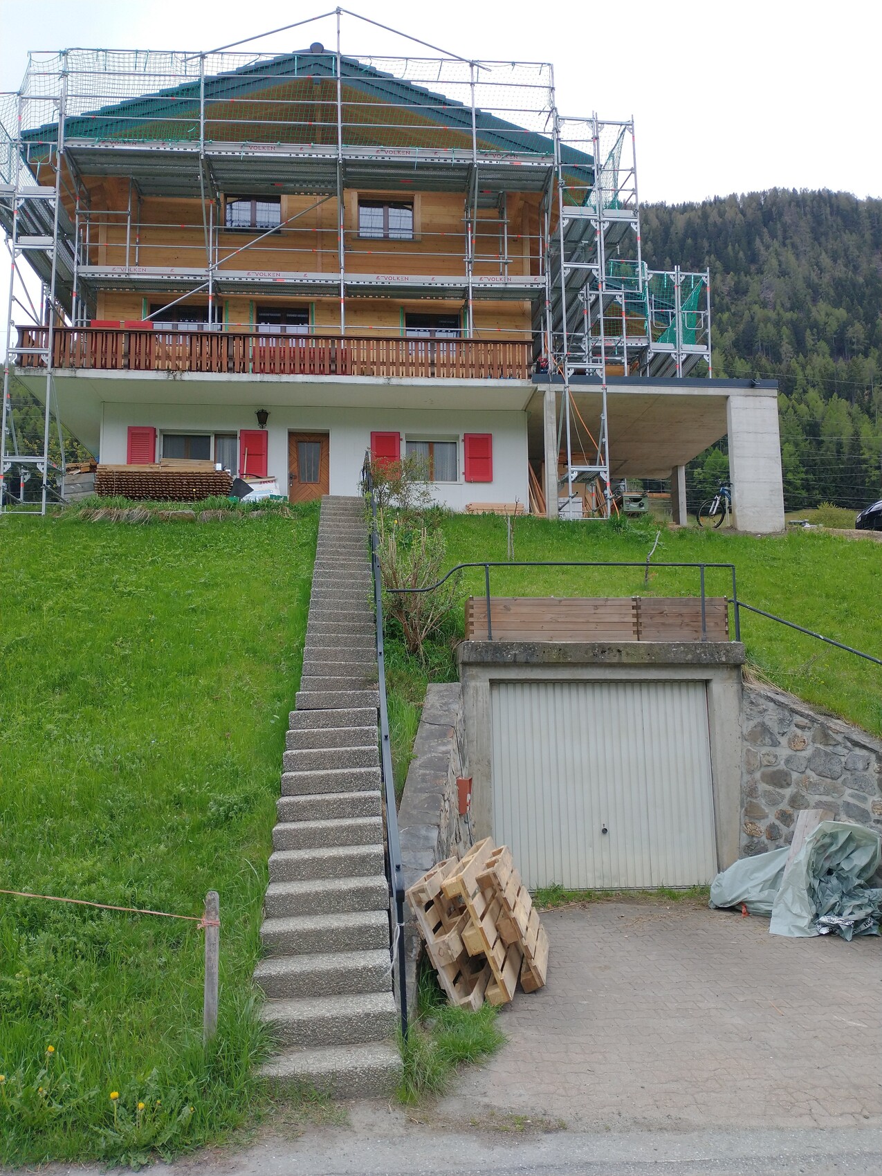

How much space do you have between the parking area and the house, and what is the height difference we're talking about? The issue isn’t just that the finished structure has to be stable; you also need to be able to secure it during the construction phase. This makes me wonder whether the slope can actually be graded. Usually, a retaining wall leans into the slope, which means you’ll need about one meter (3 feet) more space than you might expect.
Your sketch reminded me of a snapshot from a vacation:
Multi-story house with scaffolding, green lawn in front, stairs leading to the entrance, garage below.

How much space do you have from the parking space to the house, and what height difference are we talking about? The problem is not only that the finished structure must hold, you also have to be able to secure it during construction. This raises the question of whether it can even be terraced. Retaining walls are usually inclined towards the slope, so you’ll likely need about a meter (3 ft) more space than you might expect.
The space in front of the parking space is probably about 1.5–2m (5–6.5 ft) – I hope that’s enough for terracing. The slope itself actually looks quite similar to the photo. The height difference between the street level and the first house entrance is about 5m (16 ft) over a length of roughly 8m (26 ft), which means the slope angle is around 32 degrees.
